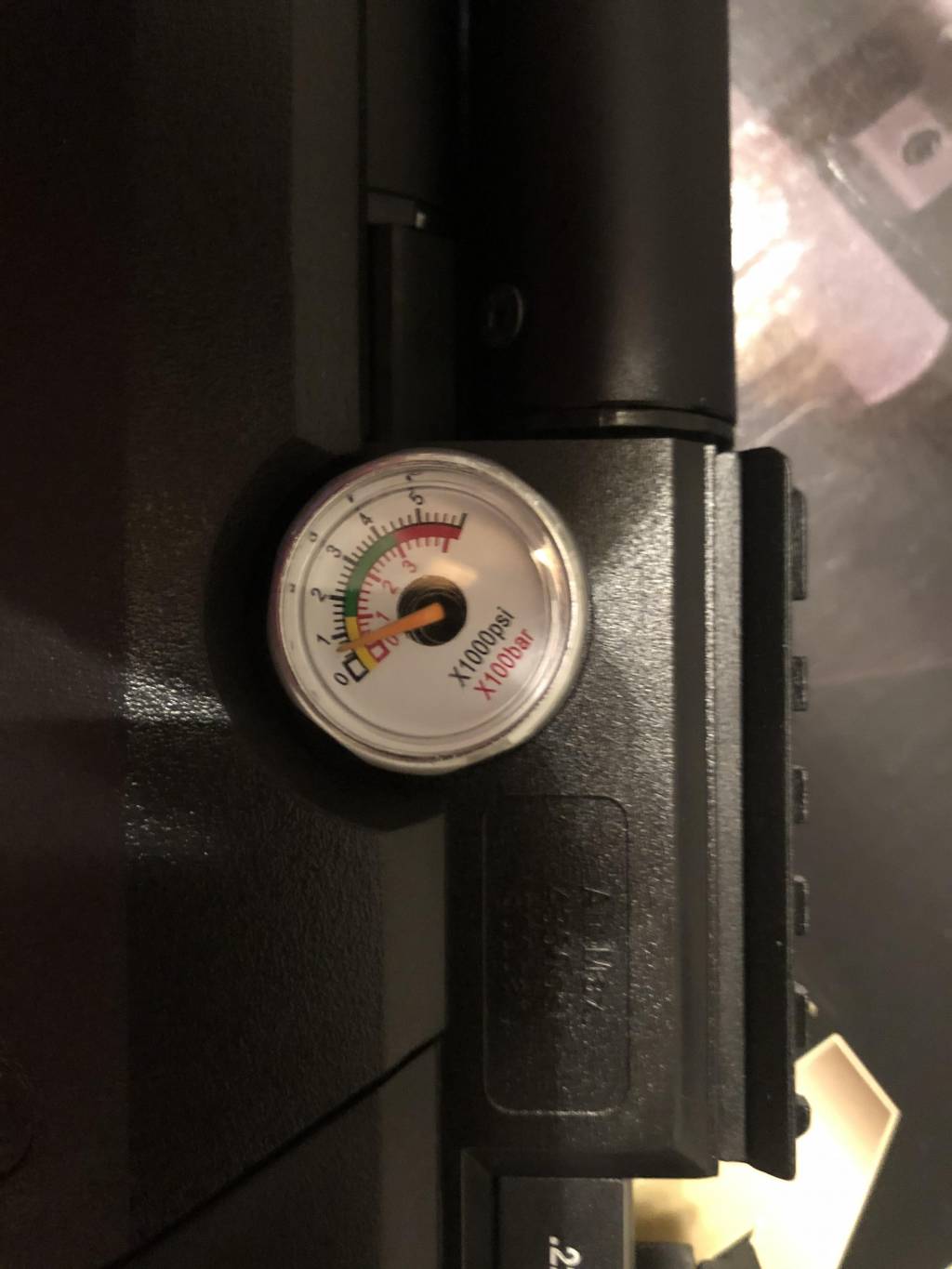

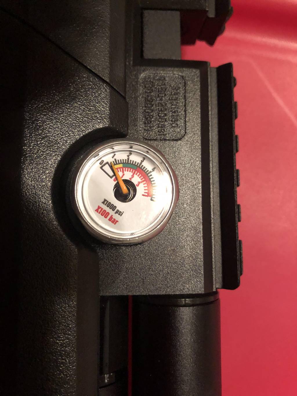

My Avenger arrived yesterday evening as well. It had very little air in it. I bled the air out to set the reg and it only hissed a short period without much force. Not sure if it was drained prior to shipping. I pumped it up to 3000PSI yesterday evening and it looks good so far this morning, going on 15 hours. I cleaned the barrel and it was extremely filthy.
My leak test has been holding for 15 hours now with no loss...I'll give it awhile longer. PA is checking for paperwork and will get back.

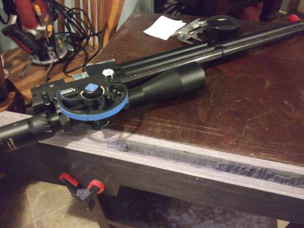

I just put a pound of duct seal in the butt stock of mine (didn't even take it out of the plastic, just jammed it in there). Feels like it counteracts the scope weight better, haven't shot it with the weight added yet.
