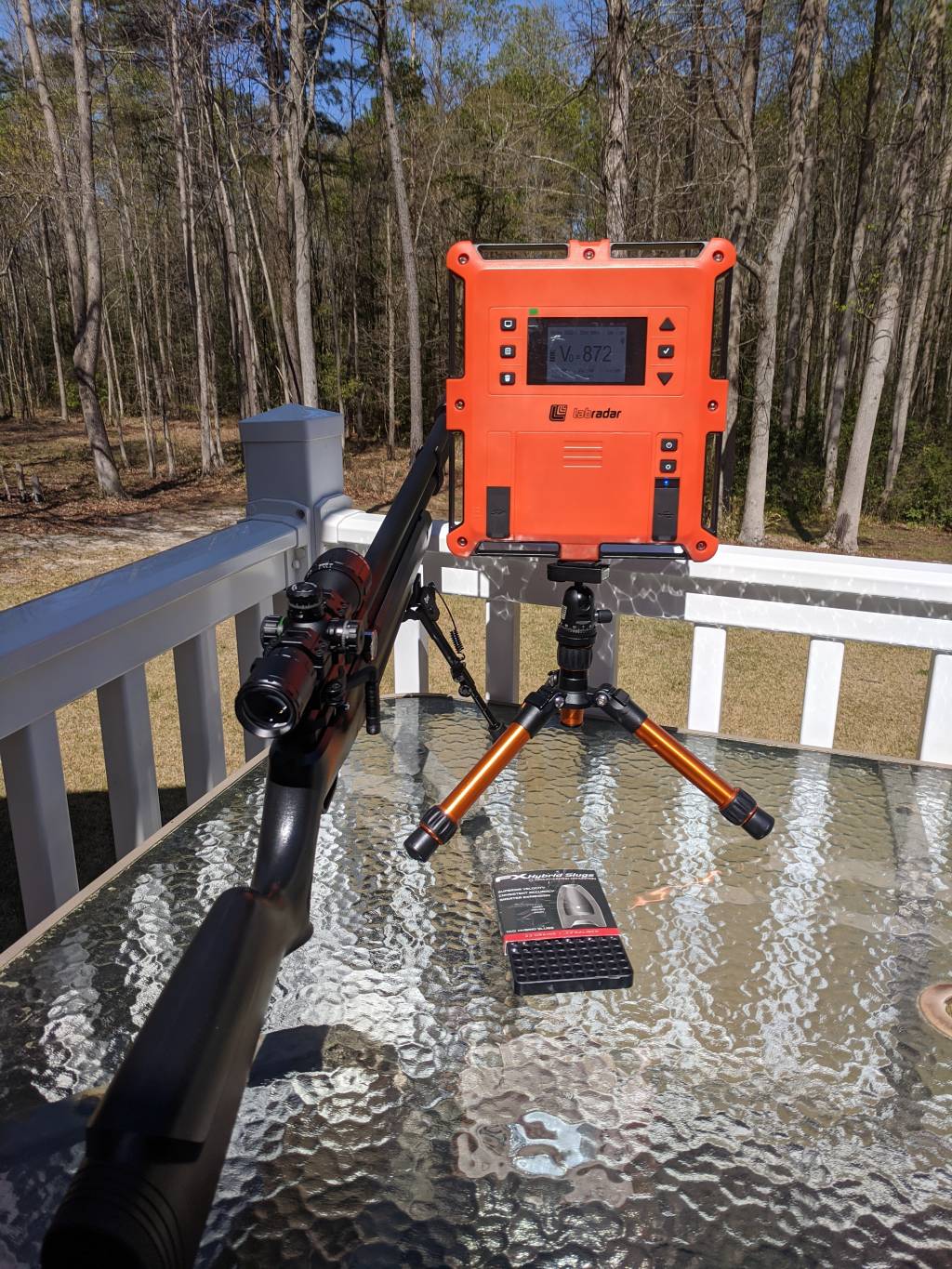

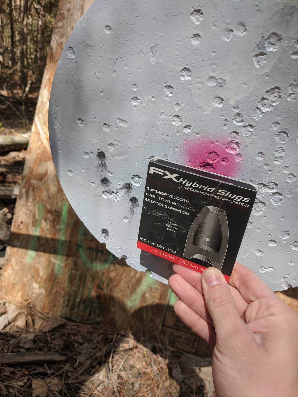

Hi,
Here is what me and my Avenger can do at 110 yards with a 22 grain FX Hybrid slug. Reg was set to 2700psi, hammer spring was all the way in. Wind was right - to - left at about 5mph. Point of aim is the center pink dot on the gong. UTG Bugbuster 3-9x, Black Arts Design Barrel Band, donnyFL extender and Sumo. The Avenger is really quite bucky at this tune and feels a little unsettled.

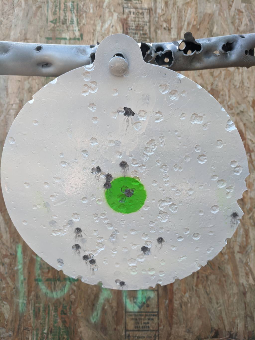

Alright I did slightly better this time around. I left the regulator setting alone, but reduced the hammer spring by two full turns. This was giving 817 - 825 FPS and the rifle was less buzzy. My zero is at 50 yards, and the lower batch of shots are holding over three dots, and the group in the center of the plate is holding over four dots. The other hits on the plate are from me trying to figure out windage.
