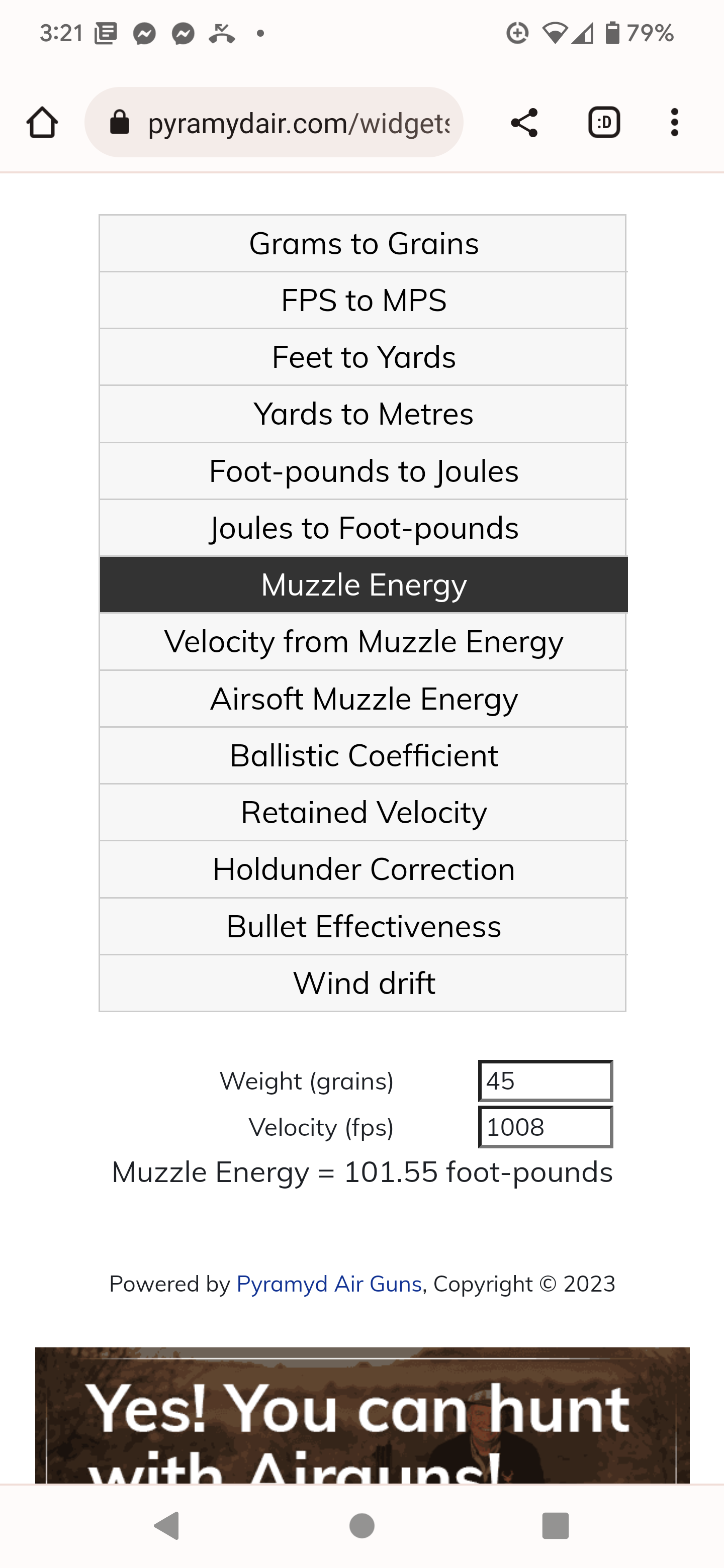

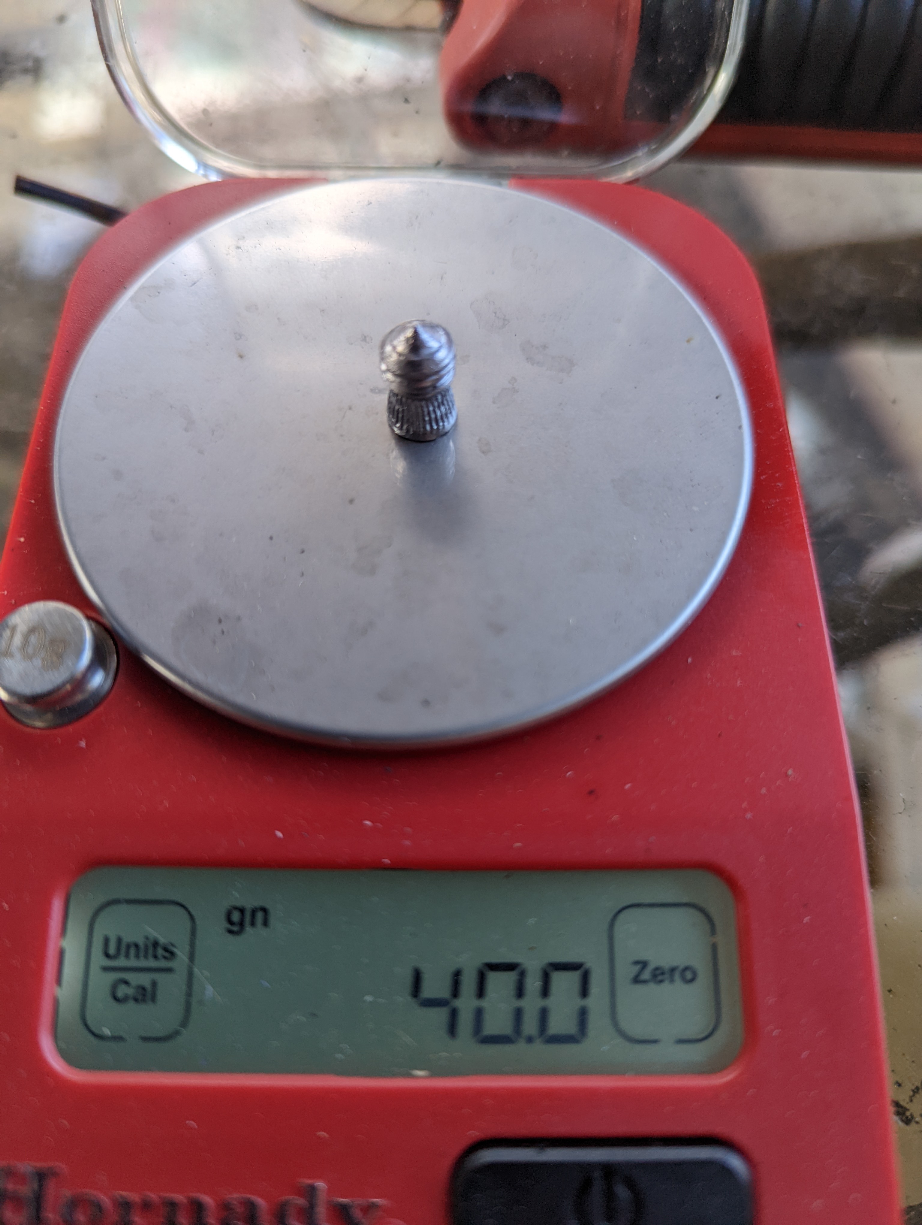

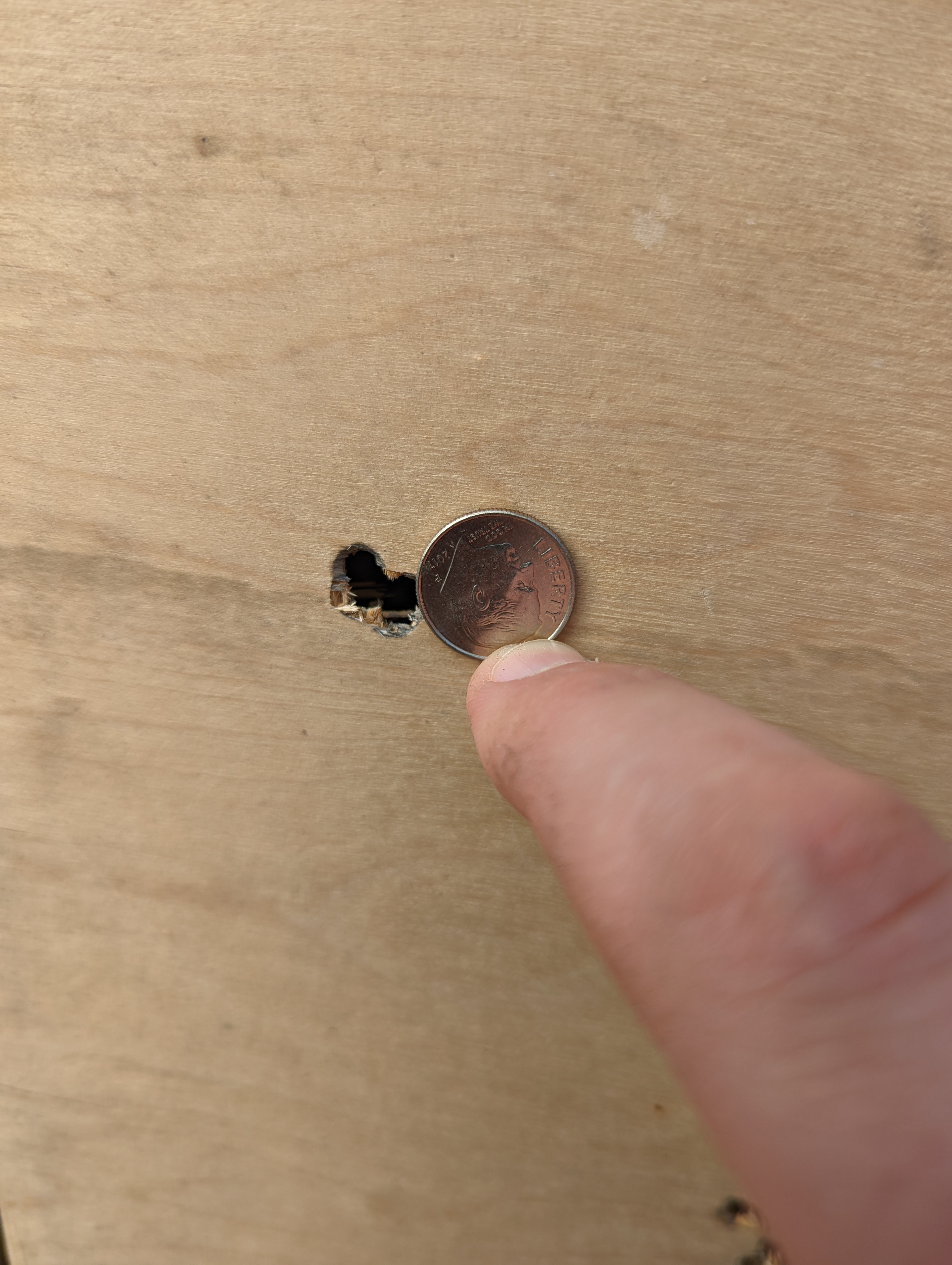

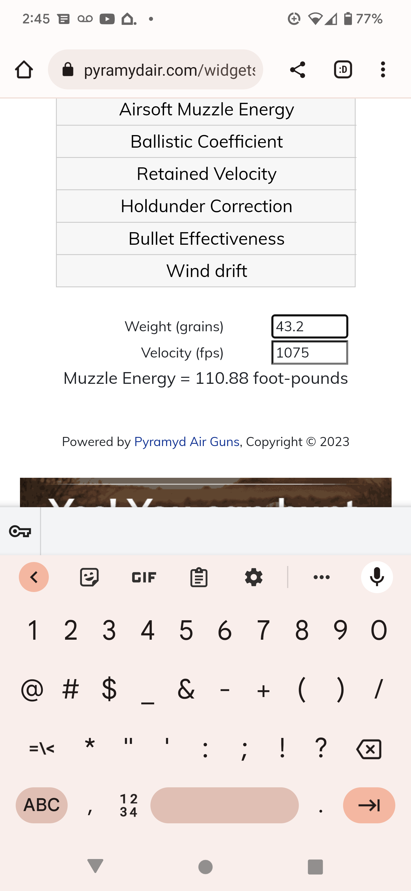

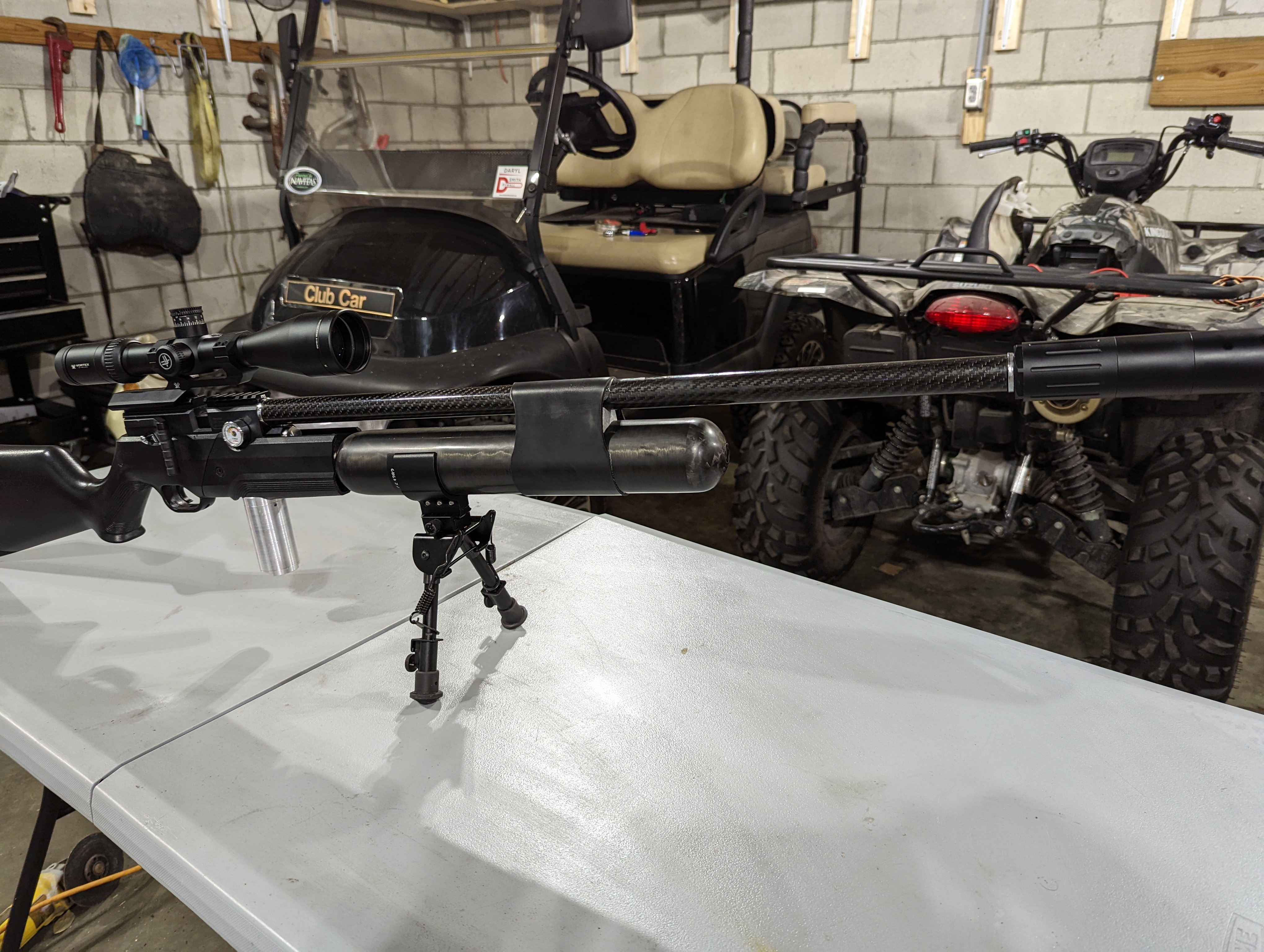

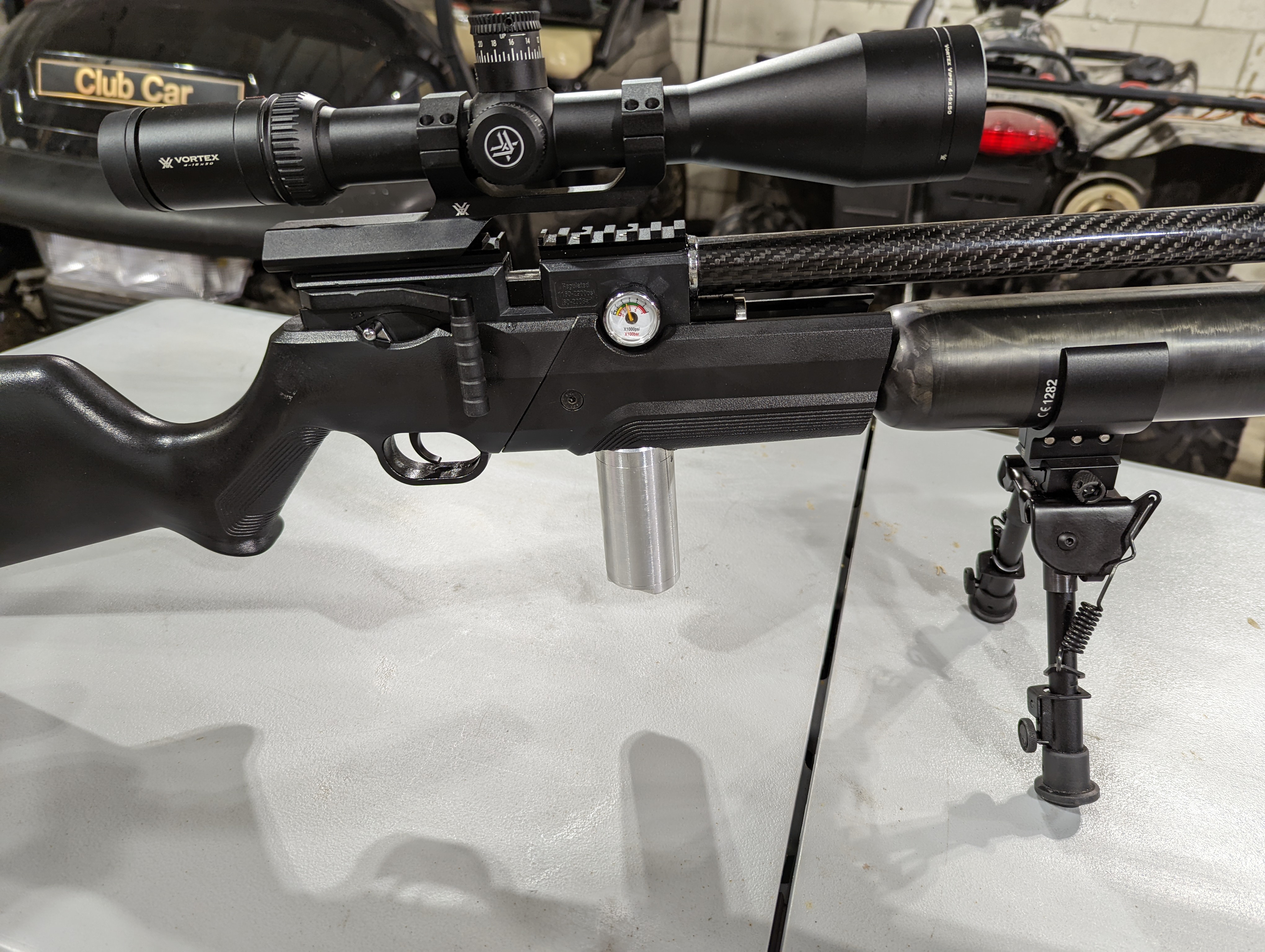

So I'm messing with my gun, measuring differing speeds with slugs with my new found power and I decided to sling a few pellets downrange. The Seneca 43.2 grain pellets always created my best energy numbers since the was new out the box... And maybe for good reason. So I shot some and realized I have reached 110 foot pounds of energy which is insane from this gun. This brought some doubt into my mind so I decided to weight these pellets and none were much more than 40 grains it seemed so they are way overstating their product! Turns out I did however reach 102 FPE which is still crazy as I believe the gun has maybe 10 FPE left in it with a soon to come tweak. Attached are the pics of the calculations as well as a 5 shot group I shot at 33 yards with NSA 38.9 grain slugs (which measure exactly 38.9). These were running about 1020 fps on average so about 90 FPE.

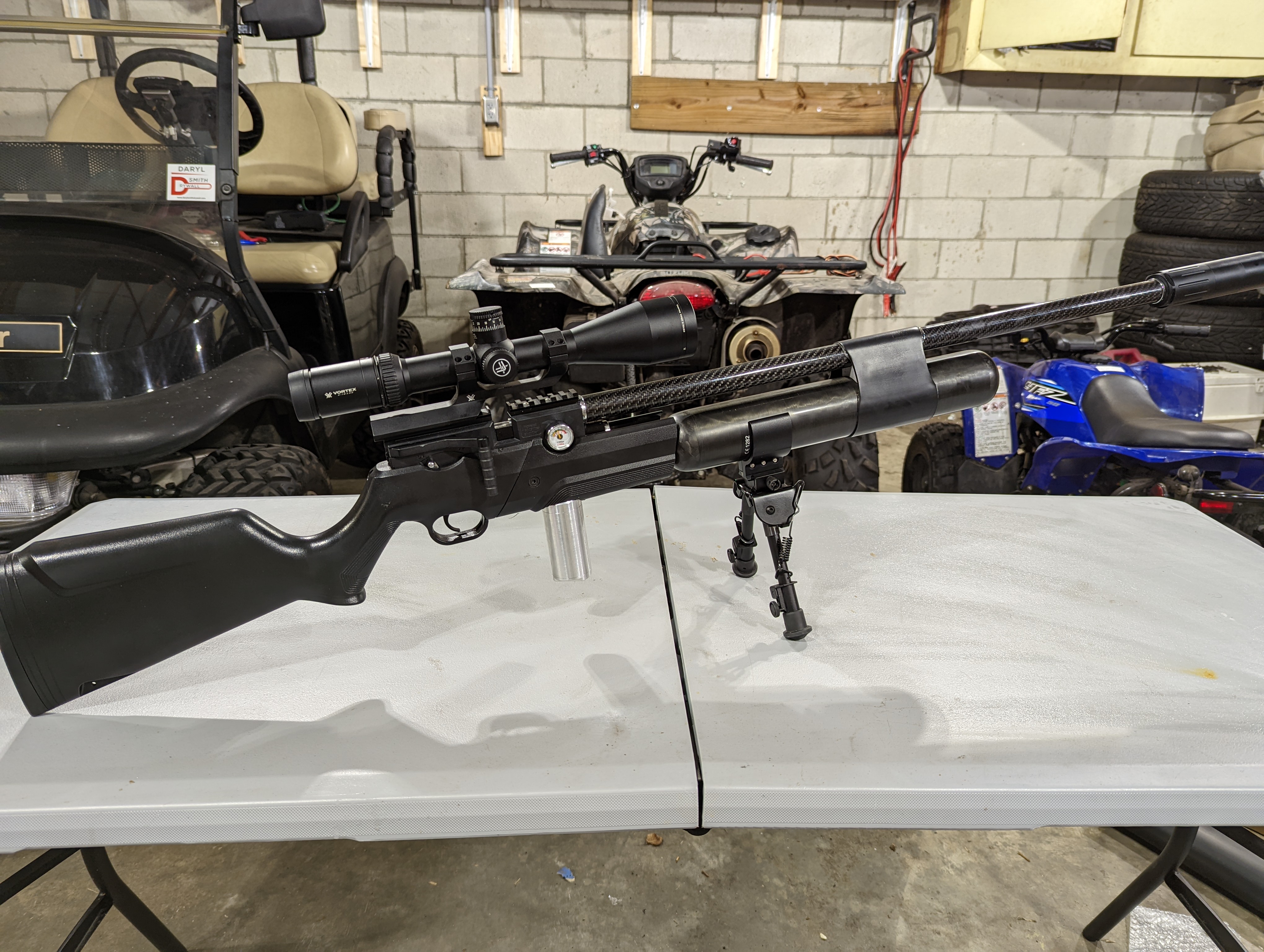

Seems off Ive down some work on a friend's M3 and had 43 gr NSA slugs doing 1022 with a 800 mm but had change hammer weights and port the non power block turned it down to 970 not to beat the crap out of the gun
Yeah I have a custom 50cc plenum extension so about 60cc total. I have extensively ported the transfer port by hand with super small rotary cutters, custom 28" barrel with enlarged barrel port, added tungsten inserts into the hammer, put in a stronger hammer spring, installed 8mm poppet so I could drill out valve throat to 7mm, and installed lighter poppet return spring. I run the run at max pressure (2900 psi) as well.
