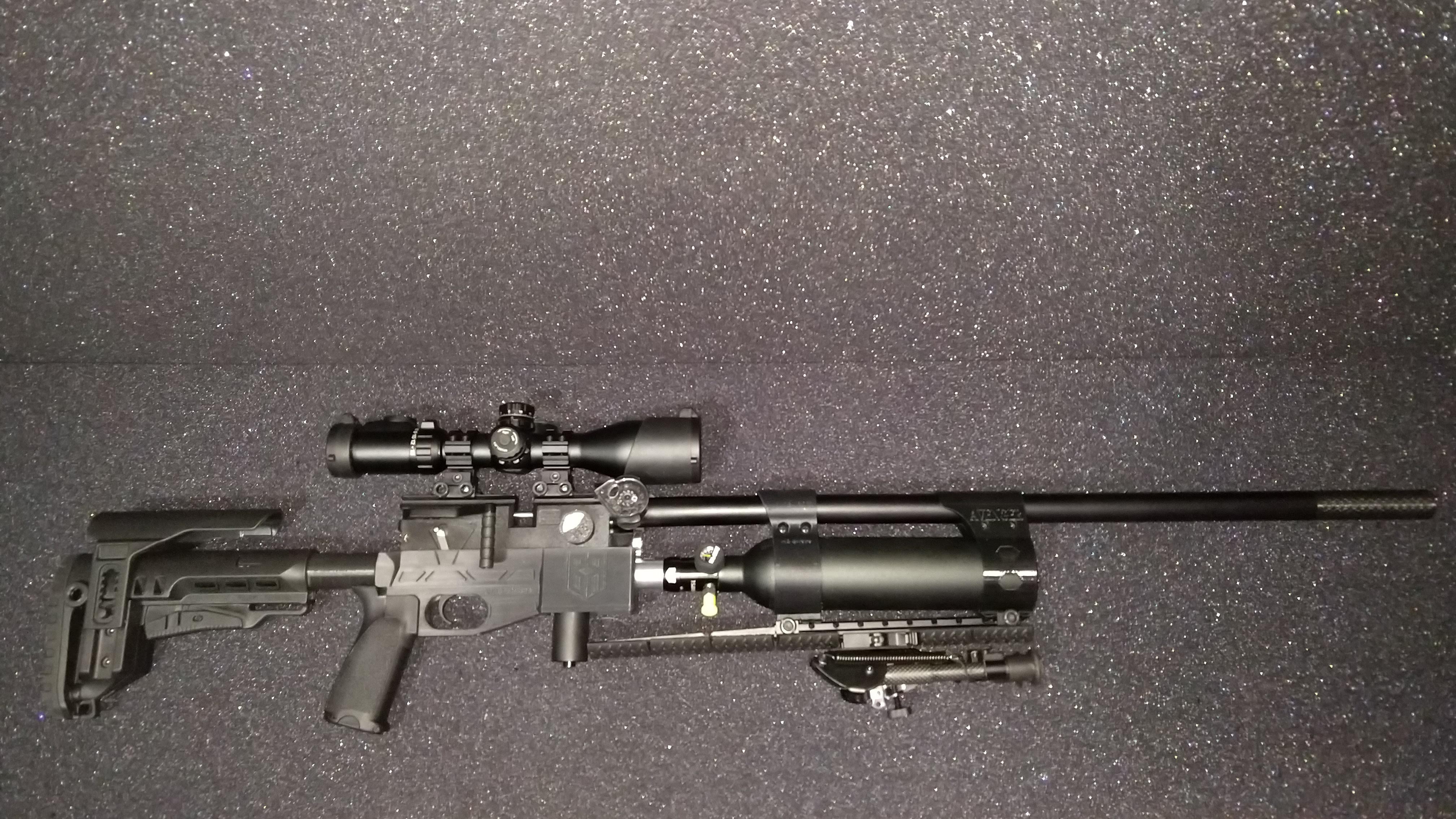

I did the bottle conversion basically right away. Have a 350cc aluminum bottle and Doux power plenum. So my FPS and reg setting is different than no doux plenum.
However I get these results at 2.3k or so reg:
HS 4.0
FPS 935.7, 934.5, 930.3, 931.7, 930.3, 934.5, 928.9, 935.9, 928.9, 930.3, 927.5, 928.9, 930.3, 924.8, 924.8, 927.5, 933.1, 927.5
Ave FPS: 930.3
Ave FPE: 34.85
ES: 11.1 FPS
Std Dv: 3.295619988880988
Personally I think that's great #'s and my downrange results show consistency too. 18 shots on a 2 inch spinner at 75 yards.
I get maybe 72 shots per fill before it falls off the reg but I keep it to roughly 54 since that's 3 of the 18 shot AE swede magazines.
I hand pump and back when I had it set to 2k reg psi I'd pump like 225 times from 2k to 4k psi. I'd get about 90 shots before it fell off at about 886 fps or so.
The pressure difference between my regs was anywhere between 600 to 200 psi difference. I think the suggestion is closer the better but basically just make it under 1,000 psi difference maybe. Someone else can give better #'s but I've not had issues with mine at those differences.

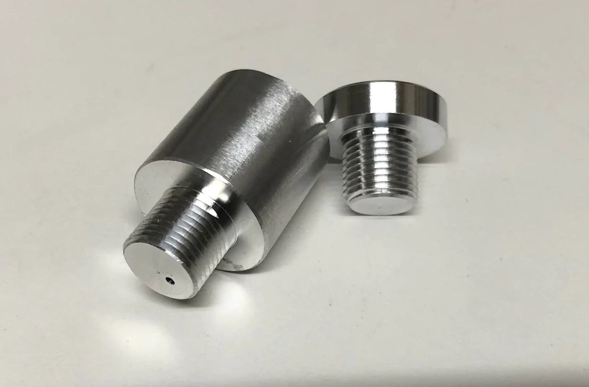

However I had issue with my Chinese ebay regulator and the AE Swede bottle adapter because I couldn't get the pin to push in far enough to open the reg up it has basically a check valve so when you screw it in it will press in the pin and open the bottle thru the 2nd reg.

It didn't work as planned because you are trying to depress that pin when 4,000 psi is holding it closed. It may work for you but it didn't work for me, the AE Swede bottle adapter started spinning with my bottle and since it doesn't have flat spots for a wrench it was hard to get them apart while pressurized.
Honestly I do not degas as much as I thought I would and I am happy with the pin removed so it just flows from the bottle straight to the 2nd reg then to the 1st reg then the plenum. I can hear it recharge.
Your mileage may vary though!!!!
#3 I would still recommend AE Swede adapter because it lets you have that 2nd reg and you can just fill right from the 2nd reg. The other option is the one that screws right into a bottle with no 2nd reg and besides being shorter by about an inch or so, I dont see the benefits cause that one is $$$ but AE Swede is like $35
