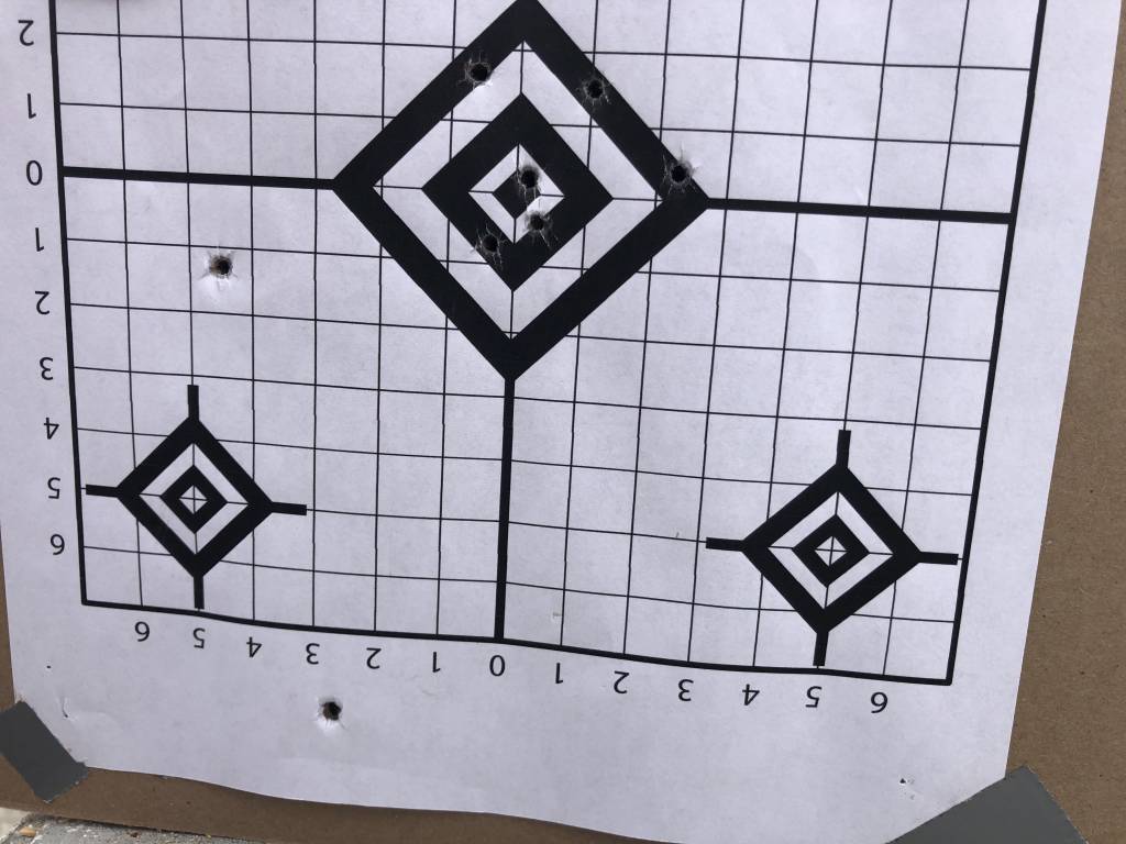

Alright, mounted my POS, BSA Sweet17 "what I had laying around" on medium scope rings. Quite a bit higher than it needs to be, but those were the only rings I had laying around also. 3000PSI in reservoir, 2000PSI reg. 2.75 turns on hammer spring, shooting cheap Crosman HP 14.3 gr. at 20 yards. First picture is 8 shots to get scope somewhat close. Rather than spend any more time sighting, I thought I would shot a 10 shot group. That is the second picture. Taped a nickel to target for reference. This was shooting out my backyard window, using the couch for a rest! I was moving around quite a bit. Need to use my Caldwell rest at the range. I think the Avenger has potential. Anxious to try my JSB's.
