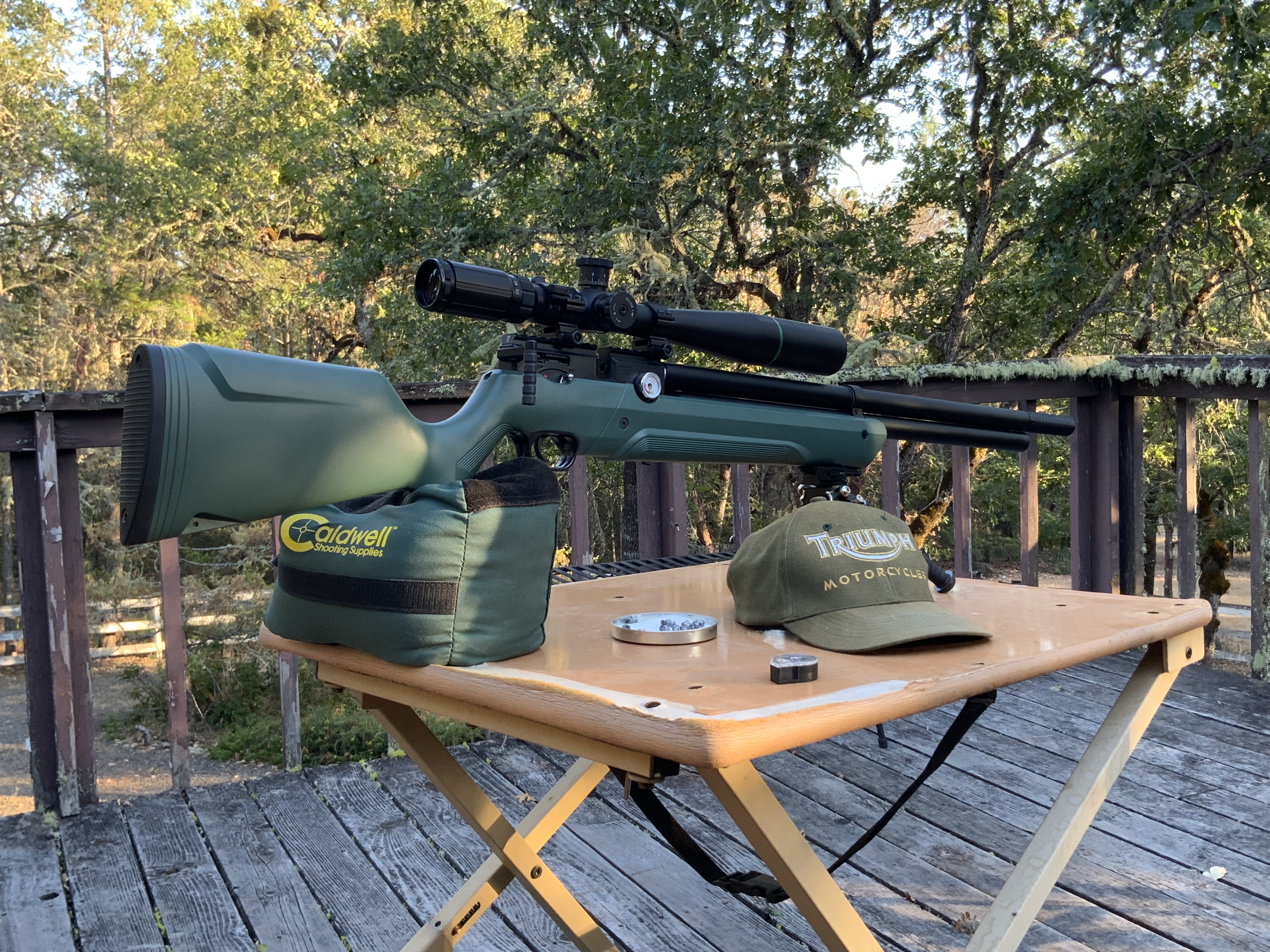

After two years and tons of mods this 25cal Avenger has become my favorite pcp rifle to shoot at 75yds and under from the bench. It has been up against some stiff competition. If price is the consideration I must say that at the time I bought it it was under $300 and the rifles I compare it to are up to 21/2 times more expensive. At this range they are not as consistently accurate as the Avenger.
Knowing that I had a neat rifle I thought that it should also look the part so I shaved and sanded the stock and filled the butt with polymer foam that hardens for a firm but still lightweight and balanced feel. Trying to keep the American blued metal look to the trigger guard I sanded and polished and clear coated it prior to masking and spray painting the stock.
The bore is lapped and polished and I use the professional tune on the regulator as described in YouTube videos. The piccatiny rail is an aftermarket metal replacement and the scope is a Mueller 8X32X44mm target dot that I leave set at 20X.
The plastic shroud retainer has been replaced with an aftermarket aluminum one and I included four other bbl/shroud centering rings as well as the one from the factory and the muzzle is tipped with a fitted air stripper. Other mods were to help sound deadening beginning with a single 1/8” hole drilled in the shroud at the breech end to release pressure and covered with 4 Mr. Clean cleaning pad wads fitted over the bbl within the shroud. At the muzzle end the shroud is filled past the air stripper with two baffles followed with an aftermarket moderator for the Avenger threaded directly to the shroud that joins it all together. It is very very neighbor friendly.
When I add up the costs of assembling this rifle it is close to the bare bones out of the box price of the rifles I am comparing it to.
I think it would be great to hear from others that are upgrading their Avenger pcp rifles and learn what works for you.

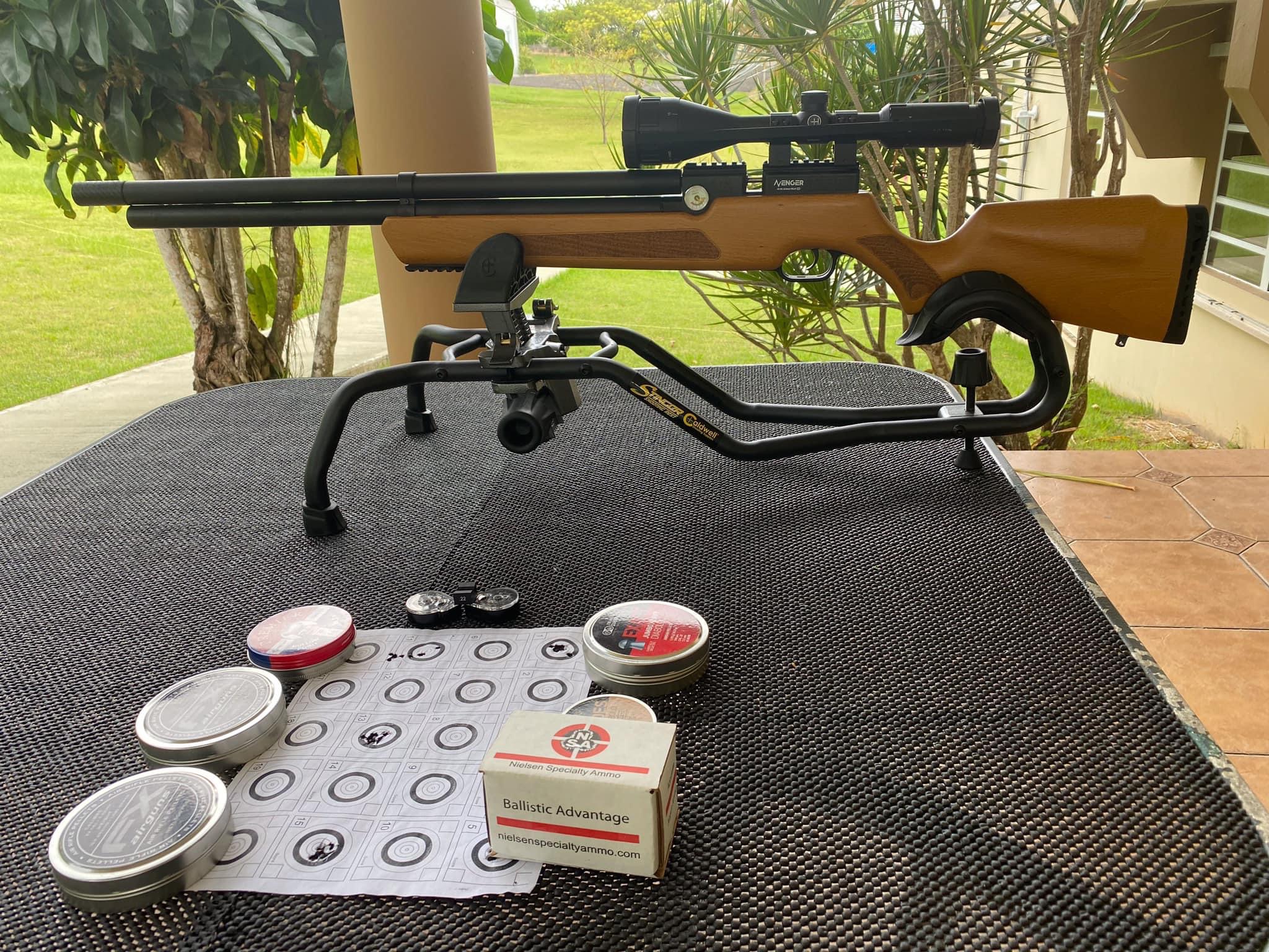

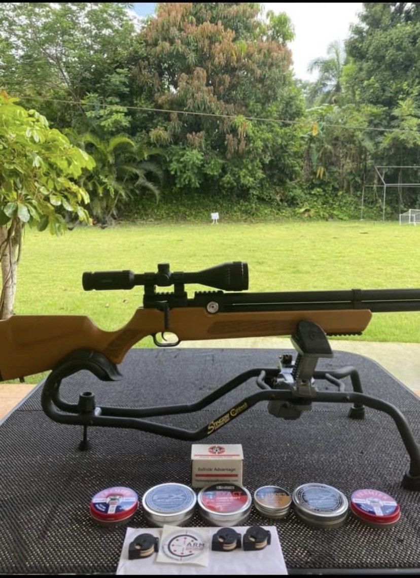

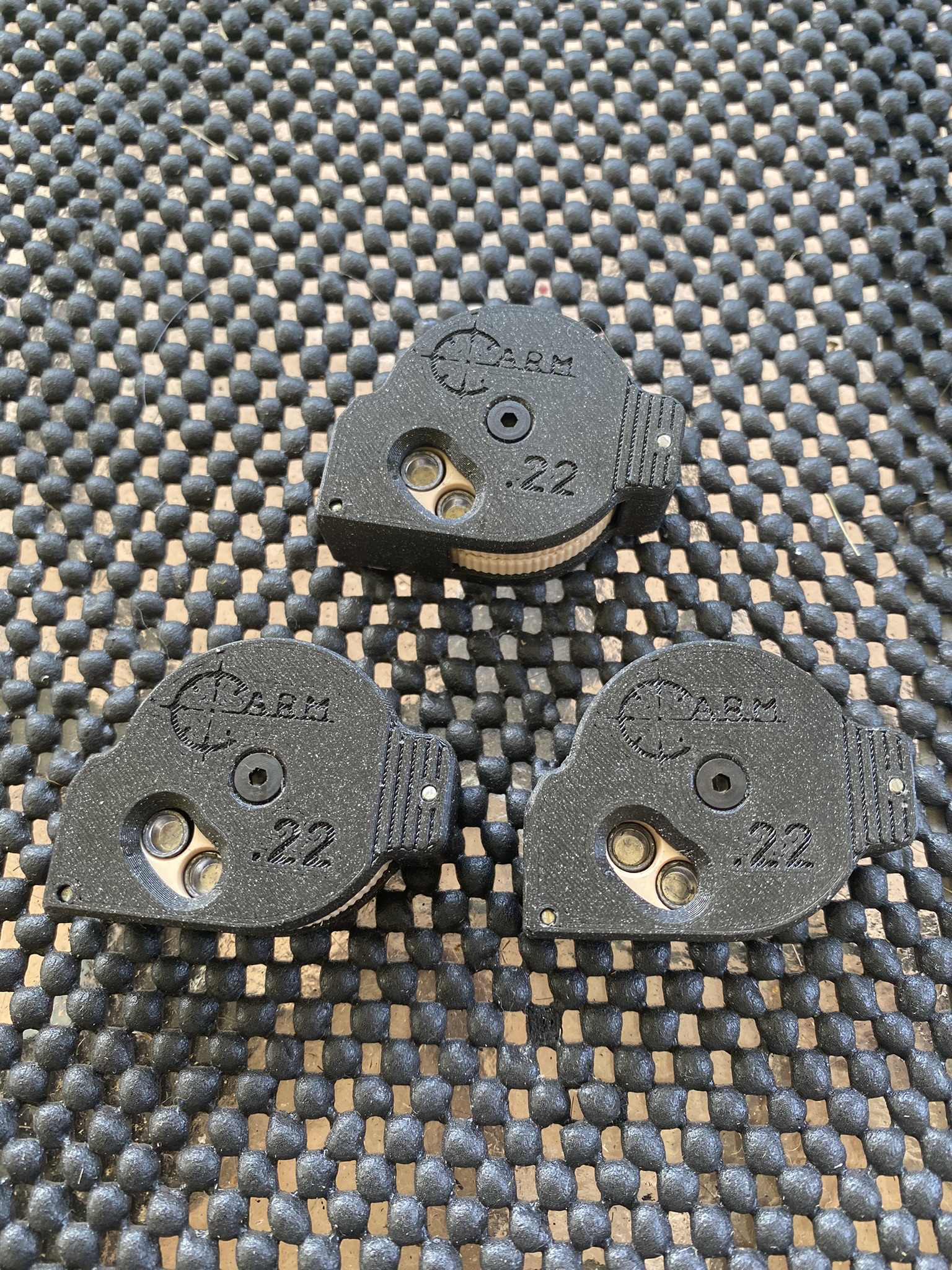

My .22 cal avenger wood stock its also shooting like a laser gun, the only mods done so far are a o-ring delete and the aftermarket Carm magazines. I am using a Hawke vantage 3x9x50 scope, with hawke rings and a Cameron 3D moderador since I do all my target shooting from my backyard. I also bought a DonnyFL FX moderator with the adapter since I was told that with this combo I can make the gun even more quieter and more accurate. It is currently tuned to shot between 880 to 890 fps with the crosman premier ultra magnum 14.13 and the JSB and hades 15.89 grains pellets. Tomorrow I am planning to test the more heavier FX/JSB 18 grains to see how they compare to this others lighter pellet’s.

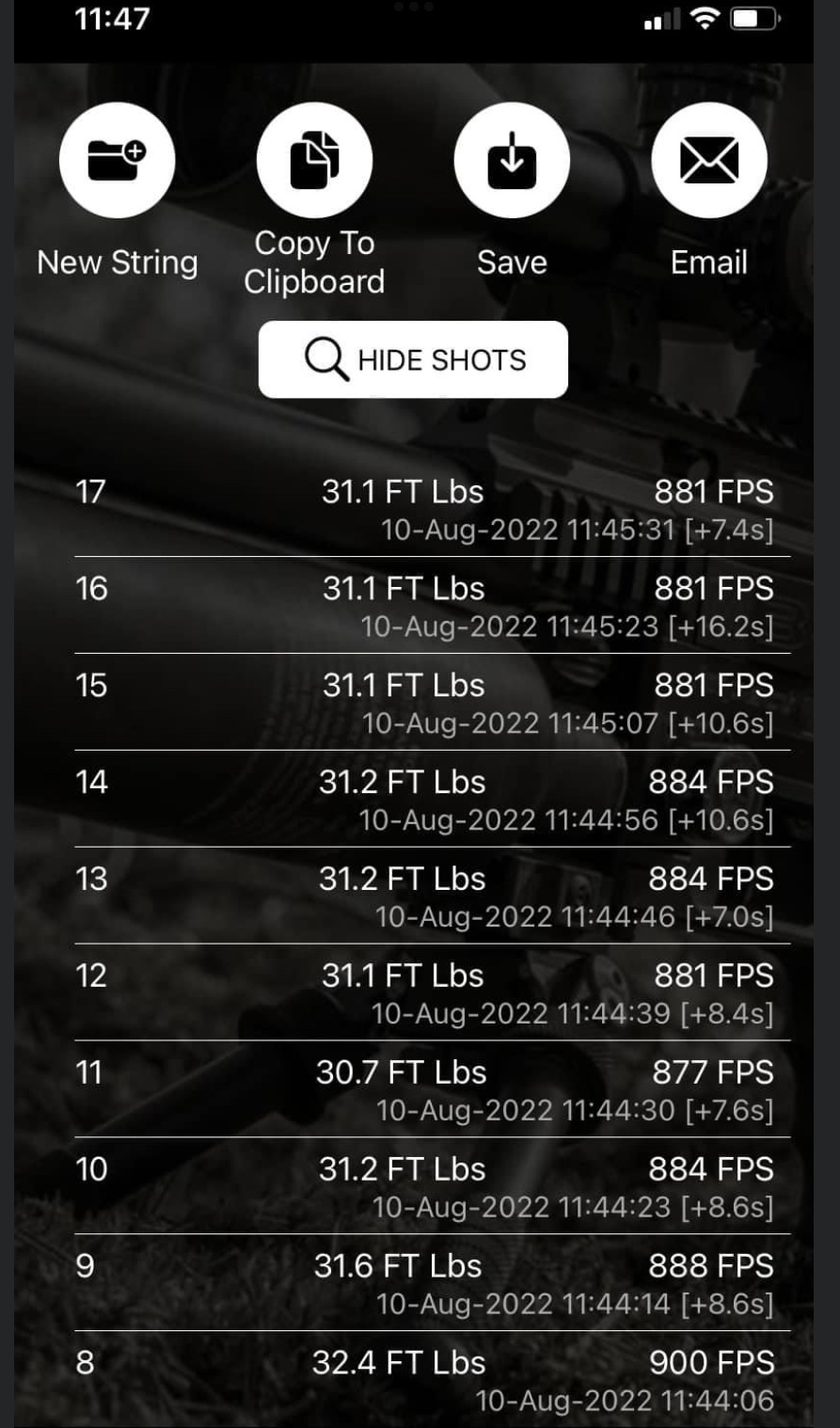

Nice target and set up, I see you are using proven ammo. In 22cal and I have found that my rifles likes the JSB 15.89gr over all others. EXCPT for (who’d-a- thunk) Sig Air Dagger 16.6gr domed. I can’t say that I’m recommending these, but I bought some on closeout and found that they are well shaped and made from a very soft lead alloy. Also there is a very high percentage of pellet deformation in the tins but what I found after sorting is that they are equally as accurate as the JSB’s, almost better. Something to try if you haven’t already.
Looking at your cleaning patches all I can say is if that’s the worst you got then you have a very clean bore. Mine was nothing like that and filth came out patch after patch. To the point that I had to remove the bbl to properly clean it. Close inspection showed me a pretty sad bore so I lapped it with 4 different grades of 3m paper and finished with 2 grades of polishing compound for an improvement. However it will still foul if I don’t pay attention to it.
I don’t know anything about the clips you are using and would like to learn more about them. If you bought 3 of them you must think they are an improvement so I would be grateful for a heads up.

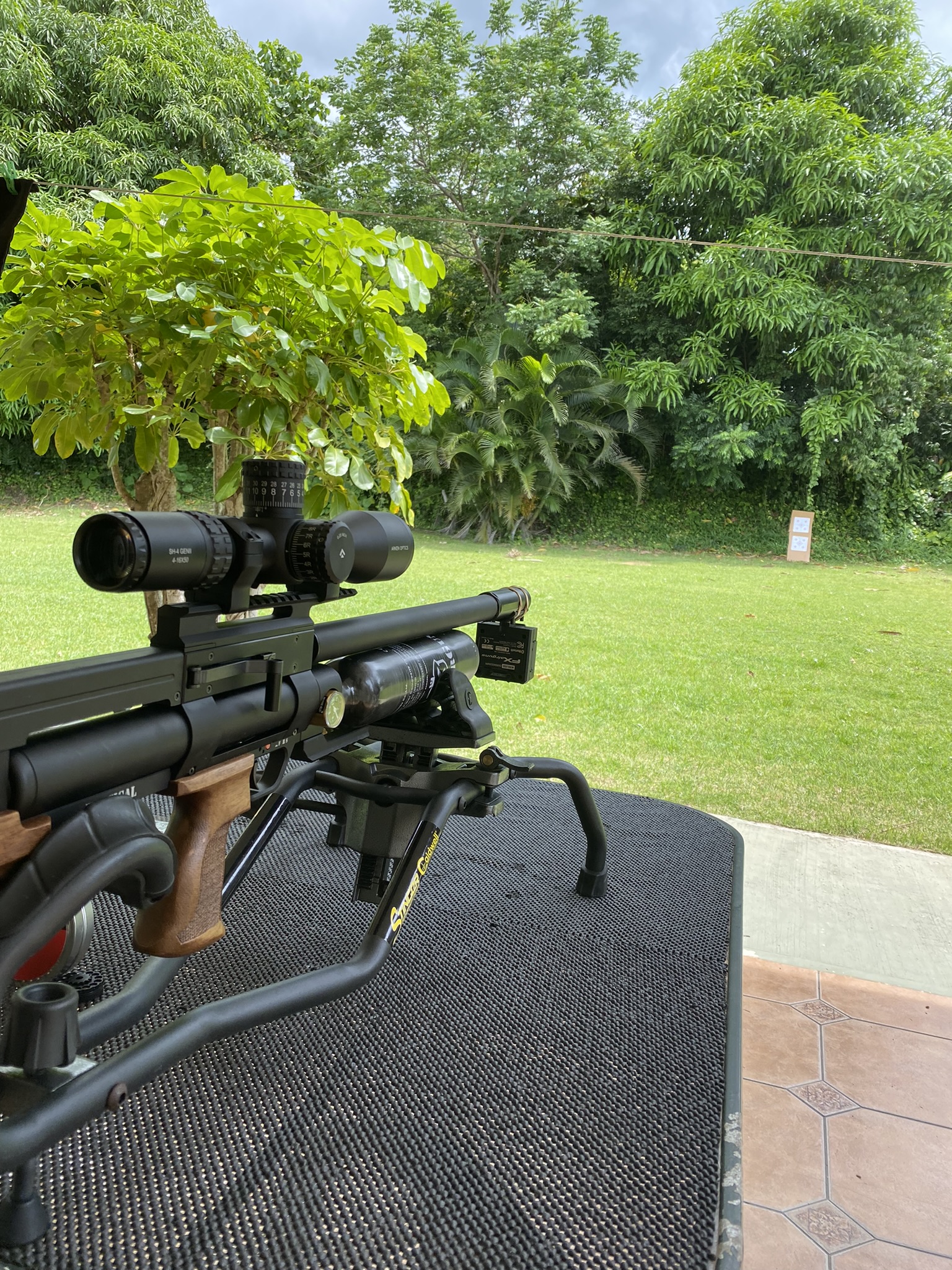

I also have the DonnyFL extender and have used it with several different moderators and it worked. But overall I have settled on the setup as pictured as this allows the use of 2 to 3 extra baffles between the muzzle/stripper and the tip of the shroud with a moderator that has 7 baffles, two that enter the shroud. While the DFL set up was quiet, I have found that this way is shorter and lighter and somewhat asthecialy more pleasing and actually quieter in my opinion, also less expensive.

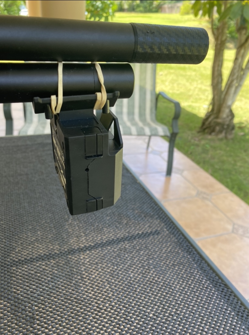

Unfortunately this oem AVA mags in .22 cal are usually designed with a very poor quality control. This in turn causes them to be manufactured with very little tolerance, and as a consequence of this they cause some shots to come out very erratic, the undesirable so-called "flyers".
These prevent and make it impossible on many occasions to make good groups with these rifles. But I was told that this phenomenon just happens with the smaller .22 calibers NOT with the bigger .25 calibers guns like yours, so in your case you don’t need to invest in any aftermarket mags you’re good 👍.
This is the main reason why I currently use my avenger with this aftermarket magazines made in Europe called Carm magazines. With them I can shot a string of 80 and 90 rounds one after the other without a single flyer so they work as advertised 😉. The advantage this aftermarket mags have over the oem AVA is that since they are manufactured with much more tolerance and quality control process in a CNC machine they are much more precise. Therefore this prevent our guns from firing erratic shots. For this reason mine is now much more accurate and shot with greater precision than before.

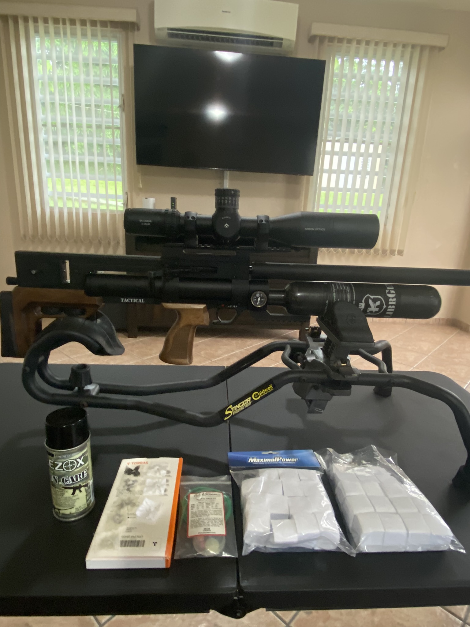

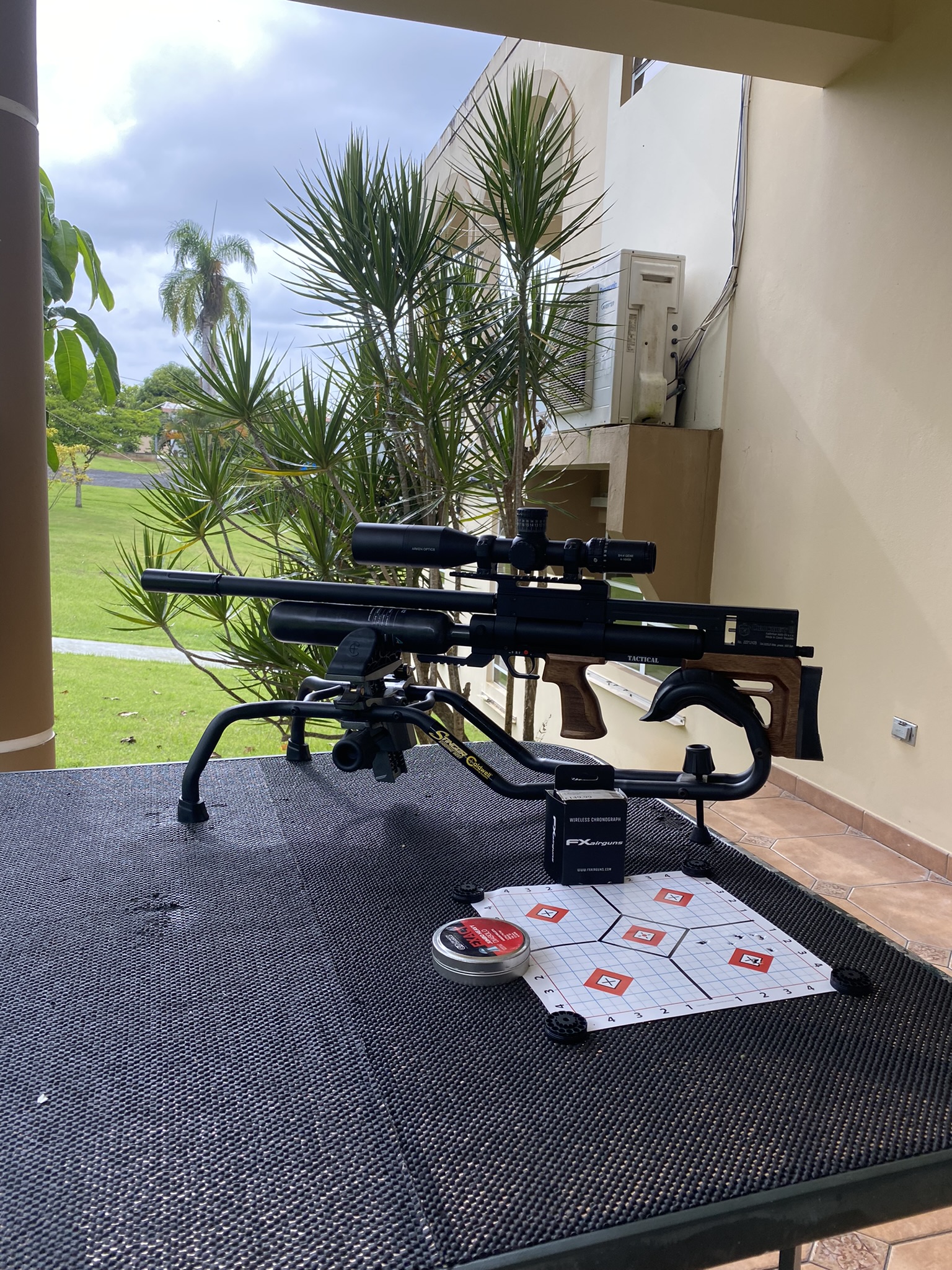

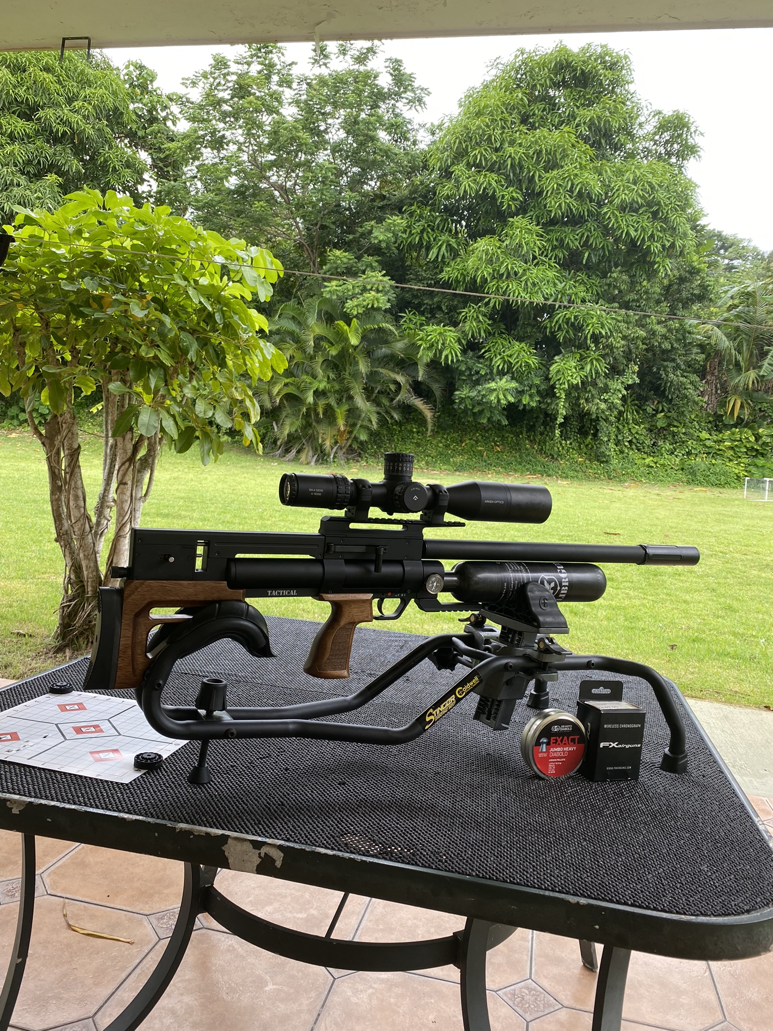

Last week I bought a Kaliburgun Cricket 2 Tactical wtc 60 in .22 cal also with a Arken SH-4 Gen 2 4x16x50 scope with the Arken 34mm medium height rings last week, this is why I also bought a DonnyFL sumo moderator that its supposed to received today or tomorrow since I was told by Charlie Fear and the people from DonnyFL that for this particular gun with the sumo I can make tighter groups.
Then I will test my other DonnyFL FX moderator that its currently installed in my Kaliburgun with the adapter in my Avenger to see if perform better than the one I am currently using the 3D printed Cameron that I bought from Ebay that its working absolutely perfect with my avenger. Then I will compare both guns at 55 and 75 yards with the same JSB 18 grains pellets since both guns love them to see which one its the most accurate and precise and absolutely king at this range. Currently both guns are shooting like tack drivers so I bet this would be a very interesting comparison test.
I will post the results in the Kaliburgun Cricket Owners fb page and in the Air Venturi Avenger shooters association fb page also, usually I don’t post here in this forum very often. I am just waiting to the arrival of a Caldwell precision tripod that I also already bought for the Cricket, since this bench rest fit perfectly the tactical stock desing of the Kaliburgun to began with the test. I will use the avenger with my other Caldwell stinger bench rest that I already have since this gun long style stock desing fit perfect for this bench rest as well. Stay tune this coming days should be very interesting in my personal opinion this would be the best overall budget gun currently available in the market vs what I consider also one of the most accurate and precise high end gun currently in the market as well.

Carm magazines are nice for a 3d printed part but I like the high capacity, cnc machined magazines from AE Swede much better. Made in the USA.
