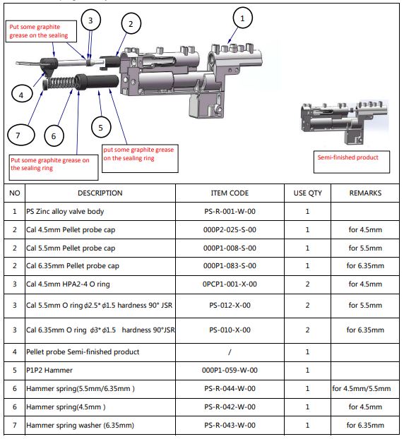

Tuning Avenger heavier hammer spring
Is this a 22? While the 25 uses the same spring it also has an additional washer/shim. I believe the 25 cal default reg setting is 2900psi.
I would think it should still be fine at 2Kpsi, though. You may have something else going on, such as hammer galling, etc.
Am I missing something thought the avenger was a 3000 psi gun 2900 psi set reg doesn't make sense even 2600 psi set reg is rather high that's over 150 bar idk though thanks
My .22 says 300 bar (4351 psi) max fill. And 2900 psi max reg set pressure.
I'm set at 125 bar (on cheap unreliable factory gauge), maybe 5/8 or 3/4 of a turn in on HS, shooting 18.1 grains at 870ish fps (I think it maxed around 920ish....I don't remember). But for MRD's, I needed max reg and max hammer, and still wasn't going above 900 fps....IIRC.
