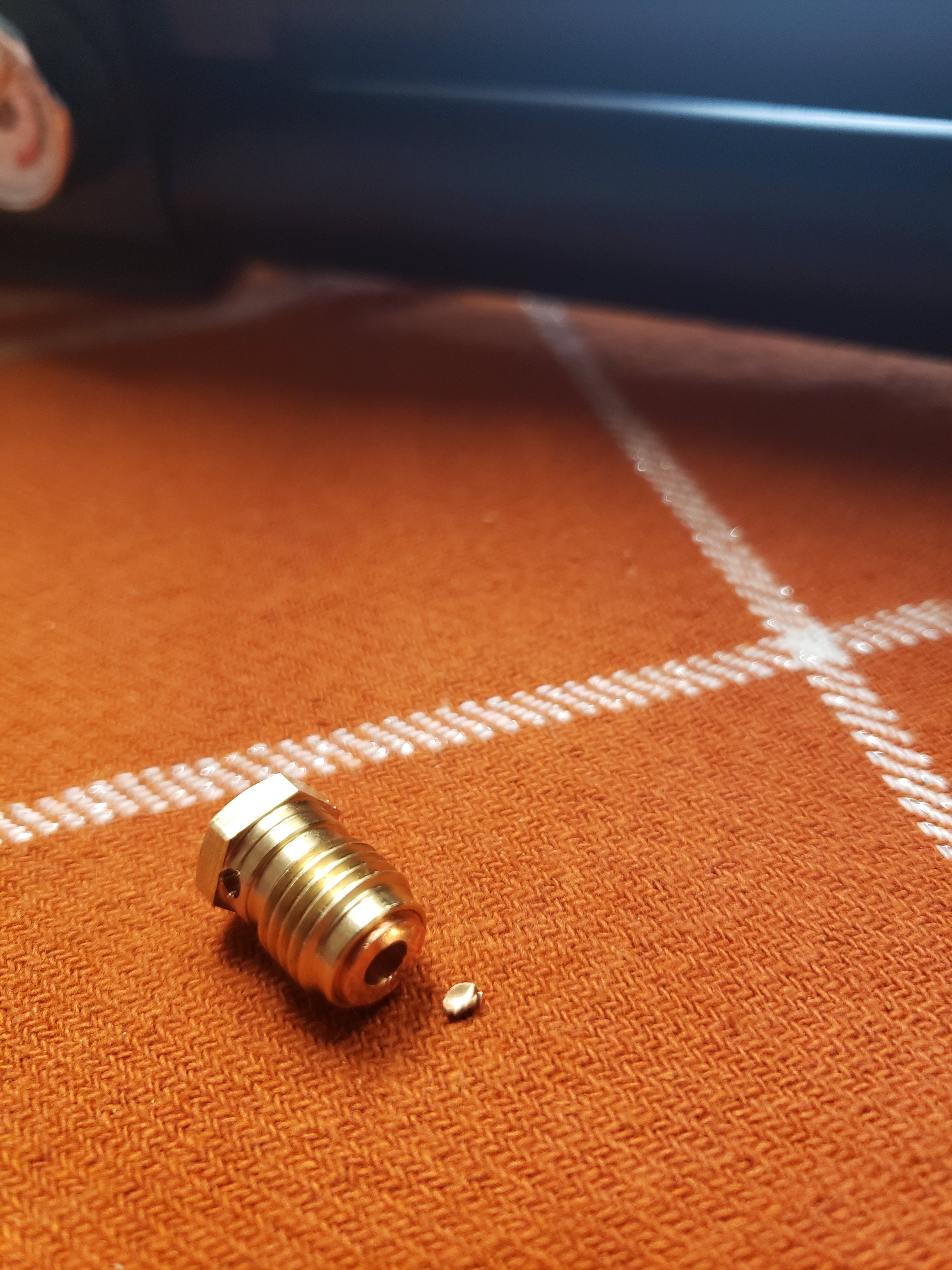

When my Kral burst disk burst around 3700-3800 PSI (on the compressor gauge) I made a burst disk myself.
The Kral burst disks are circles 9mm in diameter made from copper.
I made a burst disk from a Crosman pellet tin, cut to about the same dimension as the original disk.
It will likely not burst until it gets to some very high PSI but that's OK since I cannot fill my PCPs over 4500 PSI with a cheap compressor anyways.
Initially I tried to make the burst disk from a crushed pellet but that only lasted 1-2 days, so don't try that.
