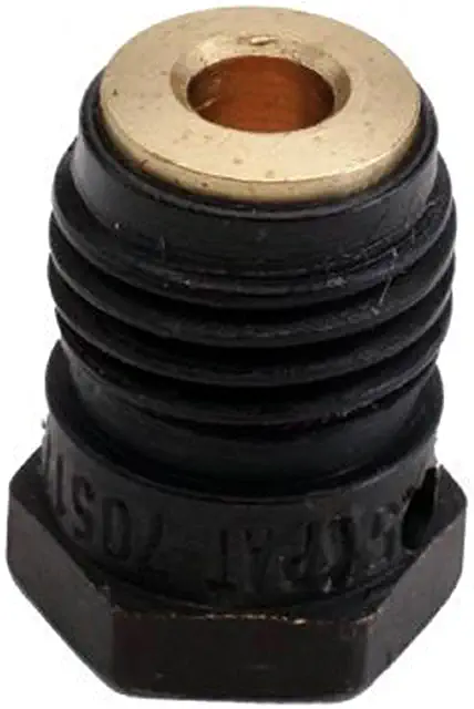

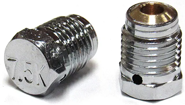

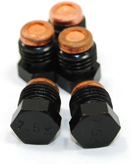

Both of my compressors came with a handful of burst disk replacements. They are the metal disk type that you put underneath the burst disk fitting like in this video. No markings. One set is brass, the other is aluminum.
I am guessing that the burst disks on airguns may or may not use that type of burst disk. I am seeing several styles on Amazon etc. It looks to me like having several spares on hand that fit every gun / tank / compressor I own would be a good idea. The thought of having wait for replacements is very troubling!
