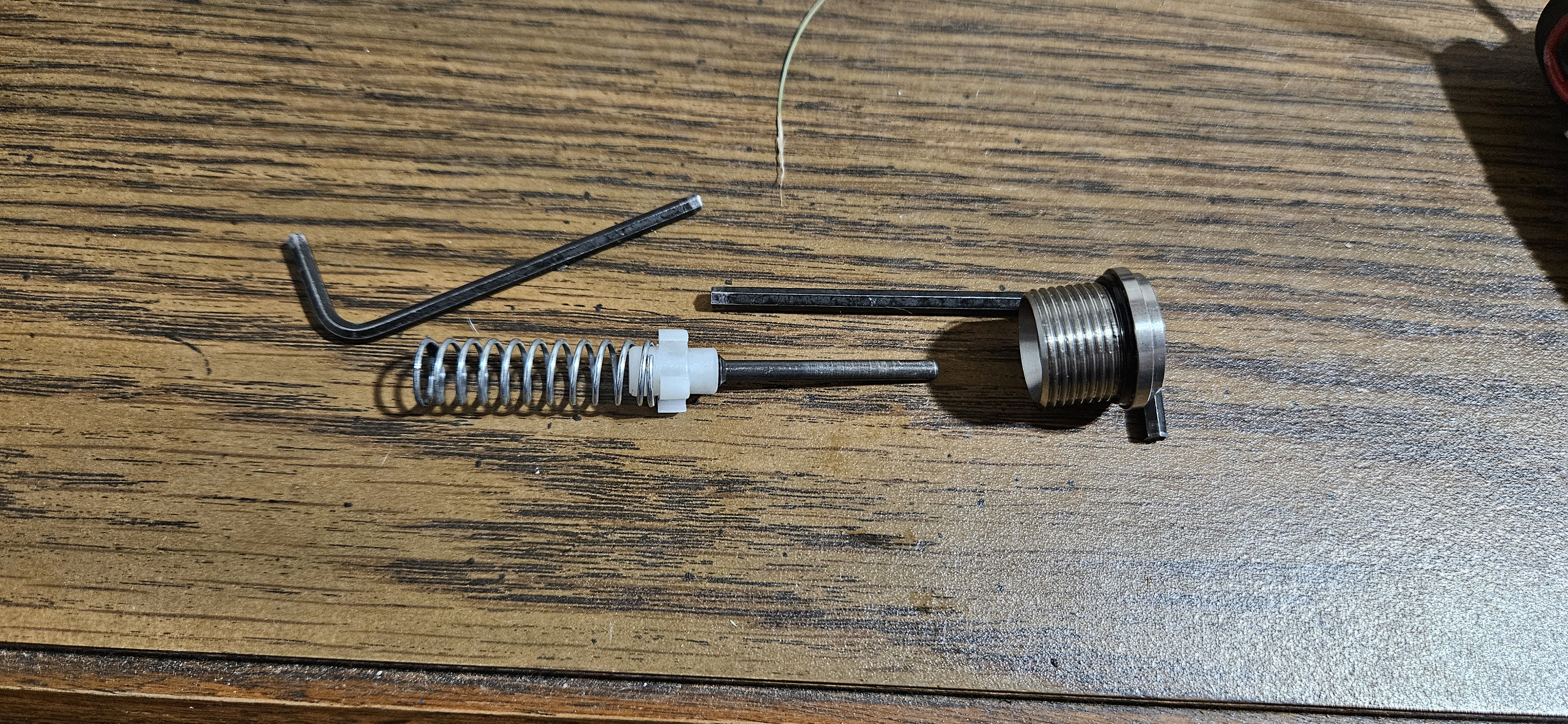

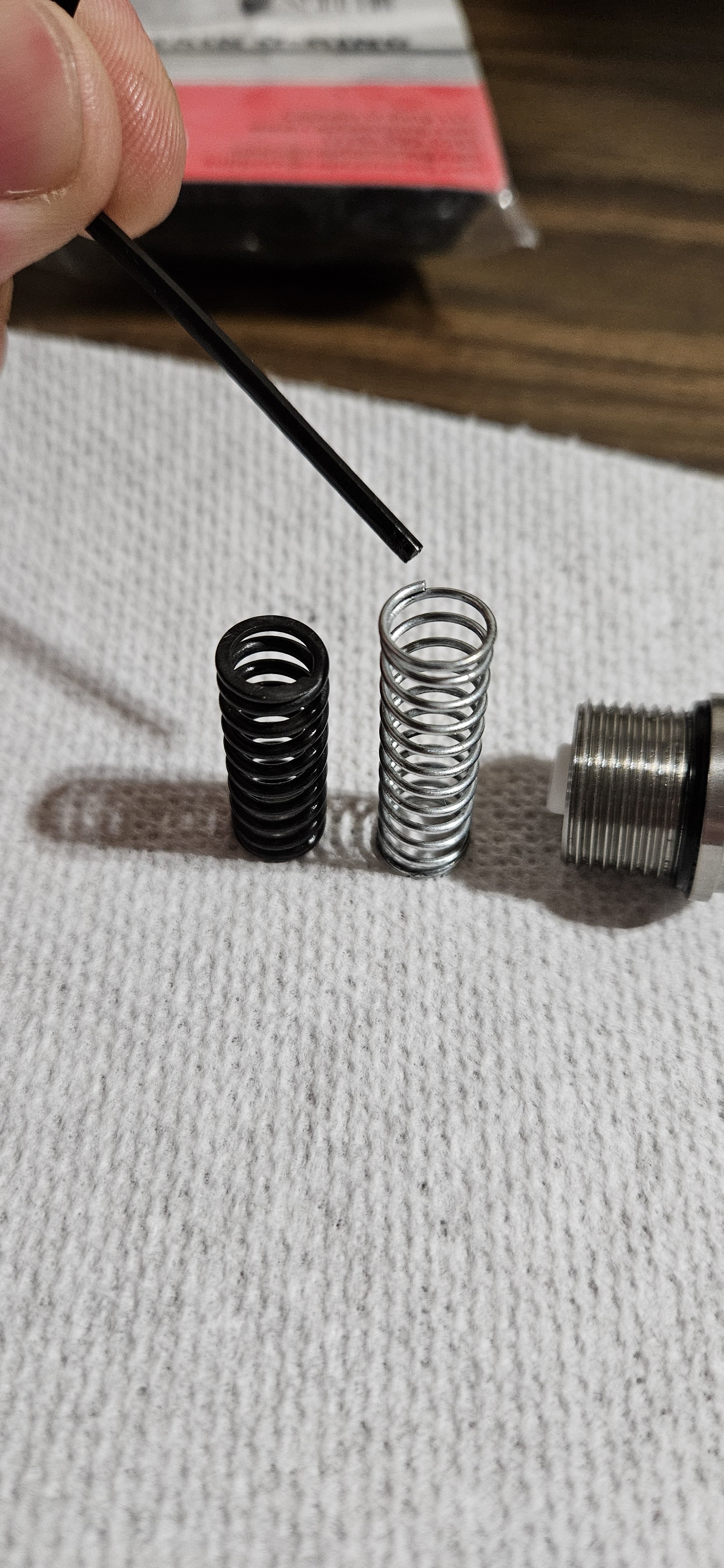

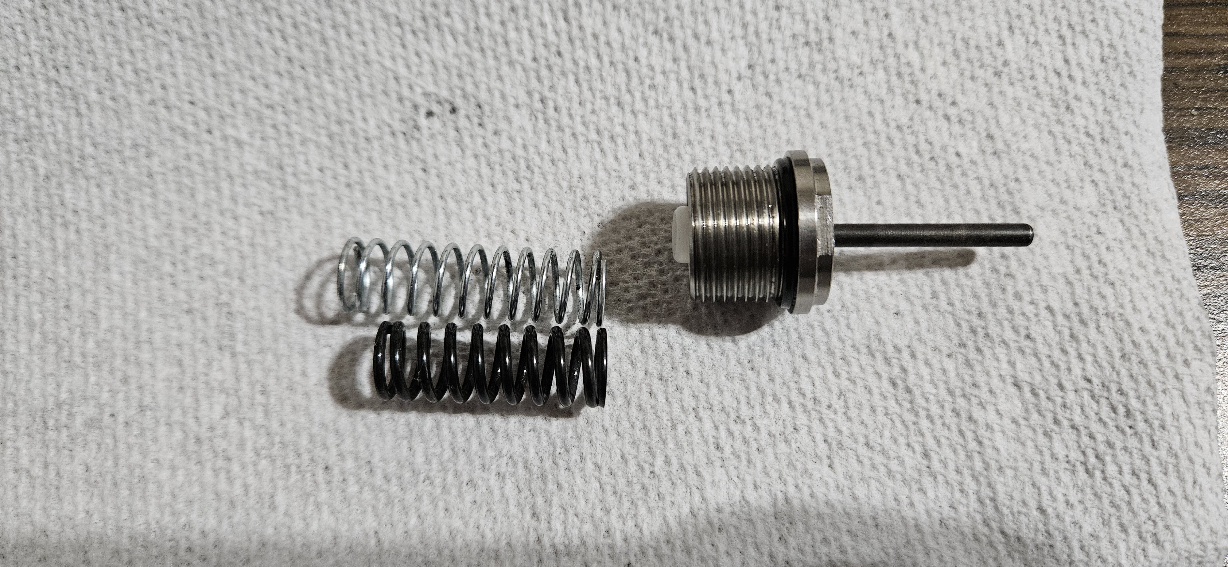

Hey guys I have a little update. So my Avenger squished out an o ring and I need a replacement, need to know the size I posted about here https://www.airgunnation.com/thread...e-plug-o-ring-for-bottle-adapter-kit.1321150/
Anyway since it was out of air I decided to pull it apart and get the poppet under inspection.
Poppet is totally fine. I think the issue is the lighter replacement spring is not ground flat. The spring must rotate certain times of shooting and the coil hangs up the poppet and makes it stick sideways. See photos
So I am going back to original spring.
Hoping this stops the brrrrrt air dump!
