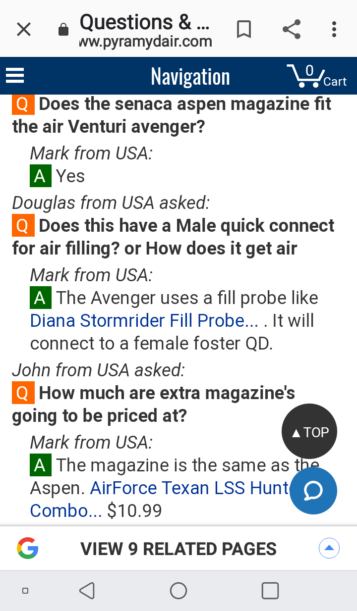

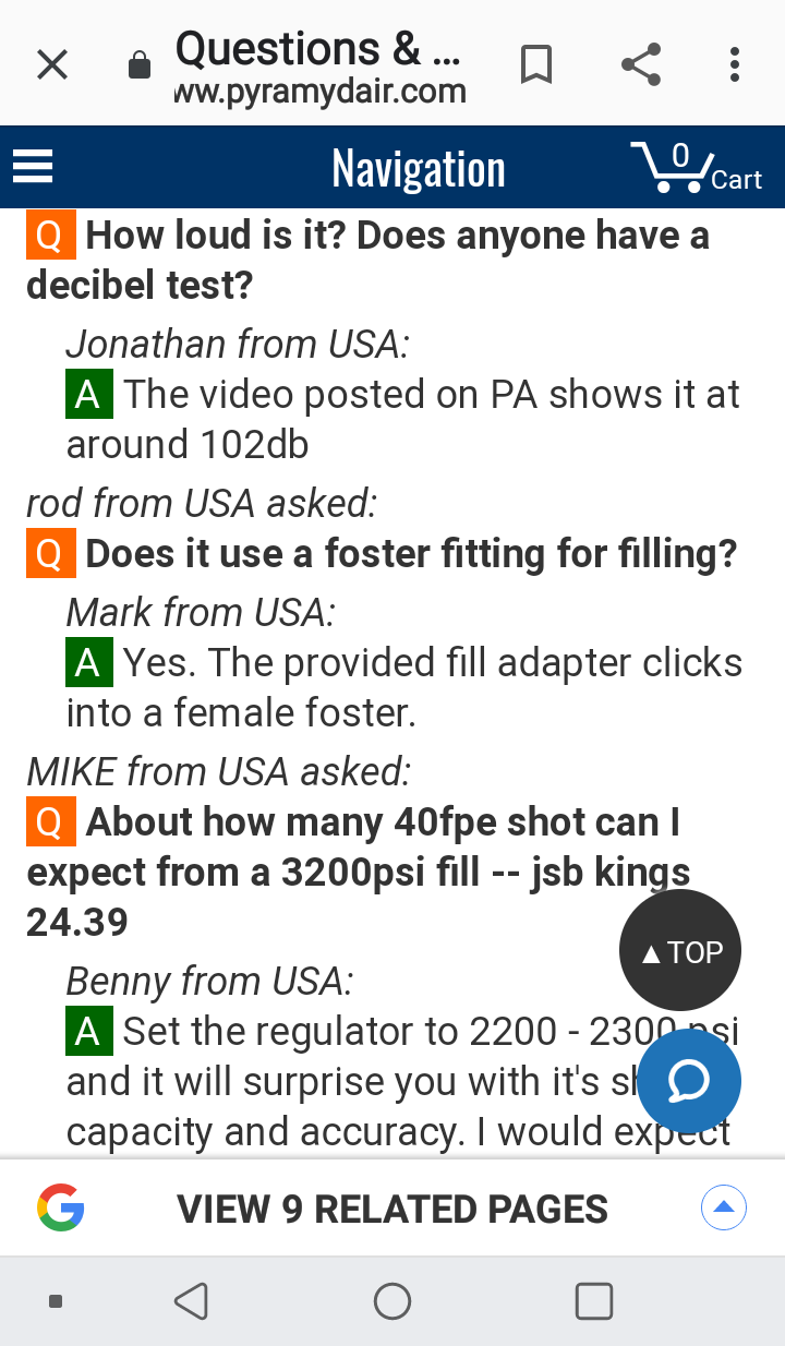

The NV Liberty used a spring and ball check valve with a fill probe fill device. I believe the Avenger swapped to a male foster, but kept the spring/ball check valve. Your problem is most likely to be in that check valve. I haven't seen blockage, but have seen 3500 on fill but only 3000 in gun.
Contact AV and see if they will send you a complete fill assy or degas and dis-assemble.
Fuzzygrub is correct! Better tell Mark over at Pyramid Air!
