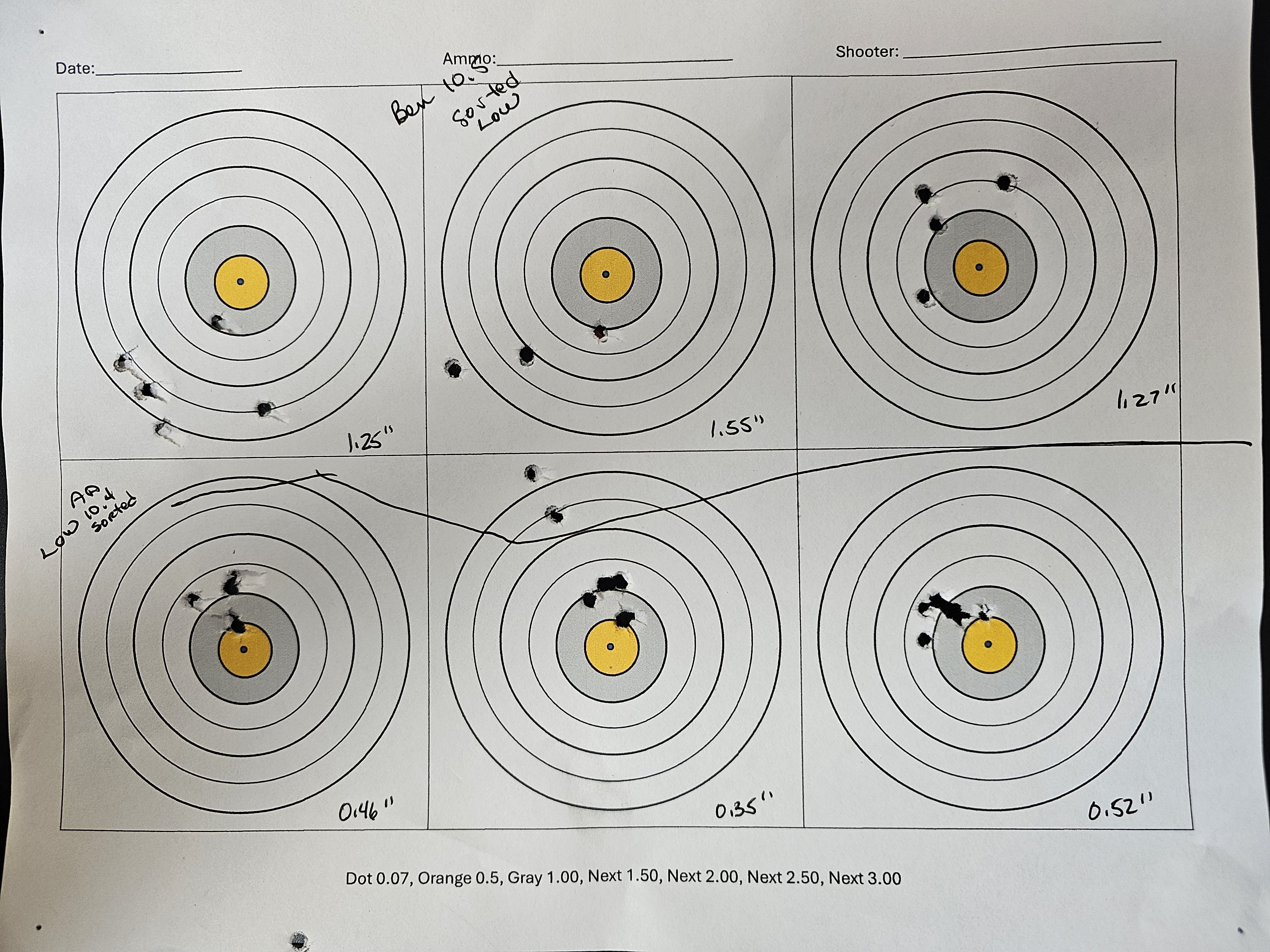

I think I have found my out to 50-yards setup for my .177 Avenge-X. As a newbie I didn't want to mess with "tuning" the rifle until I am more comfortable. My goal was to find a combination that performed as well as my TX200 MKIII at 50-yards. The TX200 shoots about .60" to .80" at 50-yards.
Previously I tried 6 commonly good pellets on the high setting of my Avenge-X. A couple were promising but at 950 fps to 960 fps for 10.5 grain seemed too hot. There was some looping taking place.
This round I dropped to the low setting. Low runs about 820 fps to 830 fps with 10.5. The SDs were 1 fps to 2 fps. I tried a couple H&Ns, AA 10.3's and Benjamin 10.5 grain.
The AAs were shooting about 0.50" at 50-yards. It was repeatable over different days. So a .177 shooting 0.50 at 50-yards seems good to me.
