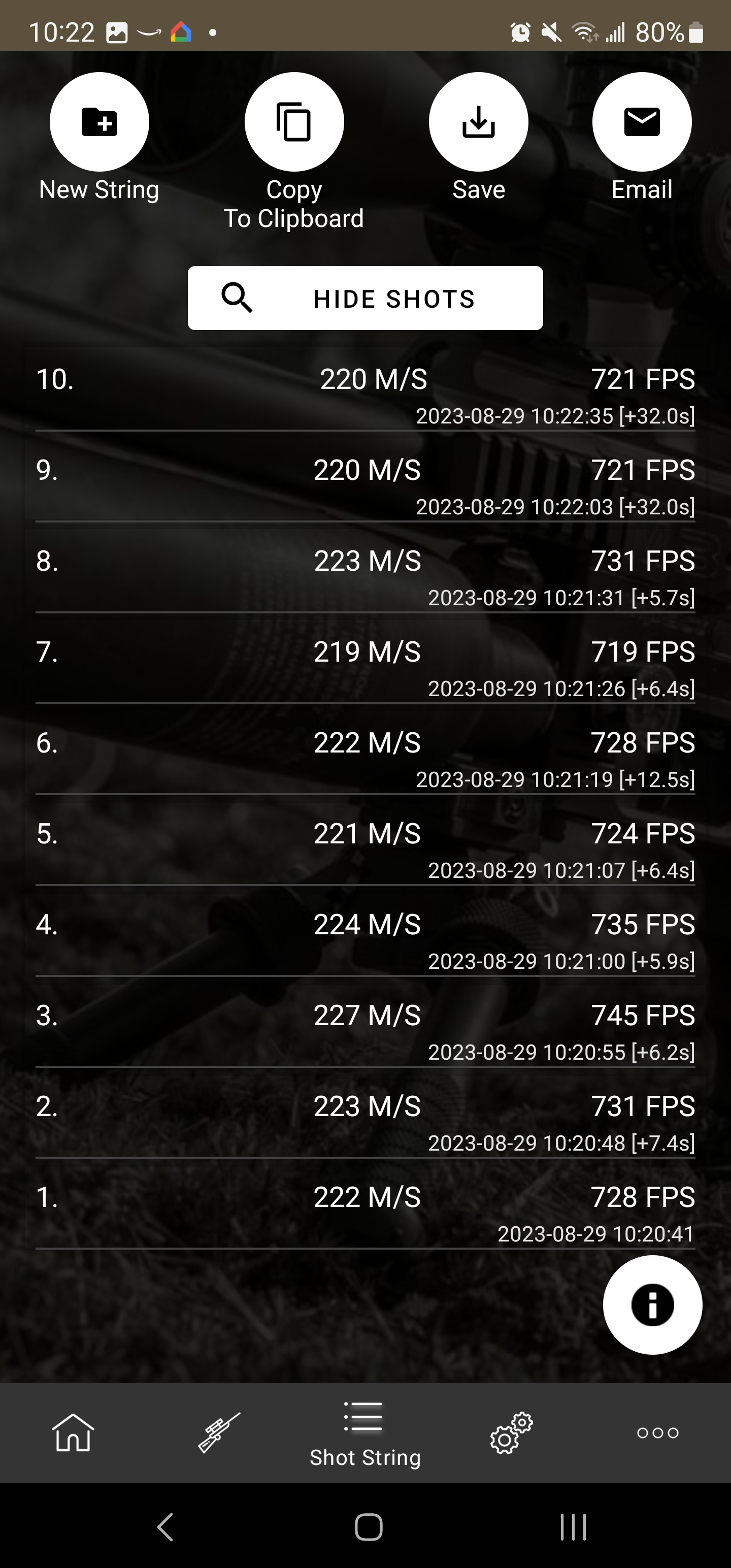

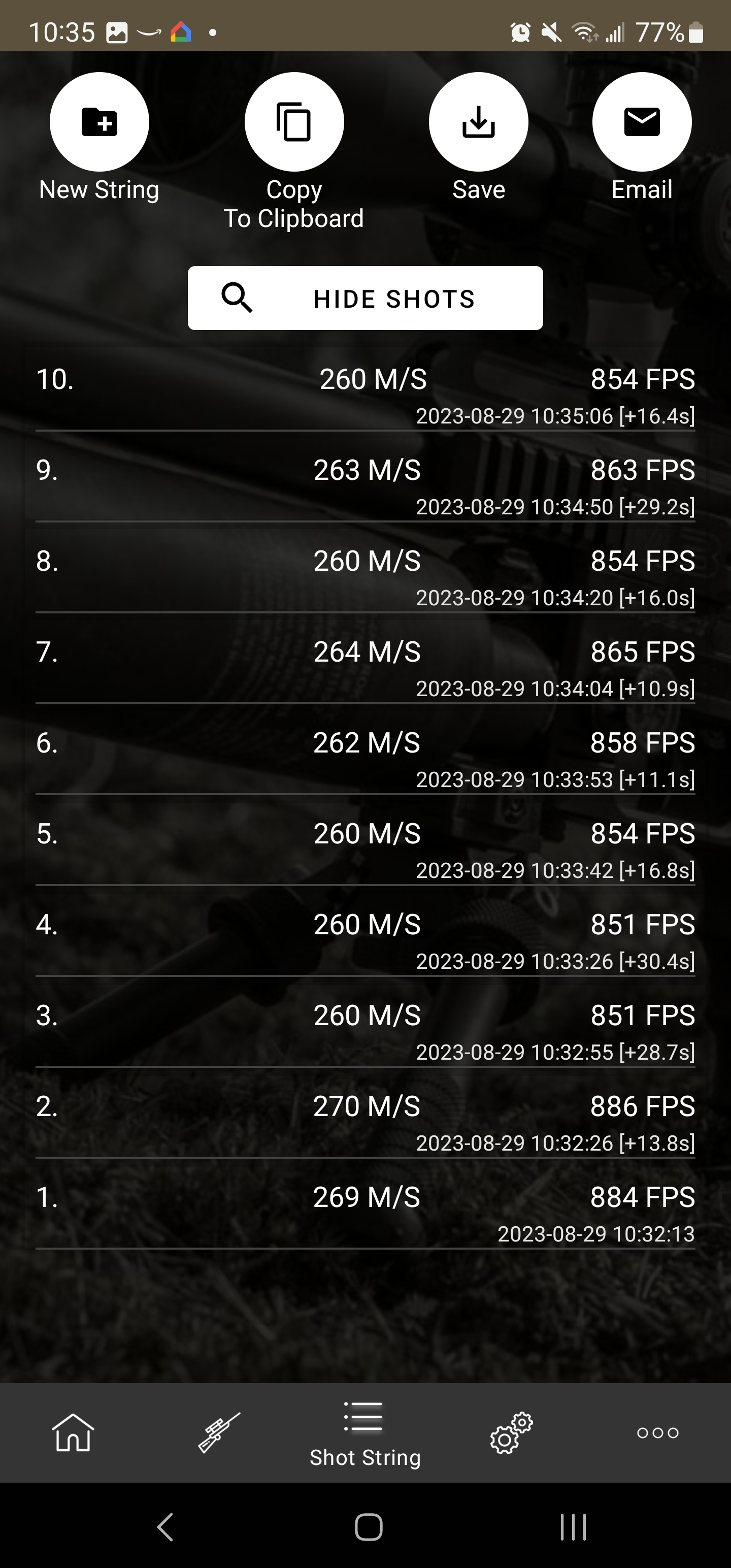

Here are screenshots of 10 shot strings from PW3-7 from left to right. I don't know what type of fps that I should expect with 125 bar, but I never got over 900 fps except for two shots that came close at the start of the PW7 shot string (886 & 884).
As you can see, the FPS is not very consistent in any setting except for the PW6. I started taking around 10s between shots starting at PW5, which seemed to help at PW6 & 7. I topped off the tank prior to this sesh and I have not made any adjustment since taking these shots. At this point, I am waiting to see if anyone has any recommendations before I start adjusting things.

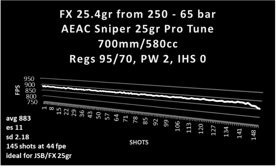

What is interesting to me, AEAC posted his Maverick tunning guide and his gun is averaging around 883 with much lower reg pressures and it's a .25cal (see below). I understand he has been doing this much longer than me, but it seems my gun is working harder with less performance.
I've posted my reg pressure below again for reference, but it seems like his gun is performing much better than mine at lower settings.
