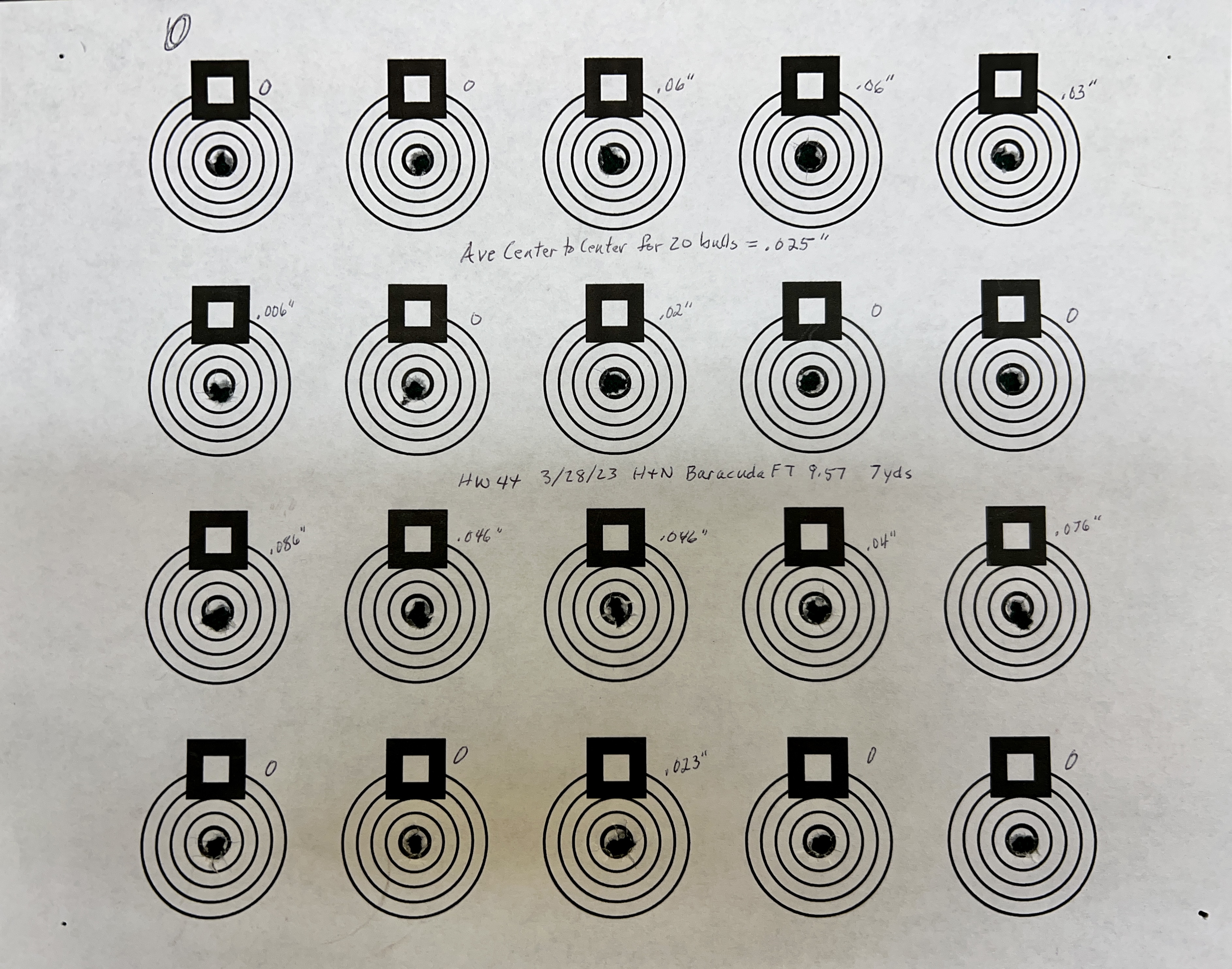

I'm placing this in competitions even though it isn't meant to be. I thought I would start tracking average group size (center to center as would be typical) over a large number of targets. For me, that's either 6 bulls or 12 bulls since my HW44 mag holds 10 pellets and that divides out evenly. But for this first post I shot a card with 20 bulls (took a while) at my indoor basement range distance of 7 yards for an average of .025” for all 20 bulls. The ones marked 0 are just one hole 4.5mm in diameter for 0” C to C. @ThomasT

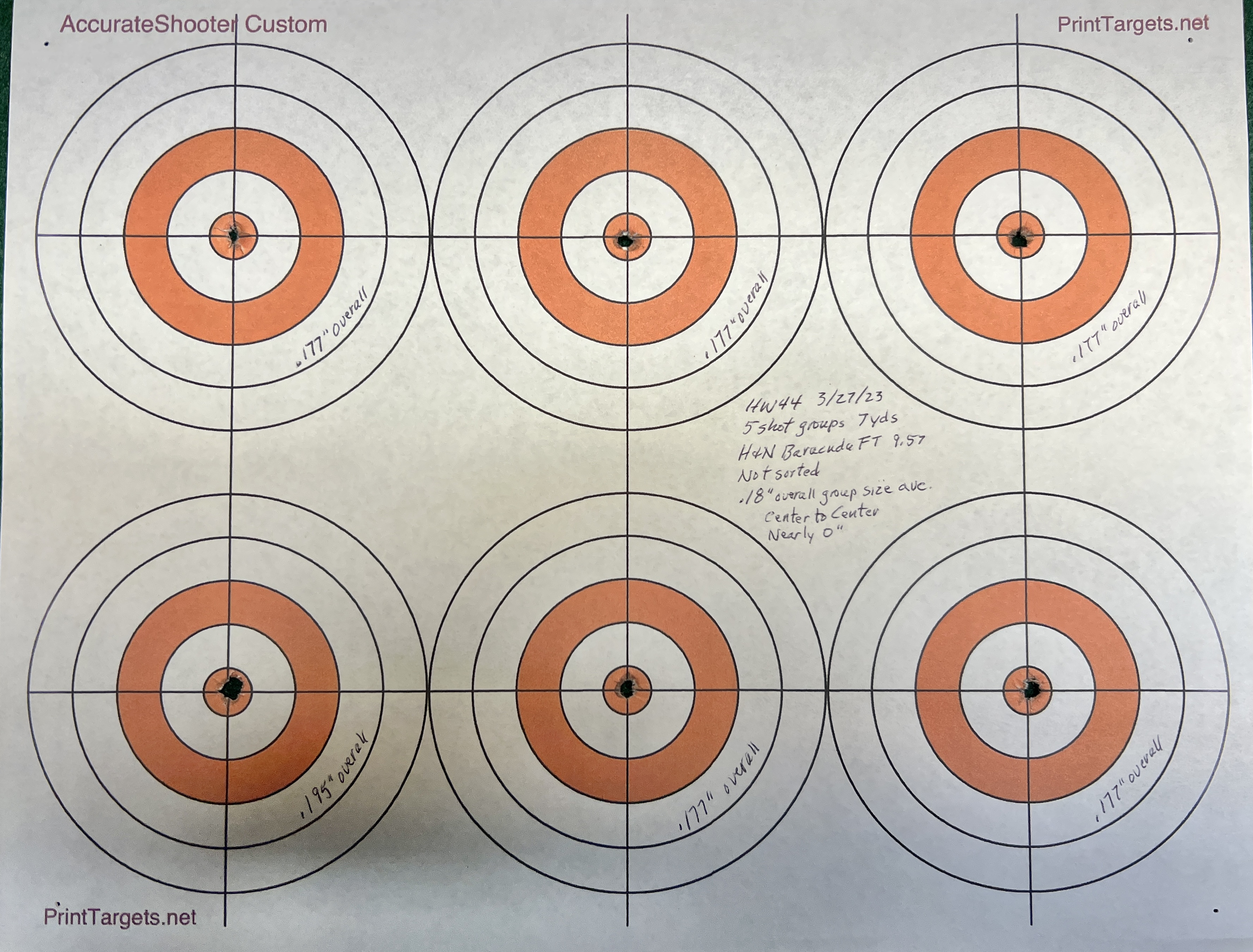

This next one I shot yesterday when I was thinking how this would go. Only 6 bulls.
The notes show OVERALL GROUP SIZE not center to center.

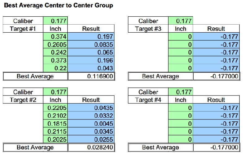

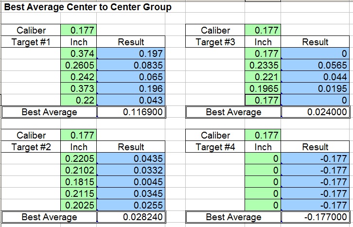

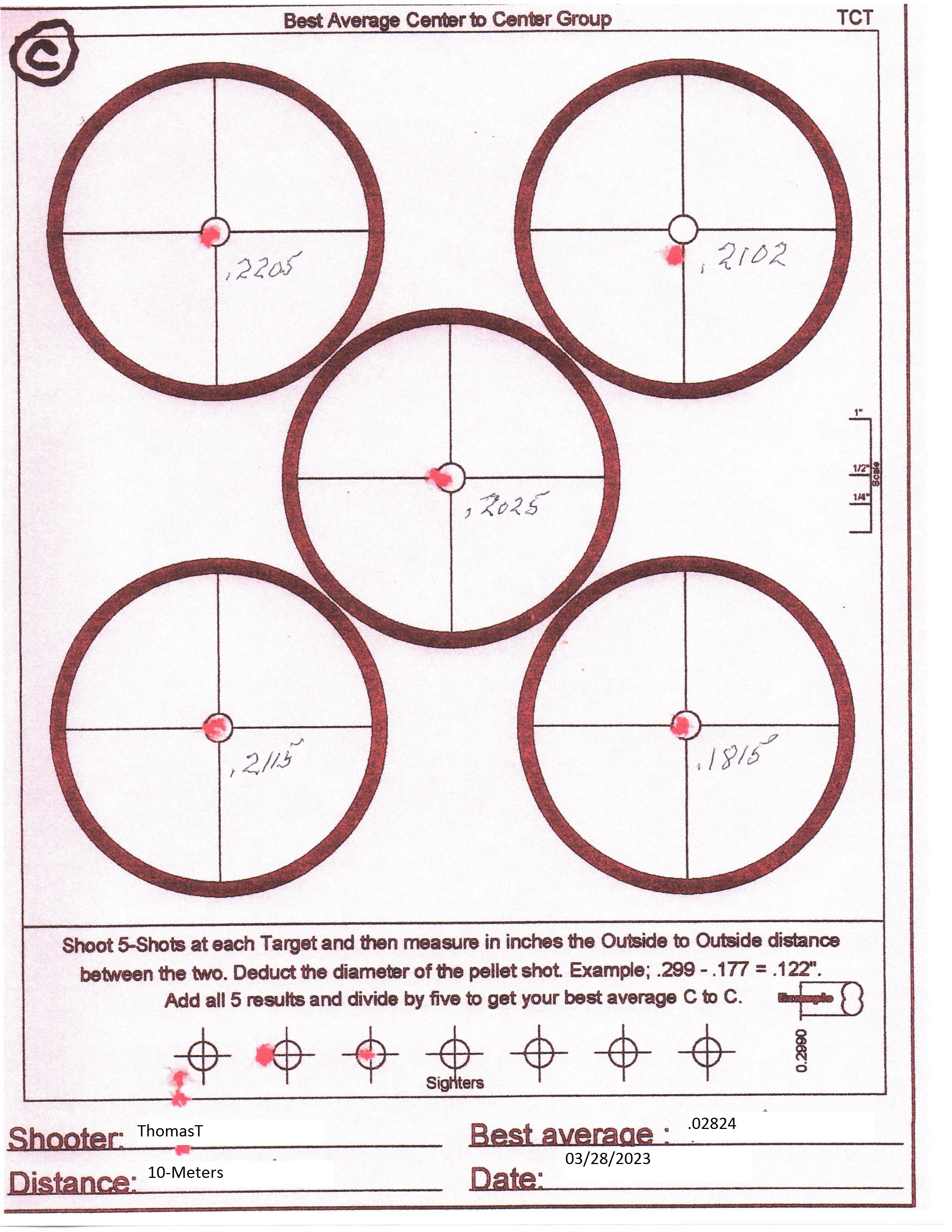

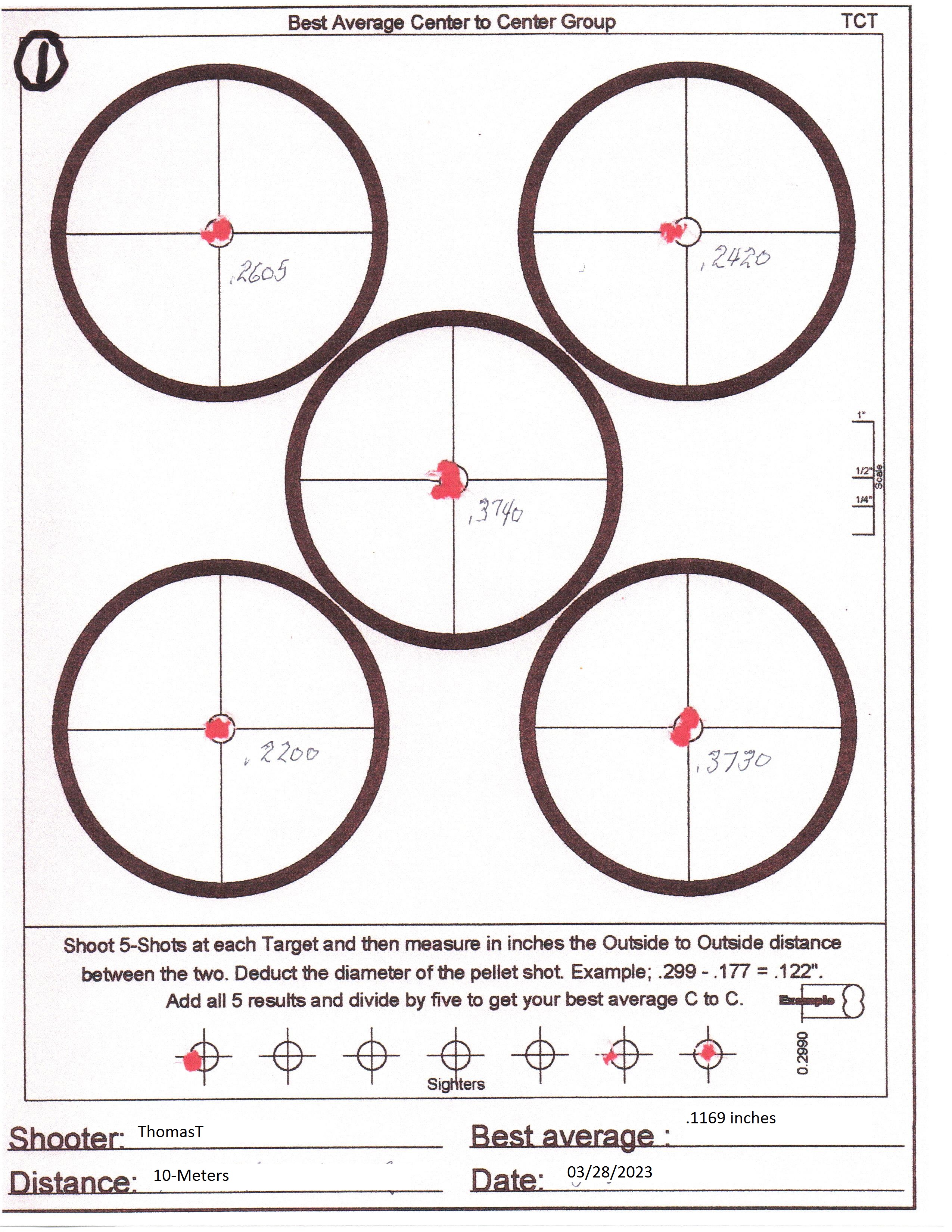

Attached are my first two cards, #1 shot with my Crosman Challenger .177 cal at 10-Meters and the second card was shot with my FX Crown MKII .177 cal also at 10-Meters.
I took extra care when I measured the spread on each group because I want to be as accurate as possible. What I did was scan the Shot Target so that the paper could lay absolutely flat and there would be no movement or change in the hole that I was measuring. Then I wrote the measurement down next too the hole.
Because I plan to shoot a lot of these targets and to make sure I was doing the calculations correctly, I wrote a short program in my spread sheet ( see photo ). Next, I “locked” all the cells on the page so that nothing could be changed by accident. Then I unlocked the cells ( in green ) because these are the variables where your current information will be entered. This program will allow for me to shoot any caliber just by entering that value in the green “Caliber” cell. There are 5 “Inch”cells in green to allow the measured values from the 5 shot targets on each different card. Next to the 5 green Inch cells are 5 blue Result cells ( which are locked ) that show the calculation for the Average Center to Center for that specific “inch value entered”. The program then adds all five of the Results and divides that by five to give you the over all Best Average Center to Center Group that you shot on that card.
As you can see, Target #1 has a Best Average ( 0.116900" ) of just under 1/8" deviation. Target #2 was shot a lot better with a Best Average of 0.028240" which is less than 1/32". As I had stated earlier, this will be fun and challenging for me to improve shooting both of these rifles.

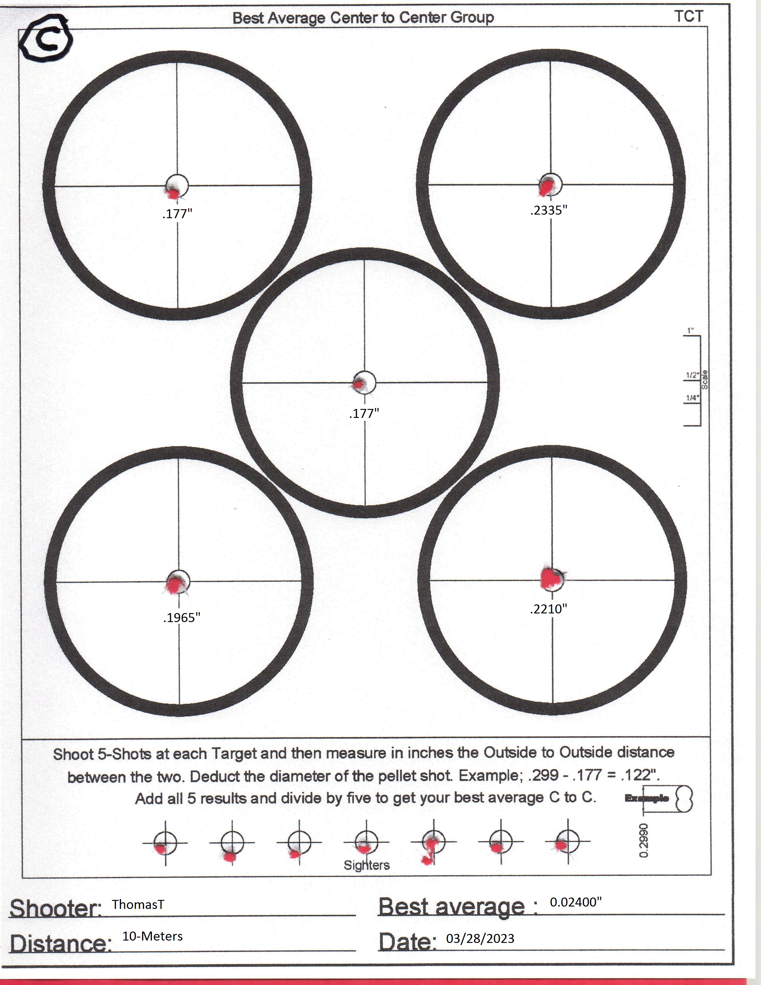

Hello everyone,
Got a really late start today for shooting because of rain and more March winds. Only shot one Best Average C to C Group target and it is not my best. I ate way too much of Uncle Tom's Chili for lunch and it threw off my concentration ( hey I have to blame it on something ), but I might get to shoot more later on this evening.
Best Average Score for this card: .0728" :oops:
