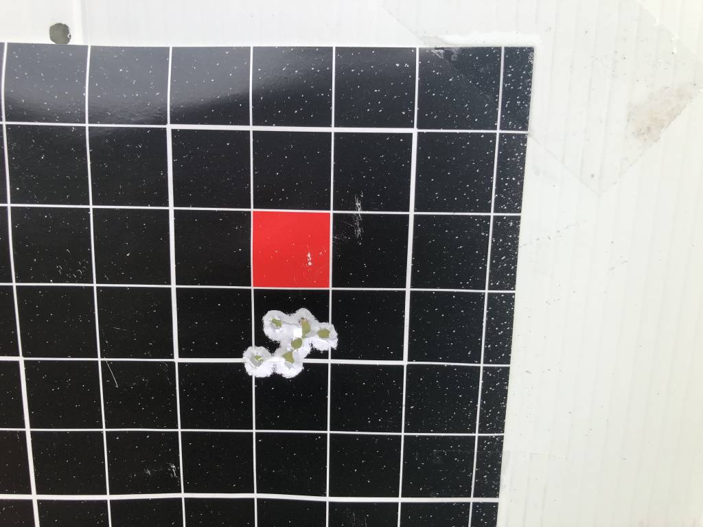

Maybe an answer to most of the problems. Same gun, same pellet,same scope, same target, same "SHOOTER", same bench rest , at 50 yds, etc.,,,only difference is I took the high priced moderator off and shot it with the factory muszzle break. And I was not taking competition form shots and was using the magazine. The picture explains it all I think. Took the moderator off and examined it with a flashlight and could see no clipping. But...
Now its time to communicate with the vendor who highly praised and provided the moderator..

Understand try a different one. I have a few that I can interchange and see if that makes a diffrence. Called the vendor and they said they would send me the guts of a .30 and to try that. Also suggested I put an o-ring over the moderator threads as that sometimes tighten the threads better. It was just a sometimes userful solution he had discovered. Well I knowm now, it shoots as good as I'll ever be able to shoot it without the moderator and just the stock muzzle break. where I shoot a moderator is for me and it's not that loud behind the gun.

Did get the .30 guts for the moderator.. Haven't installed it yet. This moderator already has small holes drilled allong it's sides. Not big holes. Probalby would have trouble putting a straight pin in them but there are quite a few. Ican say abosolutely hole in hole at 25. At 50 not as good. Strange to me but so far I get the best groups with the Hades rather than the diablolo exact. Haven''t ried the redesigned yet.
