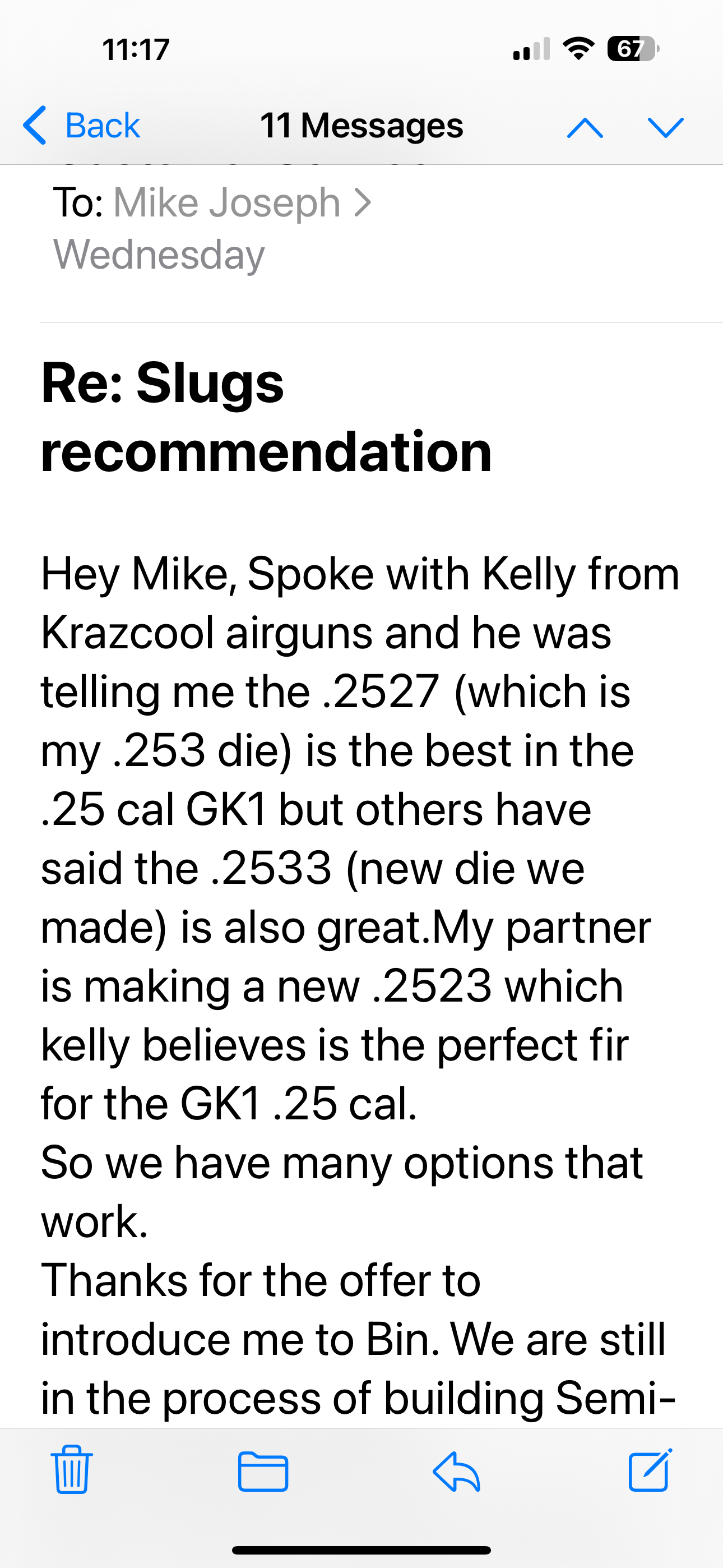

this is an email correspondence between AVS and I in reference to the gk1 slugs. I use the AVS 254 42 flat and they shoot very accurately @ 50yrds. It was recommended by Kelly @ Krazcool because I have the gk1 and the K1 and it works well in both. They fit better than the NSA due to the fact that they are softer (pure lead vs lead W/ antimony).
I hope this is helpful.
