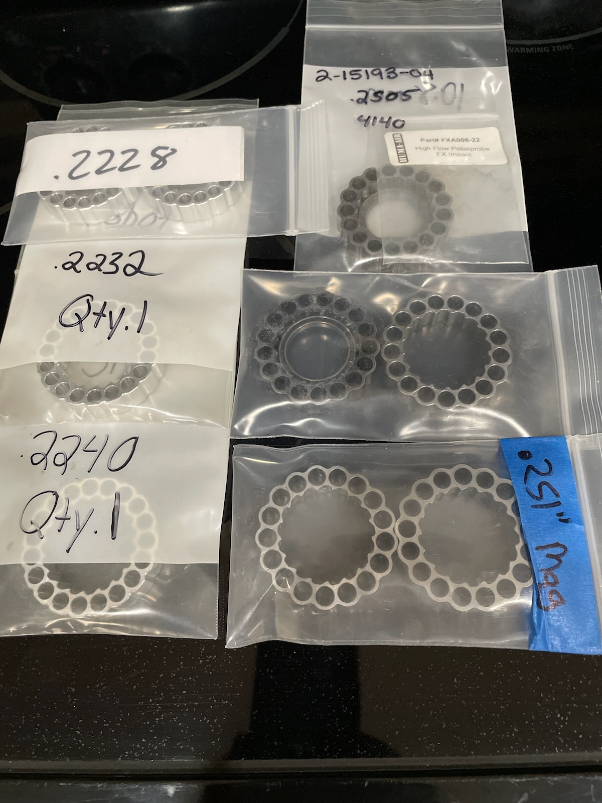

So I put in an order last night with AVS Slugs to have ammo here when my GK1 arrives next week. I got a text this morning from one of the owners asking me if my order was for a Huben GK1. I ended up chatting on the phone with him for a while, really nice guy. He has a GK1 and was measuring the groove diameters of the magazine and barrel. He found they are off by 0.00285". So the magazine is larger than the barrel at about 0.2236" with the barrel around 0.22075". So he actually suggested I try out 221 ammo along with the 223 I ordered, and we changed some weights on my order for the best performance. So I now have 221 ammo on the way I will most likely be a lot happier with.
He also mentioned that they make their slugs with pure lead as opposed to adding hardeners like a lot of the large companies use in mass production. Because of that the rifling bites into the pellets better, but you may notice some lead dust if shooting 223 due to the barrel being slightly smaller than the magazine.

Just be sure that whatever size projectile you use in your Huben (or other hammerless gun) fits the magazine snuggly or you will eventually get jams. This happens if the nose of the projectile can protrude out the front of the mag - remember that these guns shoot from the mag and the mag (and the projectiles in them) experience a lot of g's during firing as they advance and stop. If the projectile bounces forward at the wrong time (as it indexes to the barrel) it can hang and jam the gun. You then are likely facing at least a partial teardown to clear it.
With these guns it is important to size for the magazine . . . . The only jams I have had in over 20,000 rounds in my K1 were from projectiles that were loose in the mag.

Fitment of your mag is going to be based off the size of your mag chambers as they are not all the same. On my K1 the .223 VK fit 1mm into the mag, and my gk1 the .223 VK fit snug sitting just flush

They may be tight, they may be snug. Most likely you're should be somewhere in the ballpark of .221 and .223 you can shoot Huben peanut slugs, the NSA .223 slugs should shoot fine but because they have more antimony than other slugs they will have more friction in the barrel. Varmints Knocker makes .223 slugs and other sizes, he's on ebay AVS also makes different size and weight slugs.
