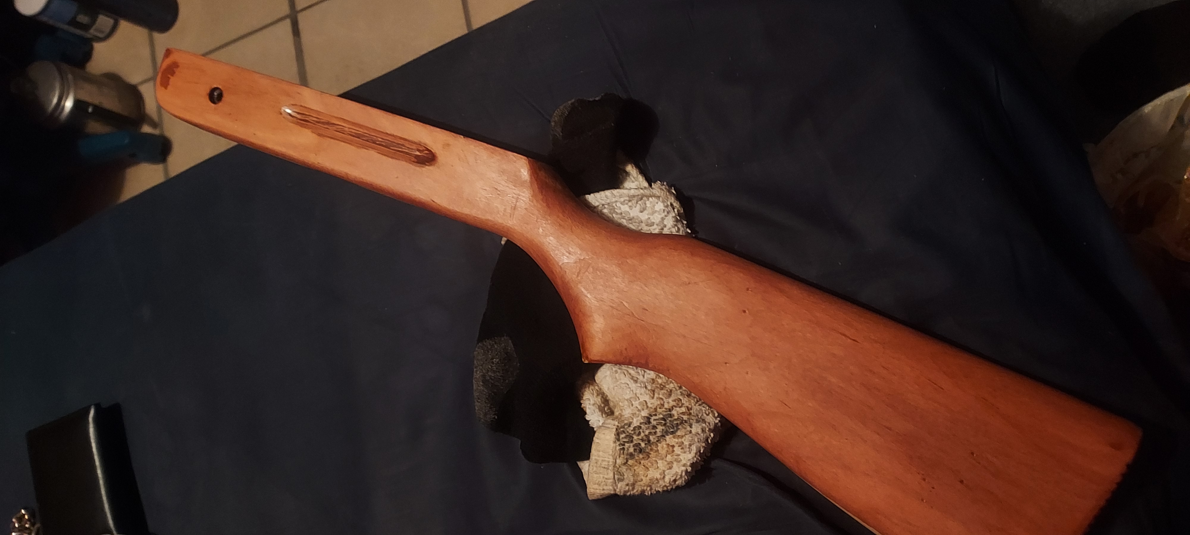

"B" Rifle stock refinish ( iAMzehTOASTY1 )
First try at a stock refinish!😅🥴🫣🤗
I didnt.mind the color. It was the slippery feel in my hands(many layers.of...paint, lacquer?)🤷‍♂️😅
Anywhooose...

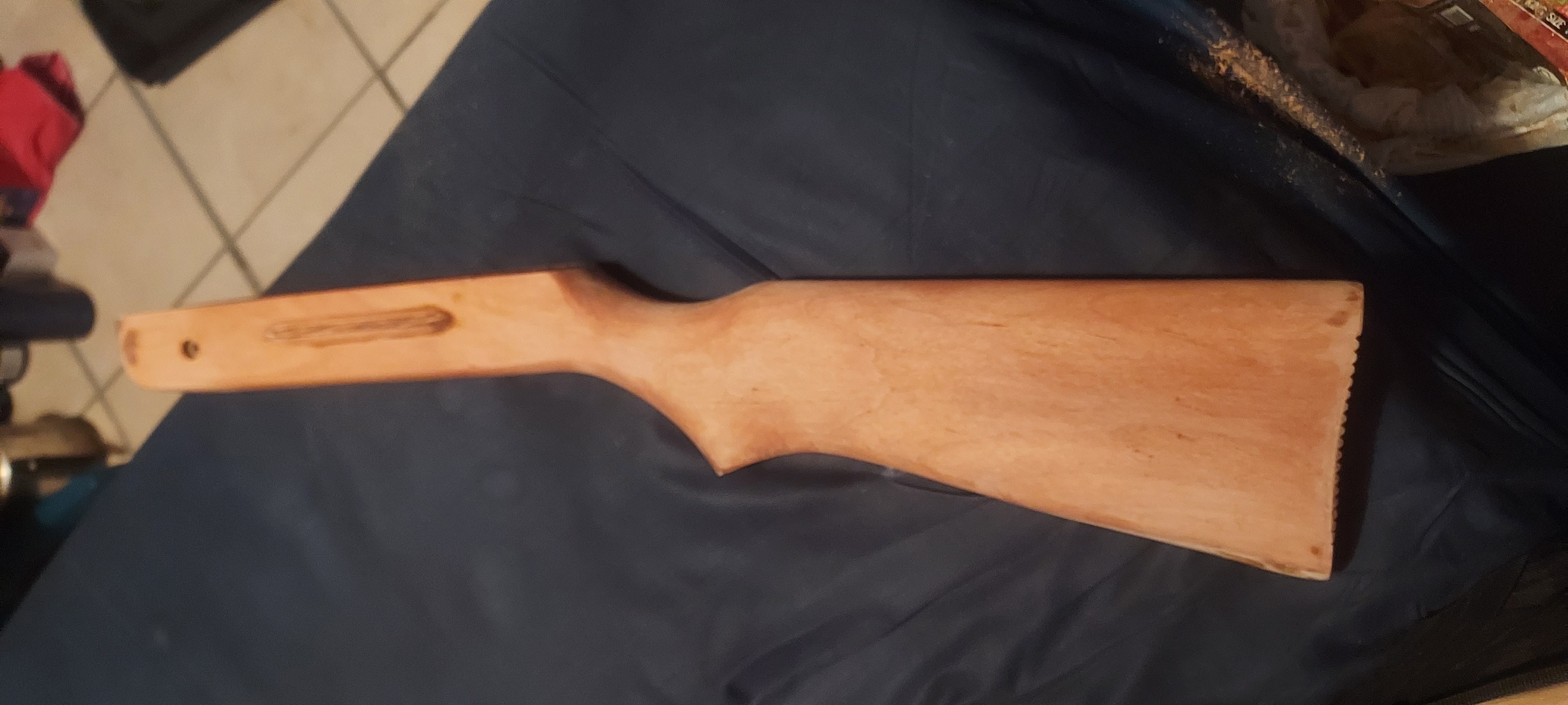

Sanded back to the wood(in most areas)*found some damage(repairs in the wood?) but I'm not concerned about it.
Then cleaned off with a damp cloth.
One coat of Birchwood Casey brand: Tru-Oil rubbed in for a few minutes and then set to dry.
What it was looking like
After the sand and damp cloth cleaning

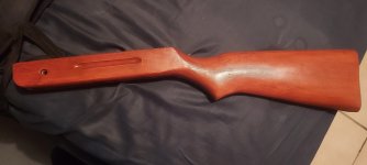

After the oil rundown
It's weird🤔 the wood "wants to stick" to my hands now. Also not as shiny but I like that it shows the "scars" that were hidden underneath; it and I share a common bond😶‍🌫️🎩🤙
Multiple coats of Tru-oil will make it shinny. Lightly hit with 500 paper or 000 steel wool every two coats.
Wait until thoroughly dry or will be tacky.
Any scars that haven't been completely sanded out will reappear once the finish is applied. I usually sand down stocks to 80 or 100 grit to remove imperfections, and then go to 150, 220 and 400 ... but I'm anal too :whistle: .
Thanks! This was just something for me to do really😅 it's dried enough now that the tackiness is gone. Just gunna leave her at that for now and take her out tomorrow for field tests. It's a pass me down so the scars get to stay🤩
Prolly end up putting some more coats of oil on it eventually. Or.something lol idk yet. I did kind of finesse the grip to a more " my hand" fit by sanding a bit more here and there. Overall I am very pleased with the outcome🤪🤙

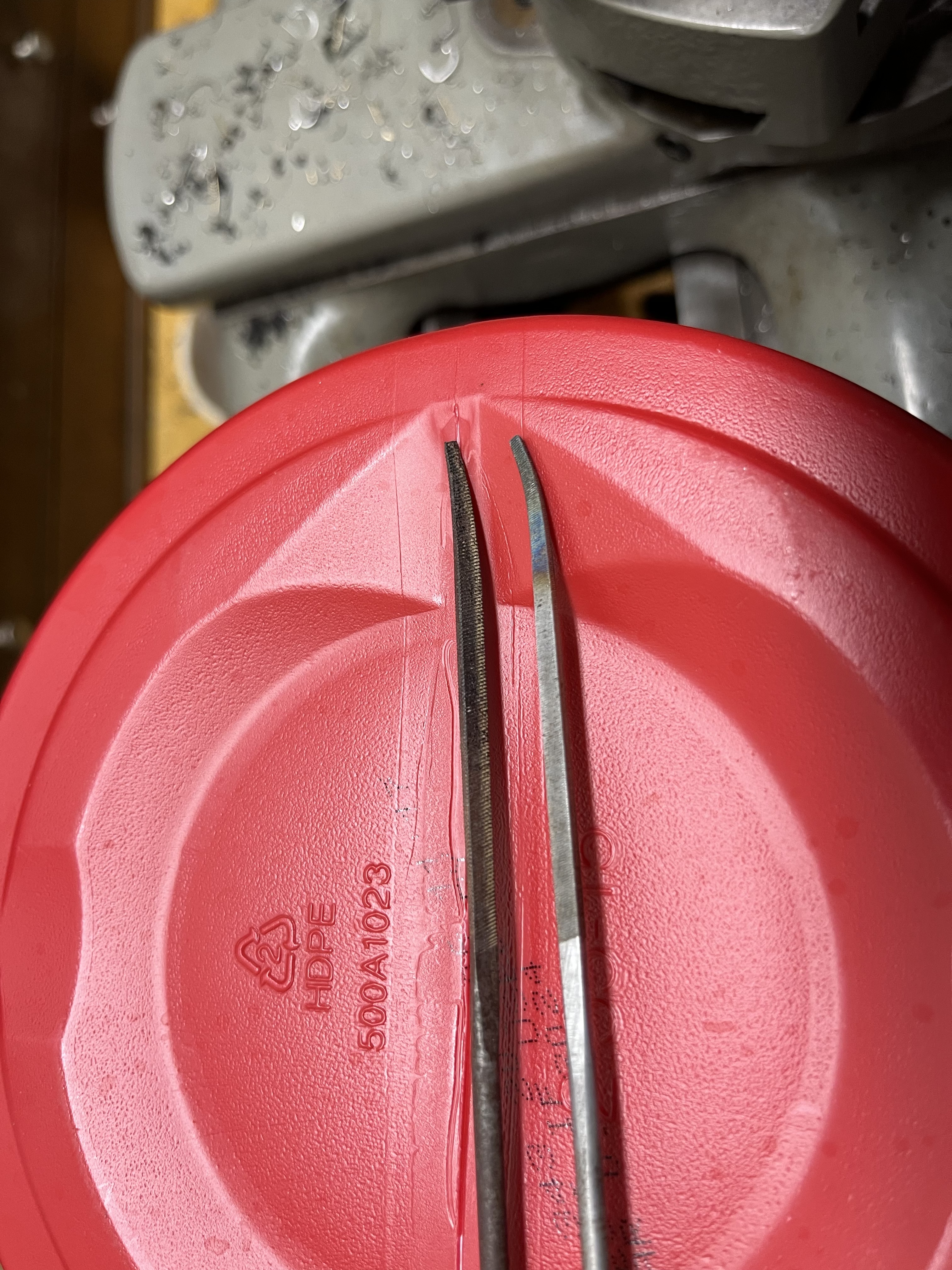

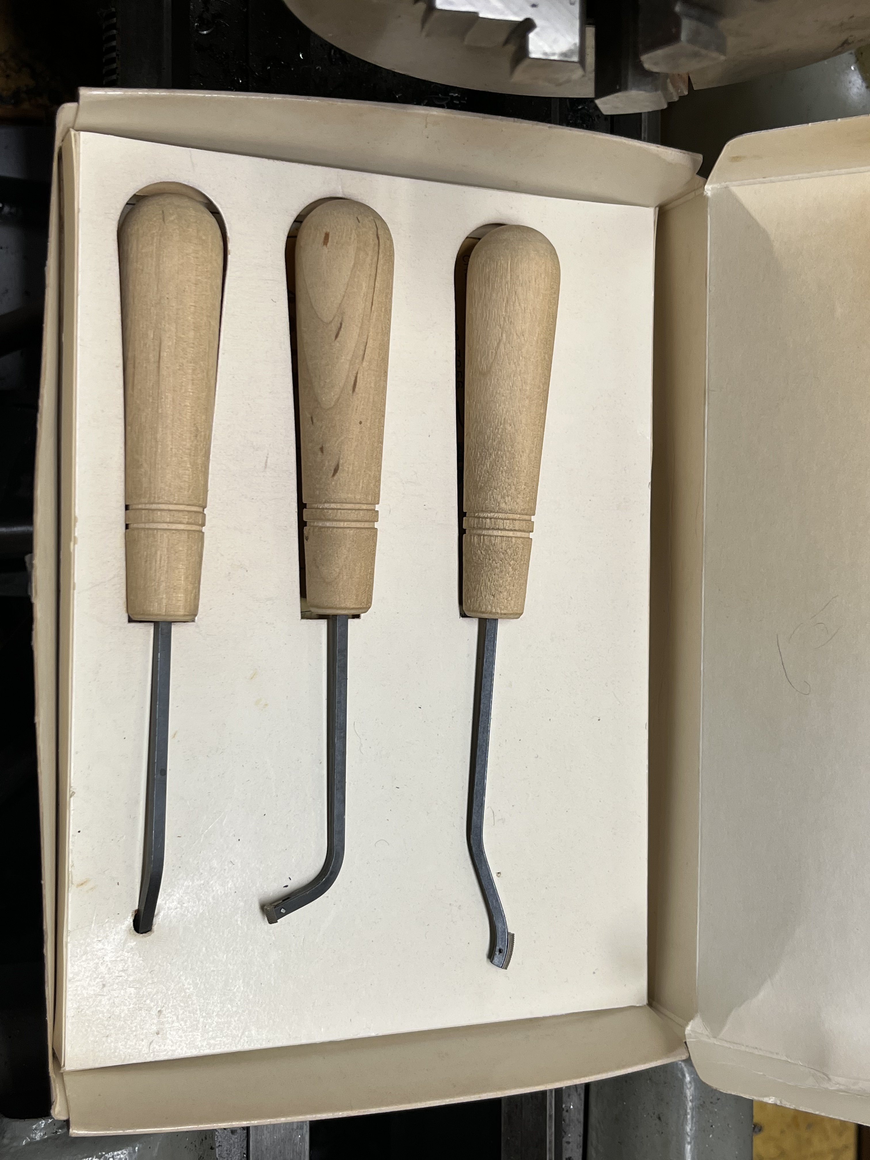

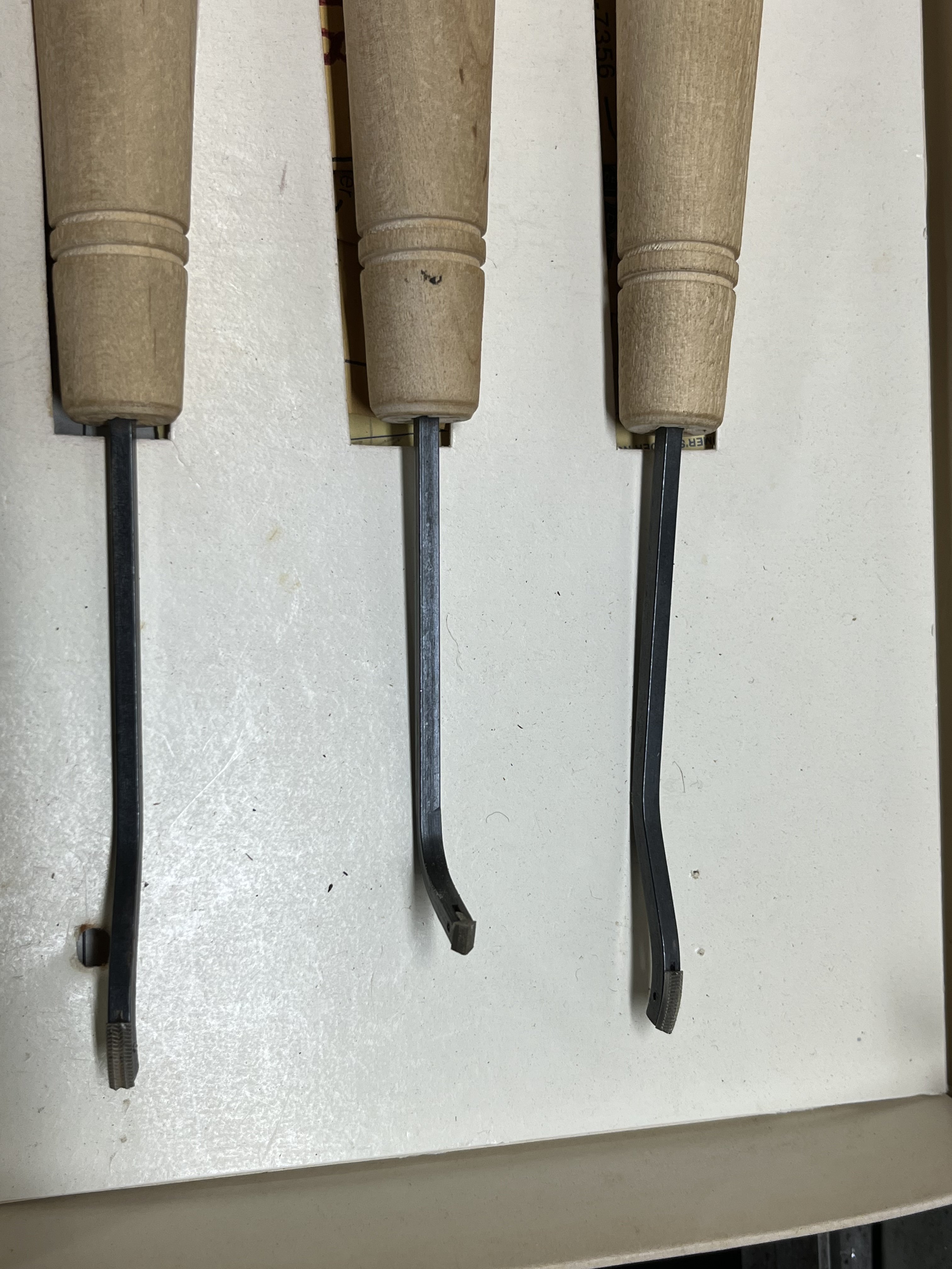

It's not hard to recut checkers. I can tell you how to make your own tools easy. Heat red and curve the tip of a 3 corner and a square needle file and use those to chase them out. Curve the ends like a riffler file. Easy if you're patient and careful.

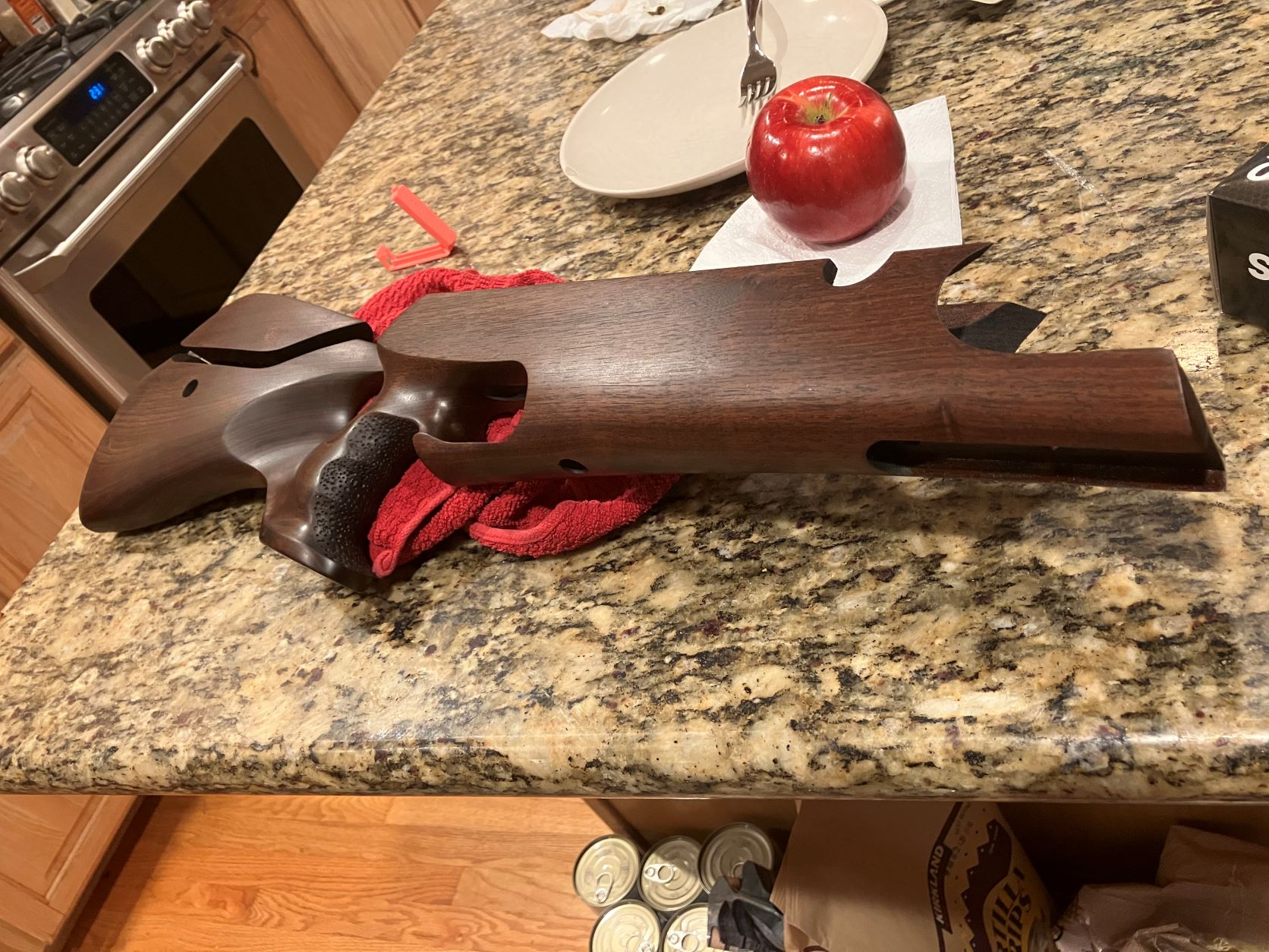

Tru oil can be pretty good once you learn the rubbed dry part. Top gun is Minwax Antique oil. The shiny Stingray is Tru oil. Antique oil is super easy to use and do a sanded in finish. Satin

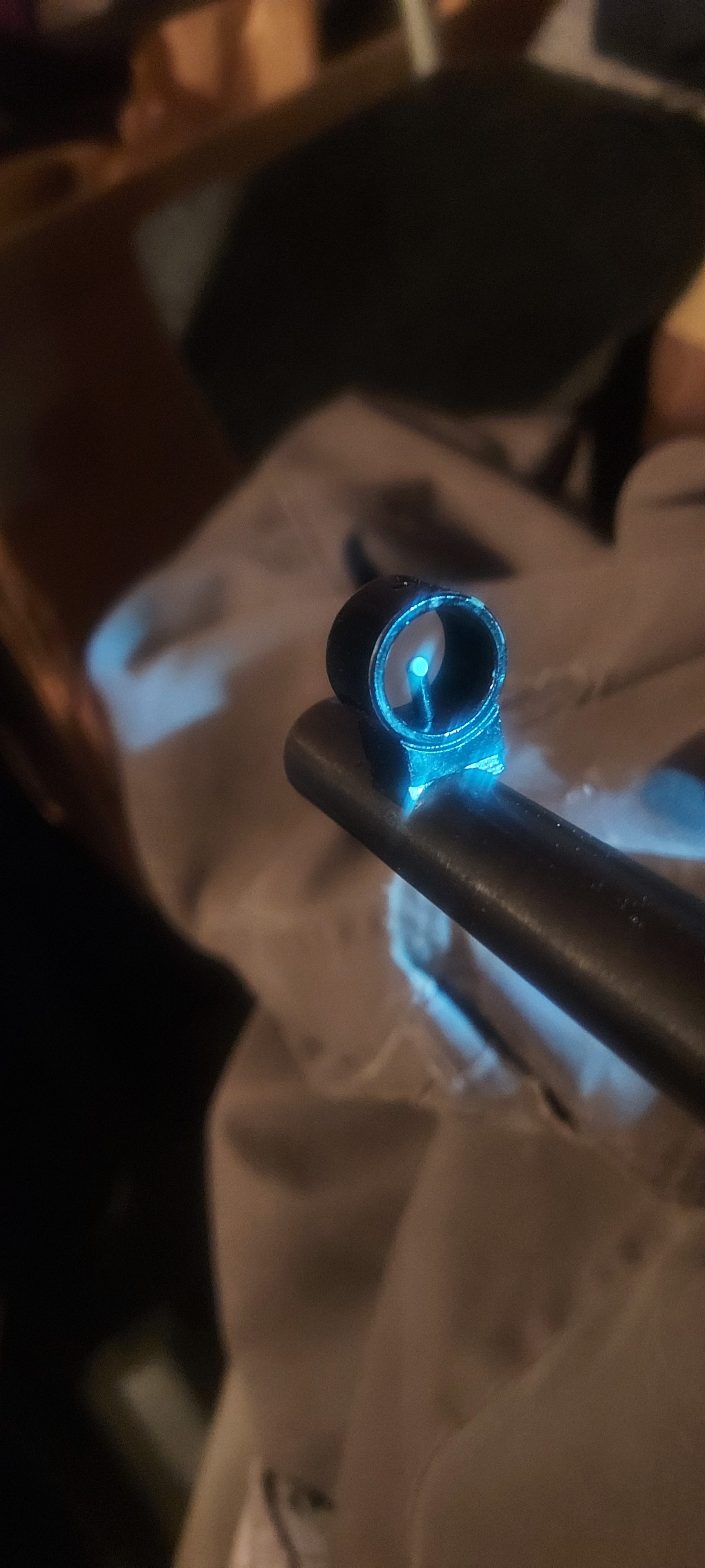

At first I had my ruger scope on it, 2 shots and she popped it off into the sand😑🤷‍♂️ oh well. So I went iron sights on her! And...oh...lordy did she preform!🤩😱💥
She is no prom queen, but she was the ONLY slinger today to hit 100yards WITH 25+mph crosswind/gusts over 45mph.
