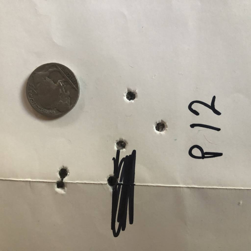

I keep getting fooled by the 23 grain NSA. Every once in a while it comes up with a really nice group. But when the wind picks up at all, they just go everywhere. As of today I have ruled that one out as a possible slug.

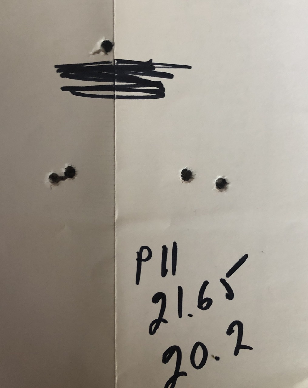

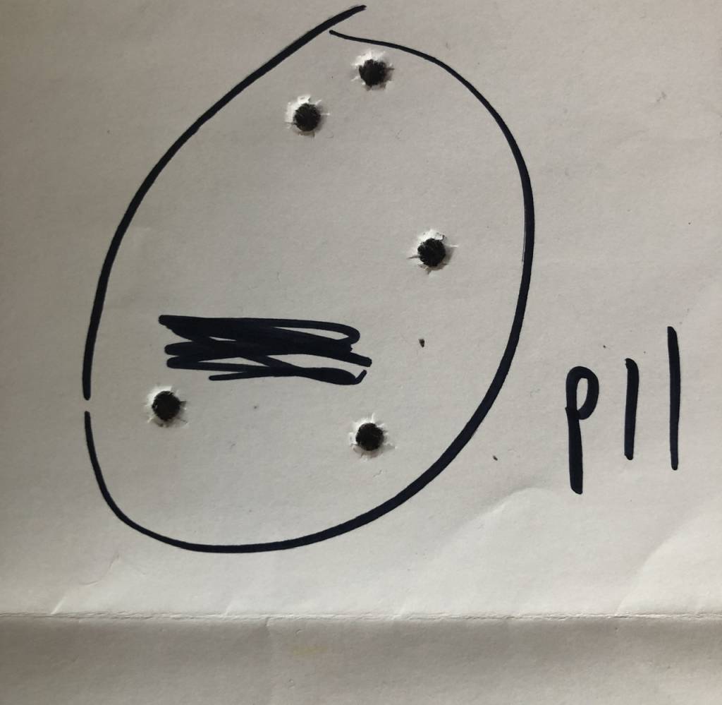

The 20.2 on the other hand seems to perform extremely well. Even when I crank it up to P 12. Take a look at the big sheet first, it shows the power settings that I used going around the clock.
The 23 grain target paper, is upside down. But that’s OK. I had one really good group, and the rest sucked.

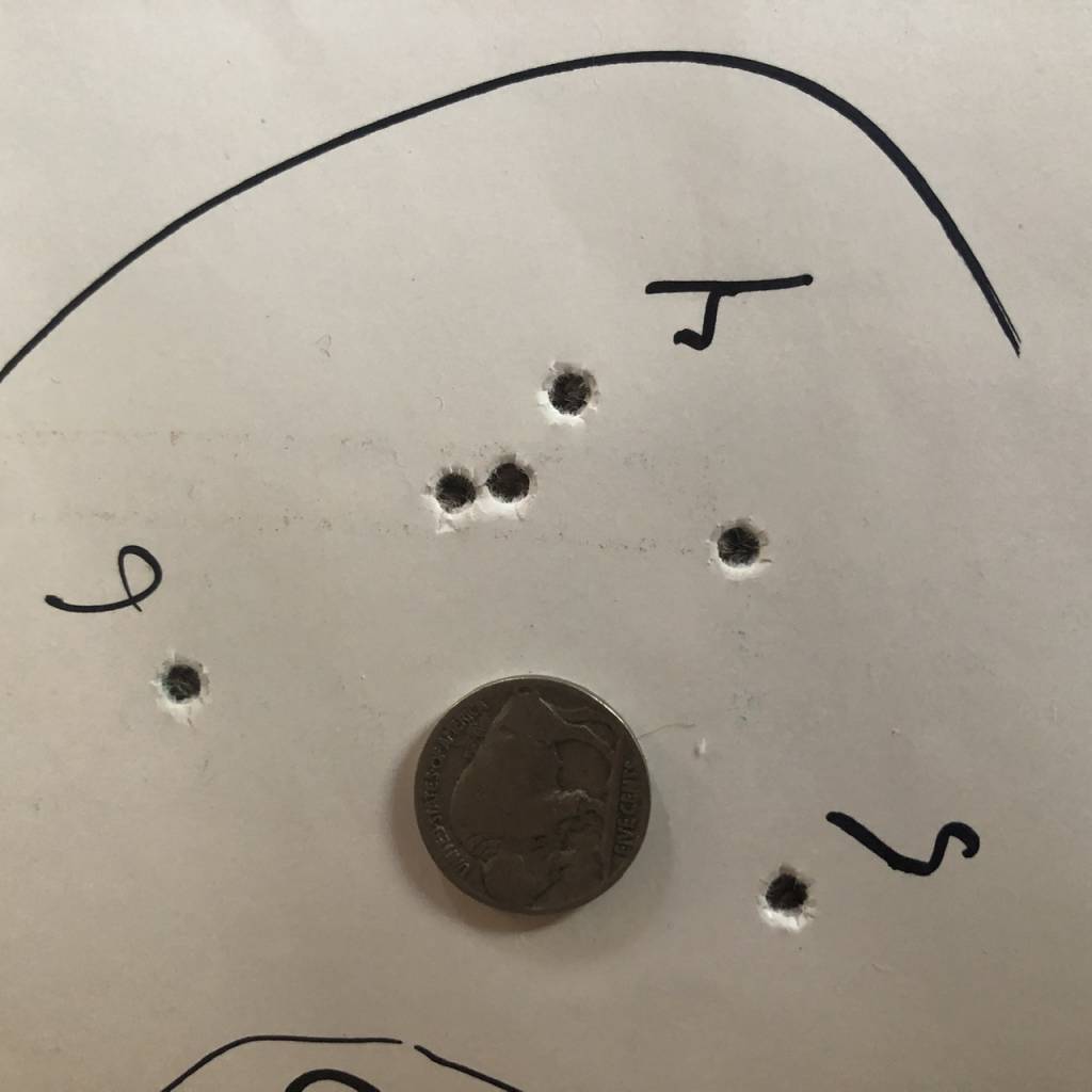

Then I showed some of the best small groups. I had a four shot group at right around an inch, Number five did not snuggle in, but it still would’ve killed a squirrel.
