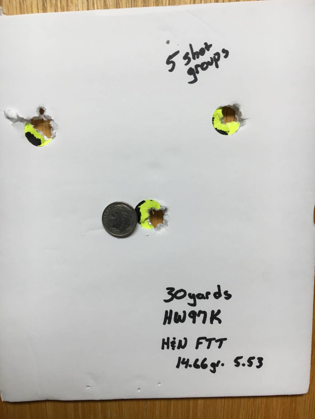

I've no experience with the AA TX200. But by all accounts it is also a fine fixed barrel spring gun. However, I can speak to the Weihrauch HW97K. I use the 97 for small game hunting as well as just target shooting on my small range I have at home. The HW97 is capable of exceptional accuracy.....period. It is a fixed barrel under lever and is a very well built rife. From the bench shooting from bags, the rifle is capable of better accuracy than most shooters I would say. I've put a few thousand pellets through one of mine and never cease to be pleased. I've learned the rifle to the point that if I miss a target, barring the possibility of a bad pellet, it was me that didn't perform.....not that rifle. As far as caliber for target shooting? Not sure I can answer that with certainty, because I use mine for small game as well. Therefor my Hw97's are in .22 caliber. But having said that, I see no issue with the accuracy of the .22 in this rifle. Below is a pic of some grouping that I did with the .22 HW97 maybe a year or so ago I guess, when I was sorting some things out with pellets. The rifle will repeat these groups right now if I were to shoot it. These were at 30 yards, but at 40 it will group pretty close to the same......if I'm up to it and conditions play along as well.

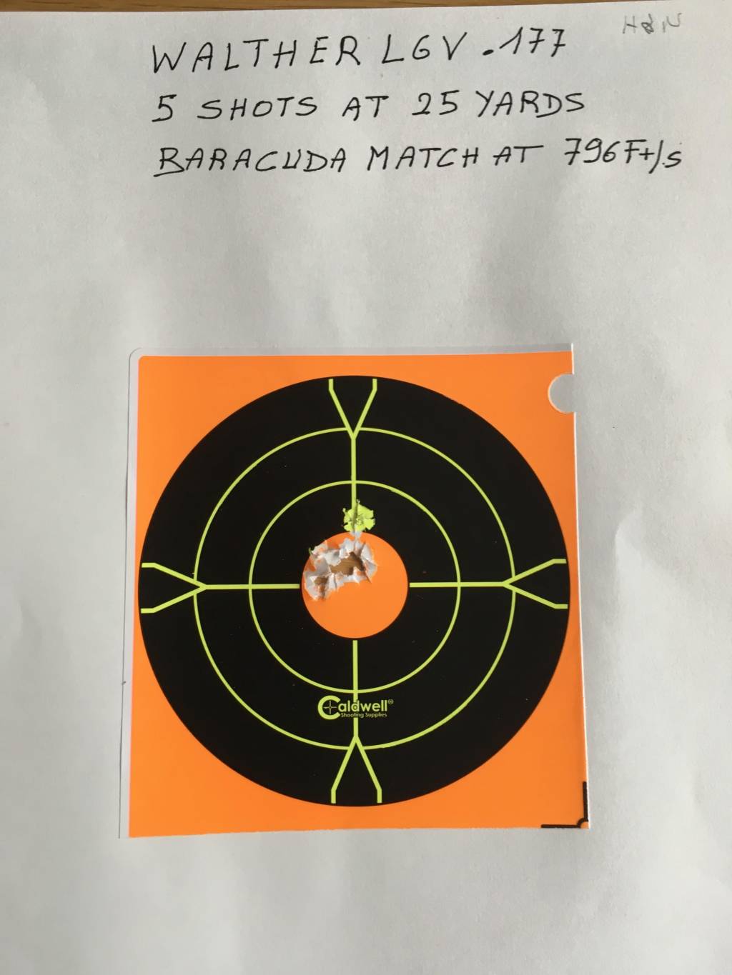

Yesterday I had the opportunity to buy a second-hand Walther LGV in .177 , and here is the result . Pretty good gun for $350 in new condition
