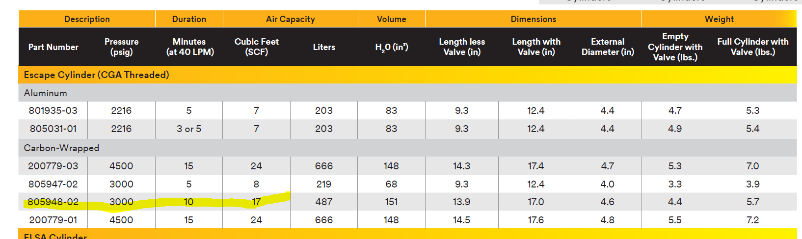

10 min SCBA tank volume = ? Does anyone know the volume of a 10 minute SCBA tank?
I am guessing the volume of a 10 min SCBA tank would be about 10 cubic feet, so probably not big enough for filling the Prod 6 times from 1400 psi to 2800, with a 3000 psi fill on the tank but with a 3600 psi tank fill it would maybe do 10 refills and almost 14 with a 4000 psi fill.

If you're filling up to 2900psi I doubt you'll get 6 fills from a 10 minute, 3000psi tank. In fact I more than doubt it. I have a 15 minute SCBA, 4500 tank (ONLY one I've ever seen! ) in my backpack & I only get 4 or 5 useable refills to pressure in the field with it. The 3K tank MIGHT give 2 or 3.

@Geezerhood, those 10 min tanks you're referring to are only 3,000psi (the ones @qball mentioned) so after your 1st fill you'd probably be below 2900psi. No, I don't have a Prod. Closest thing to it I've ever had was a .22 Mrod.
