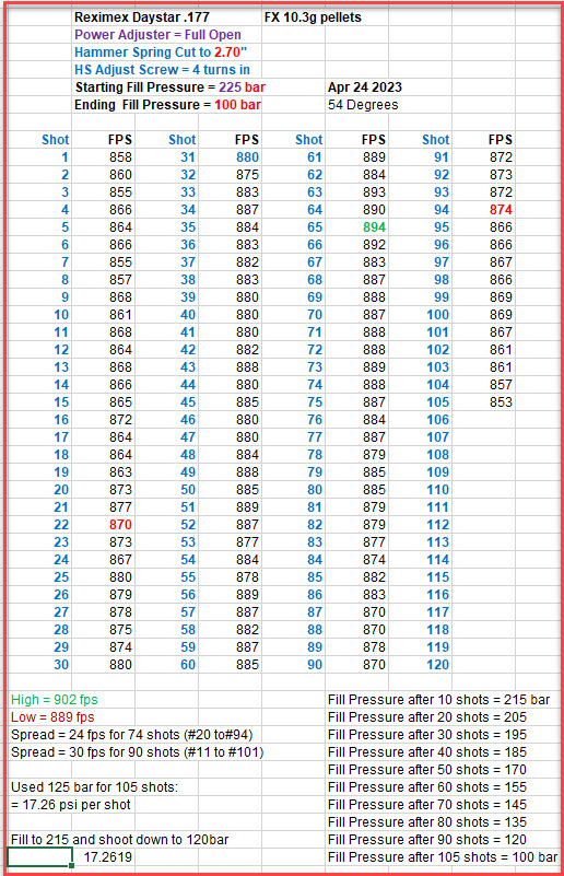

I recommend cutting the hammer spring from the delivered 3.1” (in .177) down to 2.6” . You will get an amazing unregulated shot string.
Because it has a long barrel (600mm) for a .177, this will be about as quiet as you can get without a shroud or moderator.
Even better, it has an externally adjustable transfer port. So you can dial in a great 880fps tune with 10.3g and simply turn the external knob to close down transfer port and reduce velocity to 500fps - when you want it really quiet.
