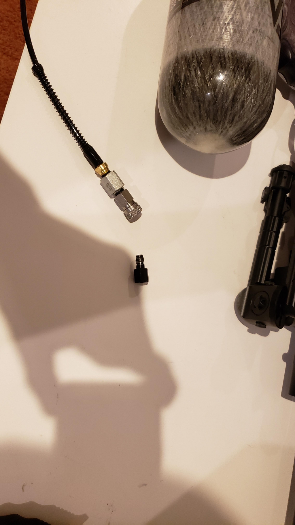

First, it didn't come with an adapter so I can connect the portable tank to the fill probe. Not knowing anything about PCP guns, tanks, air pressure, I had to do a lot of research. Finally, I determined that I needed a Air Venturi Male Quick-Disconnect, 1/8 BSPP Female Threads.
I ordered from Amazon and thanks to their 2 day shipping, I go it today!

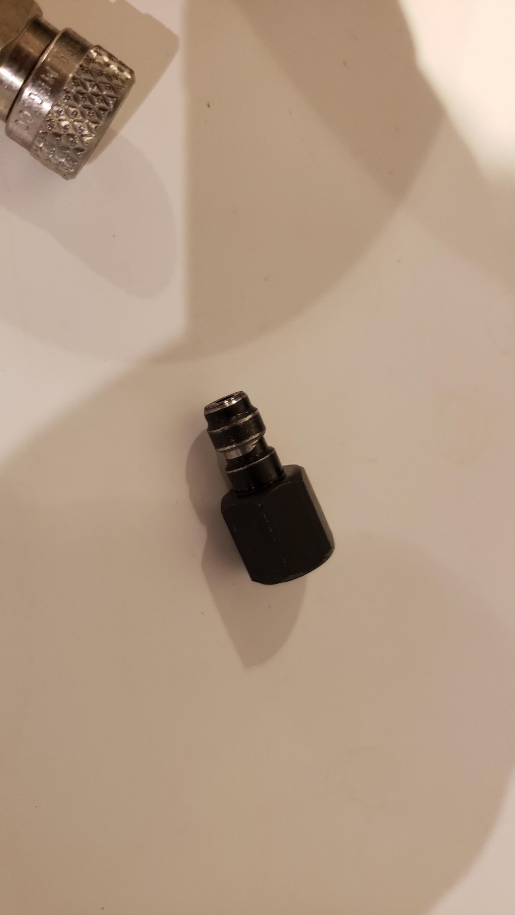

So I screw on the female end to the fill probe. Fits perfectly! The male end going into the female end of the female quick disconnect at the end of the hose, not so good.
It goes inside but the sliding thing doesn't slide back down to secure it. I looked at youtube videos and it appears once you stick it in there shouldn't be any difficulty with locking.
Do I have the right piece? Is there some trick that I don't know?
I really want to start shooting and enjoy this gun. I got my tank max filled and ready to go!
I've had terrible luck with some of the male qd fittings (particularly the PA/AV version) some work in some female fittings, many just don't (for me). I have JB tanks and hoses so I'll only buy these from him now. Every one has fit just fine. I can send you one of my extras if you want. Or, if you can find them (I forget the seller on ebay) you can get a fill plug with the male end milled right in it. But neither will help you tonight.
Yeah, I have some fill probes that are so hard to push into the female QD that I have to put the probe on the floor and push down with the QD while holding the collar open on the QD to get it to slide into place. Make sure that collar is locked into place before attempting to fill the gun or it may come flying back at you like a bullet. When you start filling the gun fill it S-L-O-W-L-Y and you'll be a happy camper.

I had the same problem with my fill hoses. The male ends come in different configurations. Some have a larger locking ring around the probe and if the female end isn't right you will never get it to lock onto the male probe. Take the hose, female QD connector, and the gun's fill probe, to a scuba shop or paintball field shop and you can most likely get what you need to make it fit. It doesn't make any difference whether you change the female or male end, as long as the gun's fill probe screws into the male fitting.

You can plainly see the difference in the male adapters in this pic. It is the same with the female adapters. Even ordering from the same vendor brought me anguish as the China parts would often fail to couple together. So now I just buy USA made Ninja brand fittings and adapters they always fit together and never leak.
None of these fit my female coupler all three have a different sized locking ring.
For some reason, the adapter goes inside and the slide locks with no problem. I don't know what happened, I tried so hard earlier.

Sounds to me like you accidentally discovered that you have to manually retract the sleeve on the female quick disconnect side in order to slip the male Foster fitting inside. Then after you push the two fittings together hard enough, the sleeve should pop back forward under spring pressure to lock the connection. If you're not familiar with these, you may not have realized that you have to manually retract the sleeve before you mate the pieces.
