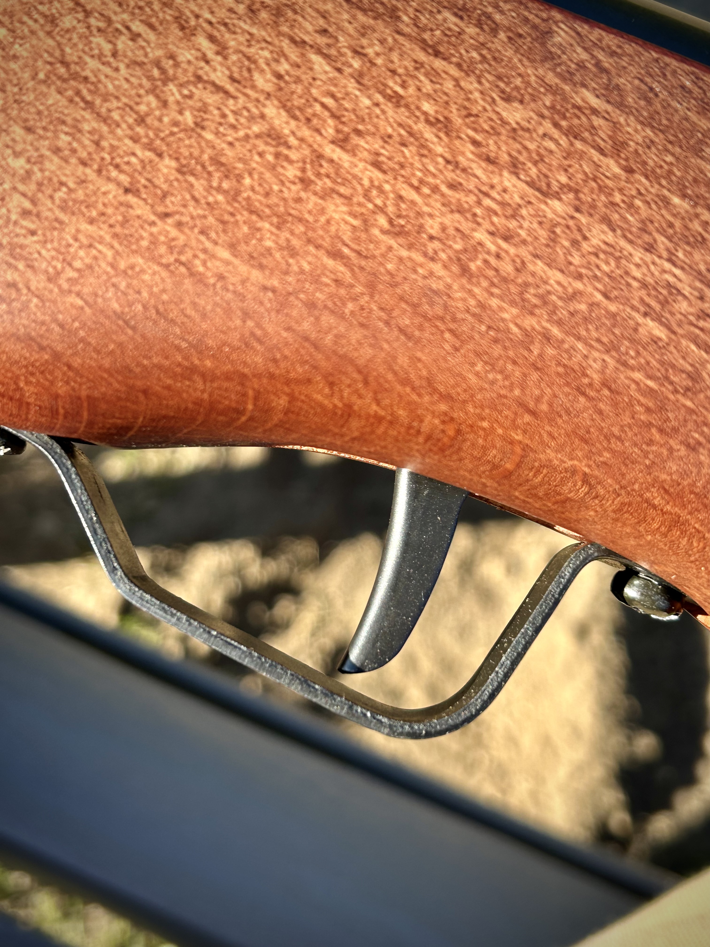

I have the 300 and the worst part about it is the trigger, very heavy in my opinion. It is predictable. Not knocking it but I should look into it because it is a deterrent to me enjoying the rifle like it should be. Other than that I feel it’s a decent value.
View attachment 506669View attachment 506670
The blade on mine is completely different. The mechanism may be the same I don't know.
It's a simple trigger. I haven't taken it apart but it couldn't be to bad. It's really straightforward design on everything.
The spring sits where you can replace it with no disassembly. It's just a coil compression spring.
Mine isn't stiff, gritty, creepy or objectionable in any way.
Reactions: Greenarrow
I wish that I had a pull gauge to measure it. I’m guessing it’s 6-7 pounds to break it. Mine might be an anomaly.
Reactions: Bedrock Bob
That's crazy. Something is wrong.
I have no idea if yours is the same trigger as mine. If it is it takes one second to remove it. Push out the pin and it falls out. There is nothing in there that a skilnny Indonesian kid couldn't make with a file in ten minutes. It's a straightforward 3 link trigger from what I can tell. If it's that bad take it apart. If you can't fix it toss it in the trash and get another trigger pack. I think they are $35 or so.
I haven't taken the trigger apart. It does not look like there's much to it. I would be surprised if it's not easily repairable.
I've had several Hatsans with hard, sticky triggers. Every one had plastic bits floating around getting in the way. Once I cleaned them out and filed off .010 under the first stage screw they have worked great. The Cometa uses much better material and is infinitely simpler. So a fix should be pretty easy.
