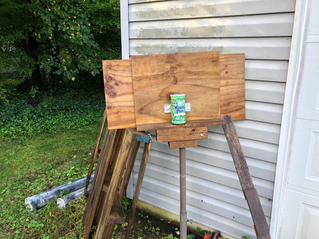

Here's a very simple one I made out of junk/scrap materials last year for some occasional shots from my kitchen window. Plywood backing (2 layers in the kill zone) mounted on top of a thin board for the squirrels to sit on. Empty can about 9 or 10" tall screwed to it that has about 3/4" holes cut out on each side so the squirrels can pick out the feed. Whole contraption was then mounted on an old deck umbrella stand. Some bits on each side to allow the squirrels access up to it. Works great and was basically free. Probably should have stained the wood, though. Wasn't planning on keeping it around this long at the time...but it works so well, it's not going anywhere.

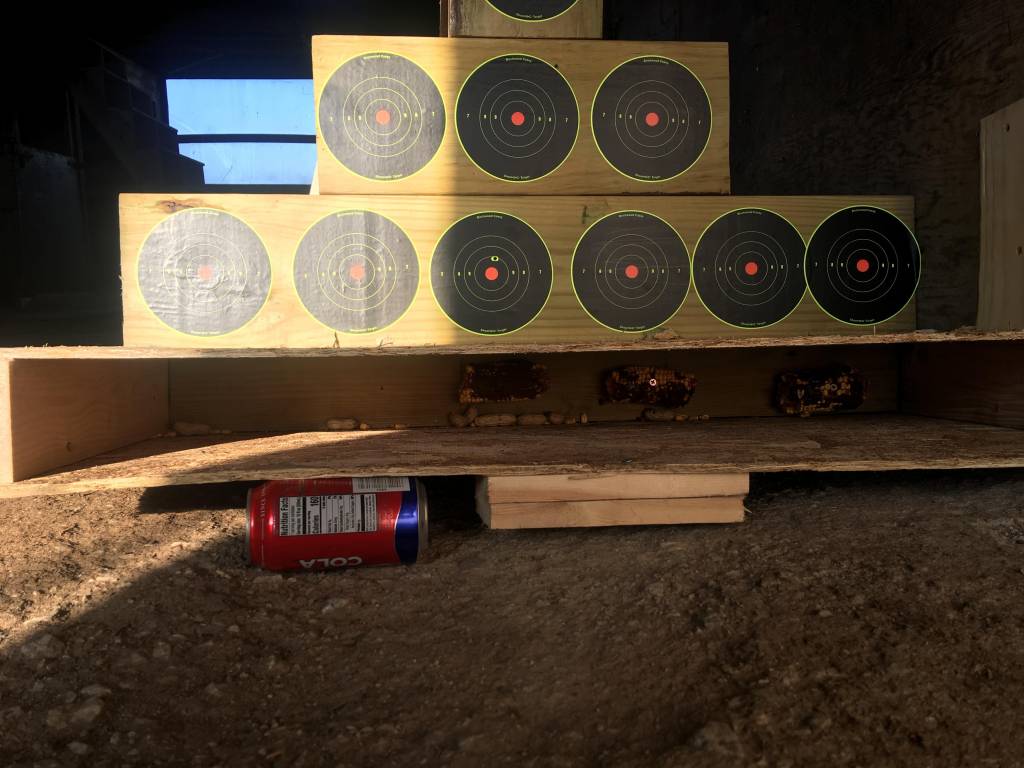

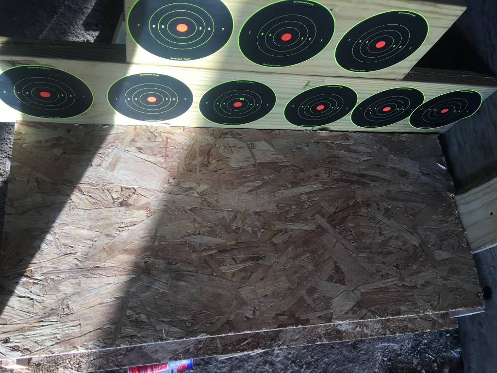

I did this one to save the lives of a couple of opossum And raccoons stealing rat bait.
the top picture is the top with two screws on each side,just unscrew the 4 screws lift the top off put fresh corncob with Nutella spread,😋just a bunch of scrap wood slapped together.Hell you can probably just throw a pallet down and put the bait in it somewhere.Good luck

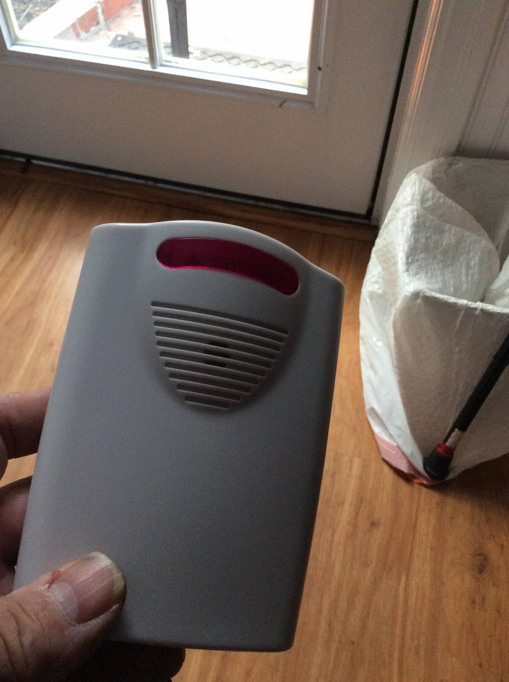

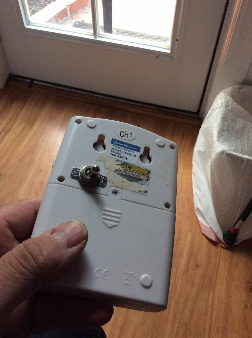

Harbor freight sells a wireless driveway annunciator, battery powered. It is about $18, you can set it up to sense when a squirrel shows up and it will alert you, so you don’t have to watch for them. It will alert on birds too, and larger animals like raccoons too, so it isn’t fool proof, but it makes it easier than sitting and watching.

Harbor freight sells a driveway annunciator, battery powered. It is about $18, you can set it up to sense when a squirrel shows up and it will alert you, so you don’t have to watch for them. It will alert on birds too, and larger animals like raccoons too, so it isn’t fool proof, but it makes it easier than sitting and watching.
These are also great for Hog Hunting I go in and cut the wire to the speaker so just the light comes on set it in my blind and lazy away
Take it one more step, and wire in a on/off switch so you can choose or sound on if need be-

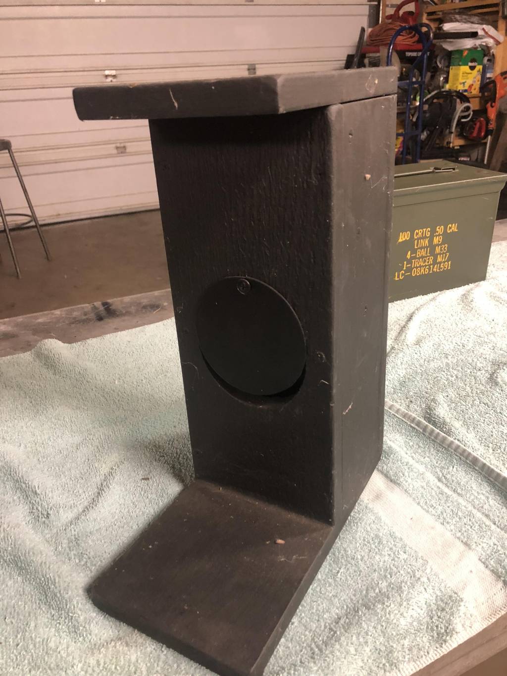

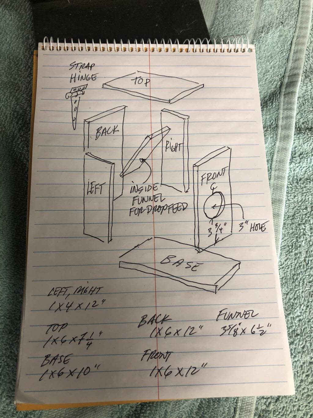

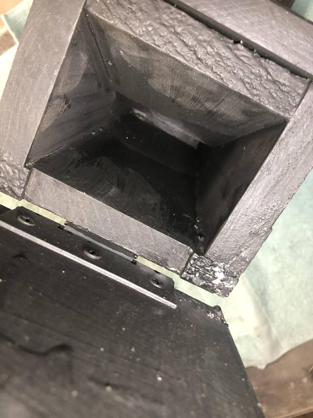

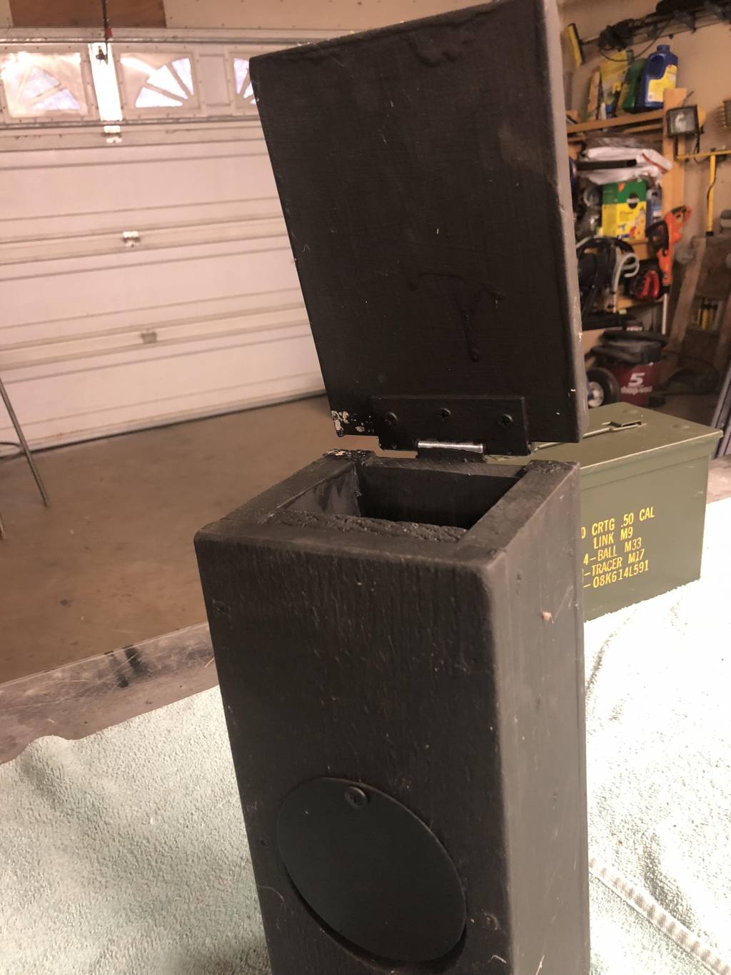

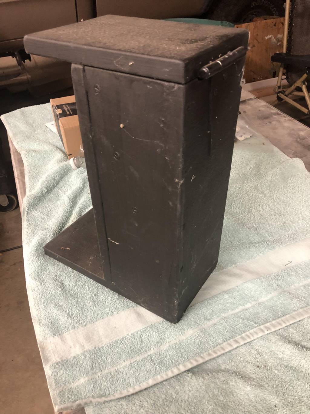

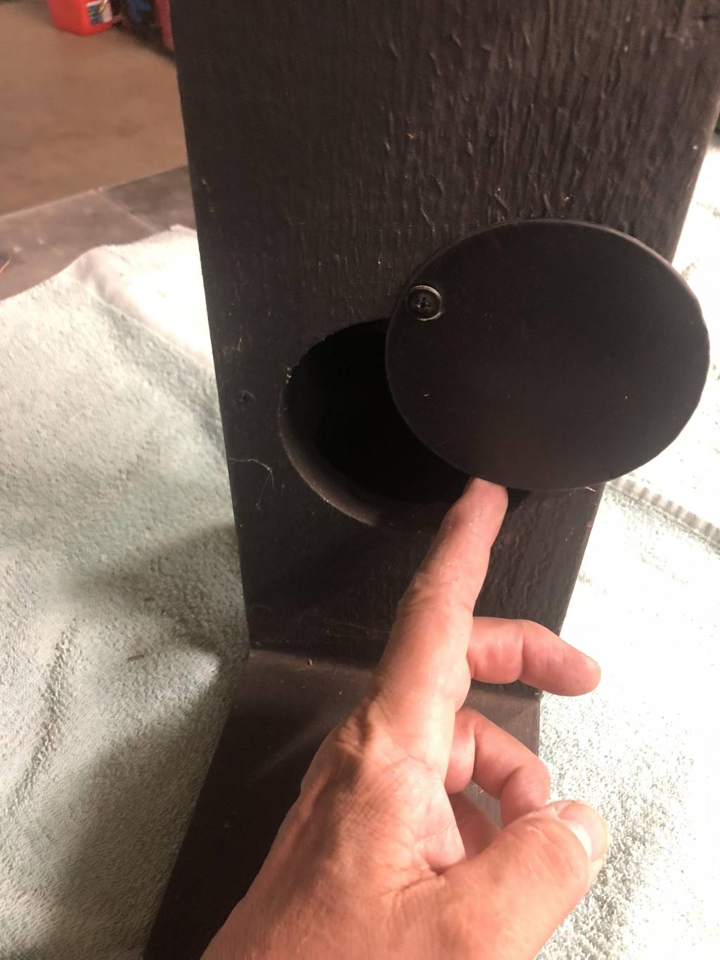

Made this for a friend. The plate is there to stop birds and rats from stealing the peanuts or whatever is used, and at the same time makes the squirrel work to get at the grub . You fill peanuts up top, and that inner piece of wood funnels it perfectly down so it’s a gravity fed design. The gap at the bottom of the funnel guarantees against shelled peanuts logging as its the perfect gap.
The round plate is screwed on loosely so it swings out of the way but always is closed when left alone.
All joints are attached with exterior screws and pre glued.
