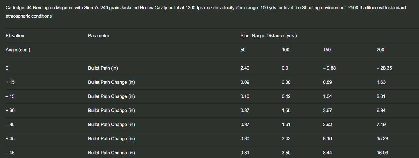

Closest data I found that would confirm your suspicion. With our sub-sonic projectiles I can definitely see gravity acting as either a brake (shooting up) vs coasting with gravity. (shooting downward)
1300 fps 240 grain even at 200 yards sees .38" differe3nce, so I imagine by 600, you'd experience quite a bit more at 1000~ fps with 105 gr.

The above chart is just one of many, but was the closest to sub-sonic they had, and those are not predicted, or calculated, rather real world results.
-Matt
