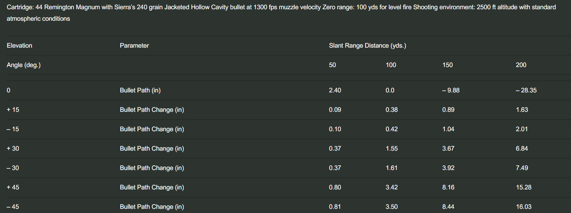

I did a few shots today up a 7 degree incline and a few down a 16 degree decline. In both cases I used my Labradar but only got decent data out to about 50yds. The thought was that the projectile will lose more velocity when shooting uphill as opposed to down hill. Did not see any pattern of that from the limited data.
50yds is too short for that test. I’ll call that test inconclusive for now. The only way I’ll know if it matters is if my shots average a little low for the far uphill shots. And average high for the far downhill shots.

I just replicated this following real world info into the Hornady app...
At 200 yards, Hornady predicts nearly the same change from -15 to 15 as real world results produced...in fact, it was under, and not over.
However, won't bother arguing, suit yourself.
I did not suggest it but asked who is using it as I saw same use it with CF rifles and then tried it myself. Because I broke my wrist and now have same plates and screws in it, I cannot continue trying to see if it really works and was curious is somebody else tried it with air rifles with any success.
Besides, what does that has to do with comparing and evaluating a app?
Hornady app calculated .22" change from -15 to 15 where real world tests were .38"....where Sterlok shows 0" with the above data on the Sierra 240 gr going 1300 fps at 2,500 altitude.
Think Hornday got a little closer than Sterlok here...and for a free app, if you wanna complain, feel free. If you want better results, there are paid apps that use 6DOF, ranging from $150 to $800.
