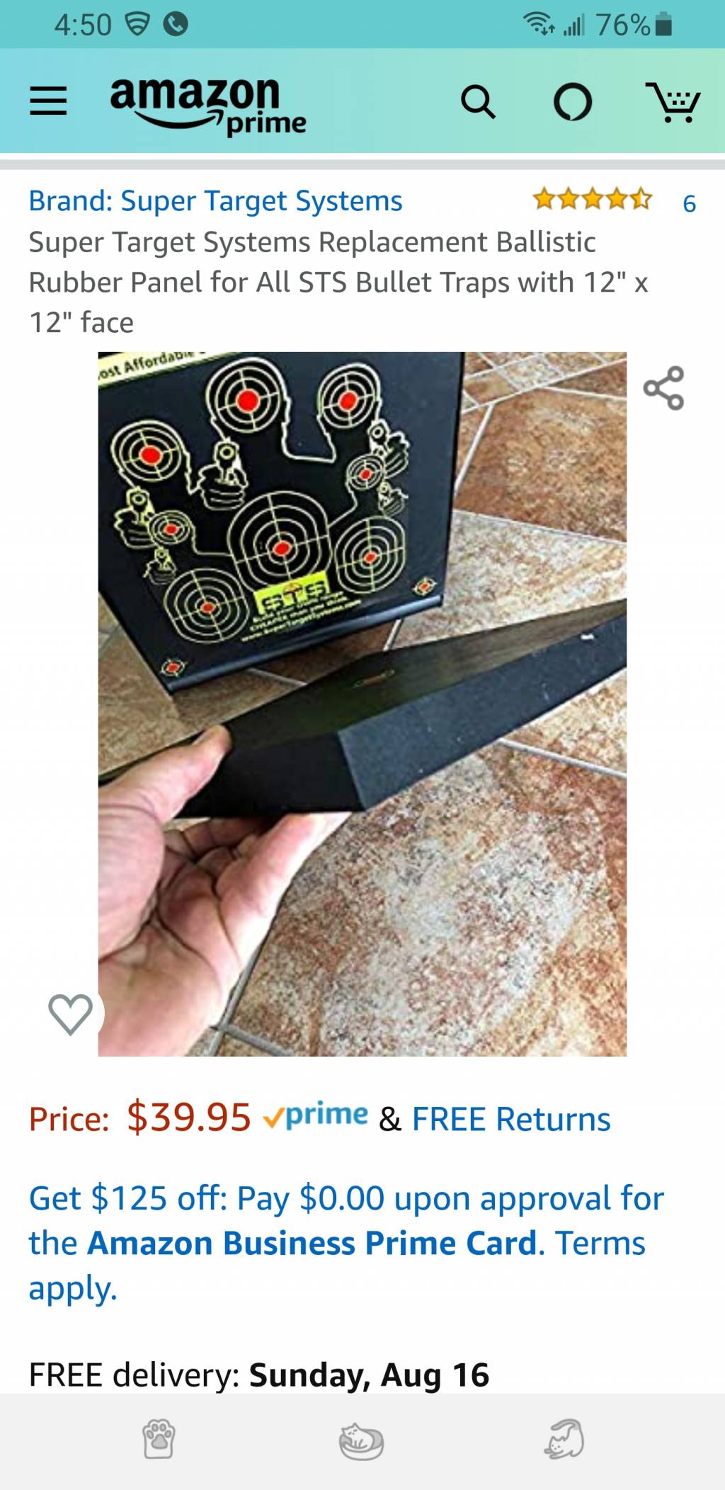

So I bought this ballistic panel for my indoors bullet trap.
It feels heavy and solid, not glued chip board.
My 2240 bounces pellets off at point blank.
My pp800 at point blank seems to enter (don't know if it exits). But at 20 ft the pellet bounces back 20 ft straight to me.
My aea bullpup no problem.
The company super Target systems never responded to my question.
Can you engineer gunners help with educated guesses? What is the minimum range fpe so I don't have to worry about a ricochet breaking my sliding door?
It is 1" thick. It feels 5 lbs, but Amazon says 3.

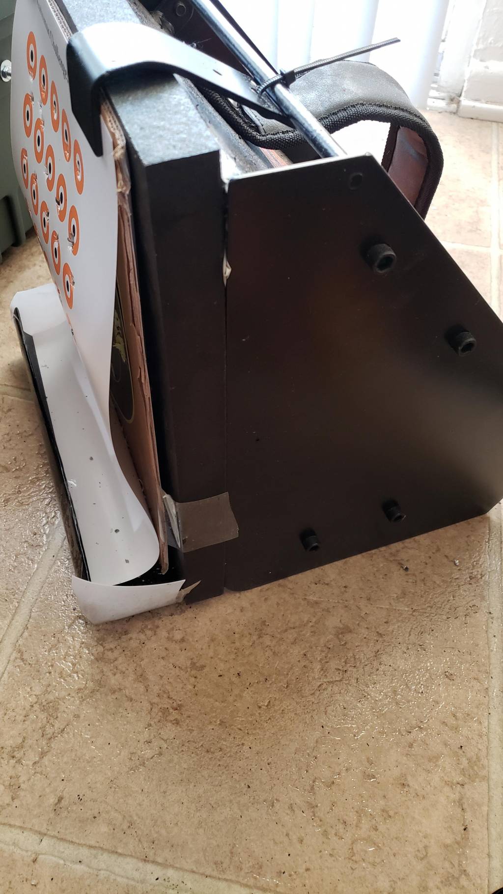

The panel I am asking about is the cover, not the whole trap. I tape my Target to the ballistic rubber. Which is mounted to this trap.. which I customized. Took off the humongous internal lip which was blocking the pellet landing zone in the trap
I lined the inside of the trap with ballistic putty. So, high end power I feel fine. The low end is my question.

This is the modded trap I have been asking for..
With the ballistic panel, putty and steel bullet rated trap I think up to 100 fpe is contained. The crosman trap I had previously, was destroyed by my cricket and chronying my pp800 at point blank.
