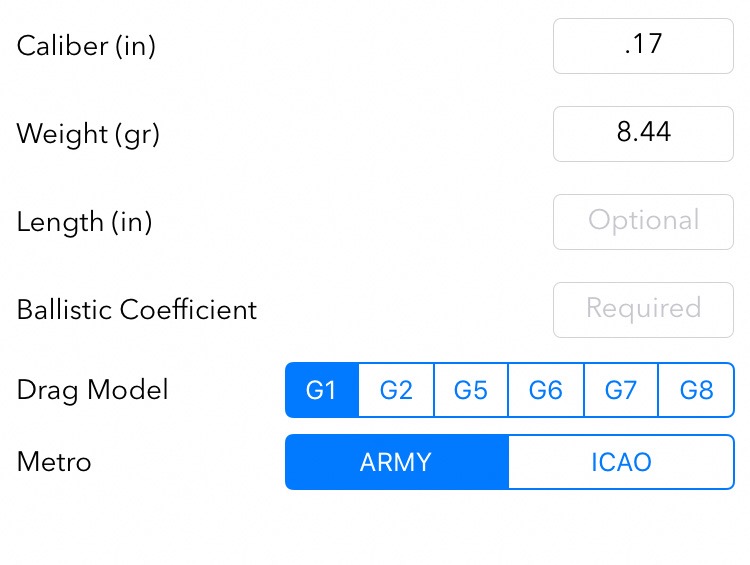

On Apple, I already have the paid version of BallisticArc for my powder burners. IDK if it might be possible to make it work if I can manually enter the projectile data. But I need length, ballistics coefficient, drag model, and metro information for the JSB exact 8.44 gr and JSB exact monsters. Any idea where I can find that data?

I found some ballistics coefficients online. The 8.44s are reported to have 0.027 and the monsters have 0.035.
If I can’t get BallisticArc to work for pellets, I noticed there are some online ballistics calculators I could access from my iPhone (my friend has an android, but I do not). Any experience using those? Pellet Path says it does not even need a ballistics coefficient. I guess it starts you out with a default value and then adjusts it based on your input results.
