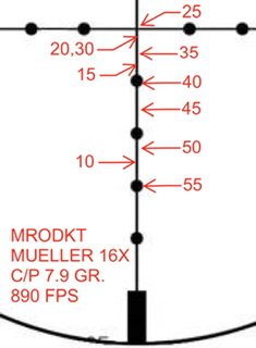

Sounds like you are trying to map out your dope sheet for Hunter Field Target.
I think you already know those programs are going to give you an approximation.
Ultimately, you are going have to shoot paper to verify those numbers. Keeping in mind how you rest the rifle is going to affect your POI. Especially in a FT position and shooting springers.
Since you'll be shooting paper anyways...why not skip the ballistic program predictions and just shoot paper.

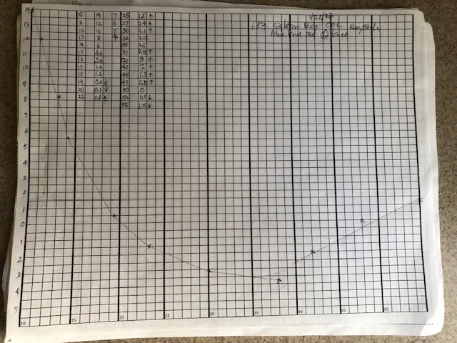

With a graph/plot dope method, minimally, all you need to verify your dope are 5 distances. you need to shoot exactly at 10 and 55 yards. Then approximately at 15, 25, 40. I then extrapolate my drops at other distances from the graph.
In my experience constructing a dope sheet for my TX 200 for WFTF piston, that should give you enough information to start. I started shooting by clicking my elevation turrets. Lately, I've been switching to shooting with mil-hash. I find more psychological comfort in shooting mil-hash (similar to hunter FT) as I'm not changing any vertical turret adjustments. (don't get me started on click lags...that's a whole other topic)
