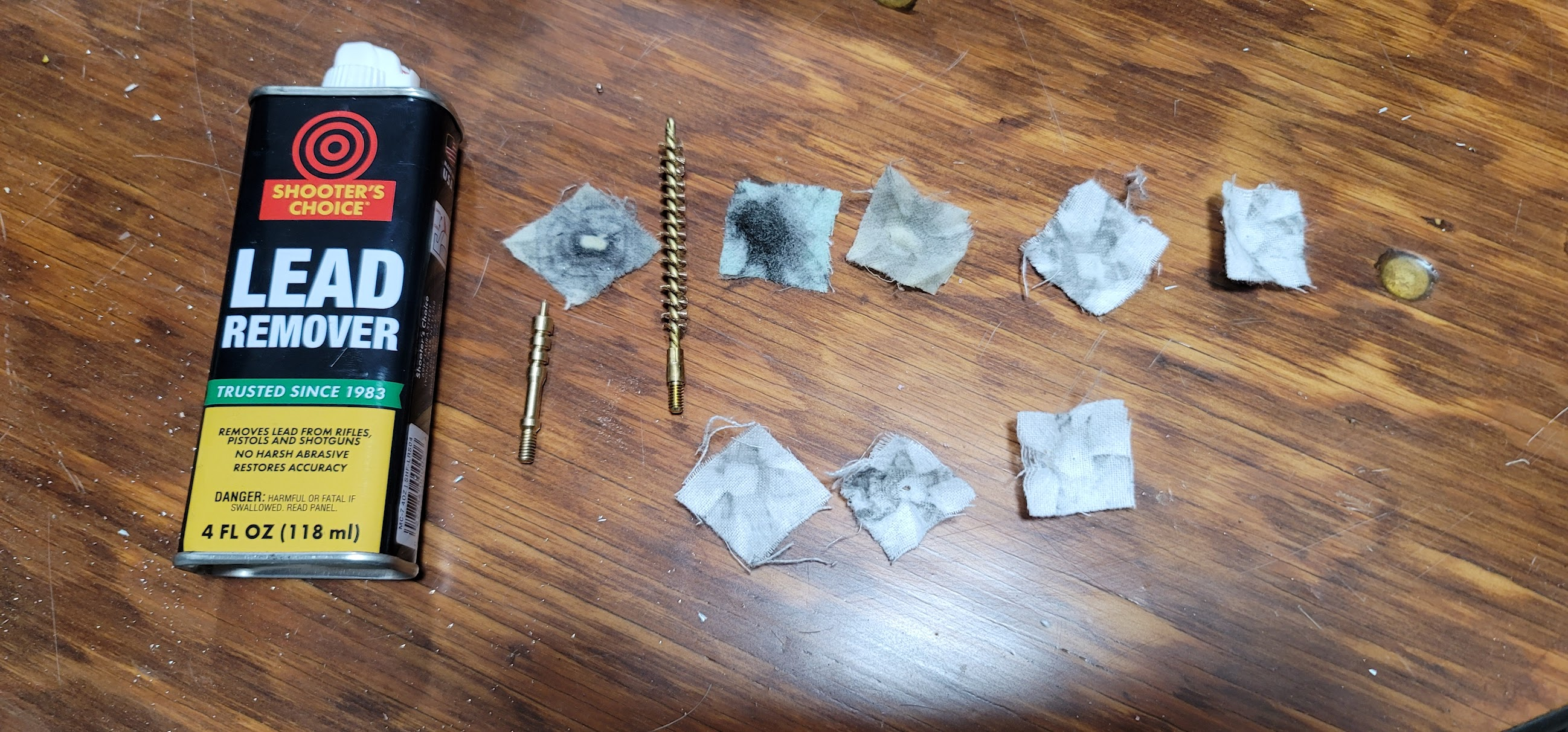

I tried the shooters choice Lead Remover. Wet a patch, scrubbed to bore a bit. Followed up with a wet brush, then a series of dry patches and 1-2 more wet ones in the mix.
Most of the lead seemed to come out on the first wet patch, then the patch after the wet brush.
I'll have to use it a few more times to get a good feel for how it compares to ballistol. At this point I do not see any reason why not to use Lead Remover.

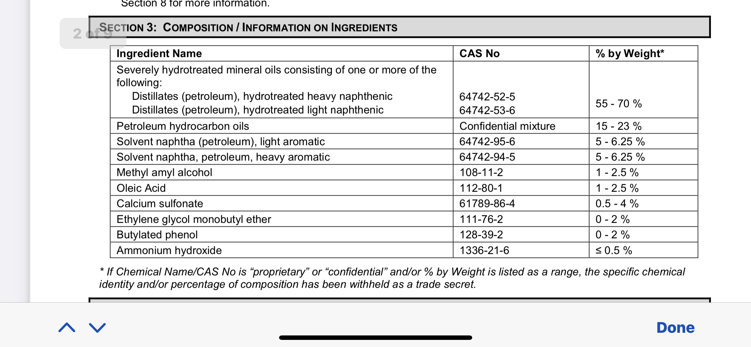

Does SC degrade O rings?
I’d say yes, if used remove all o rings.

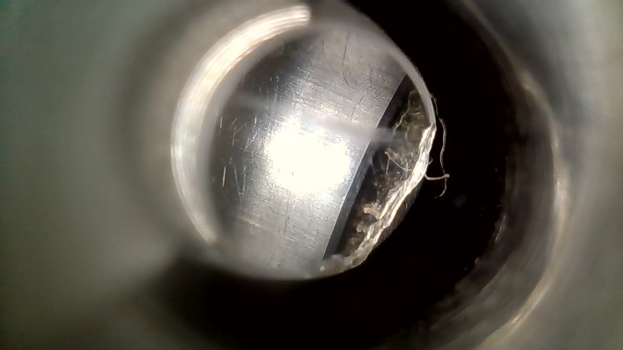

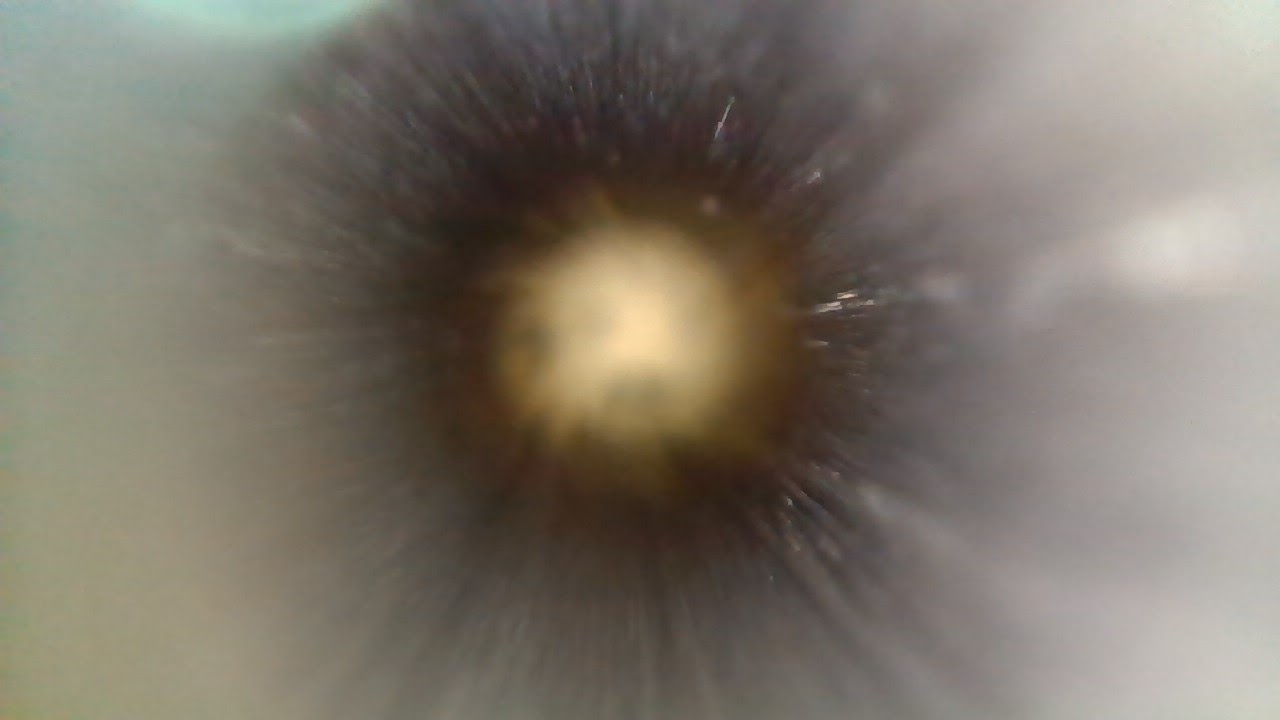

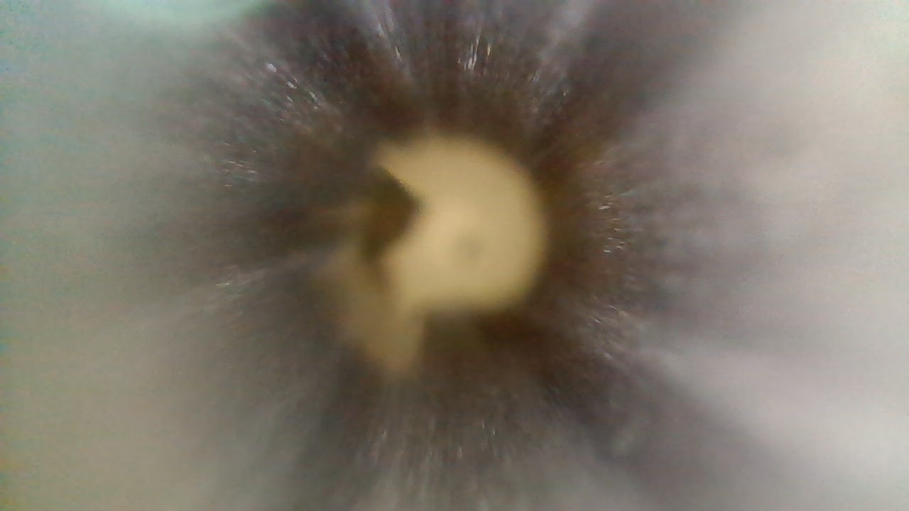

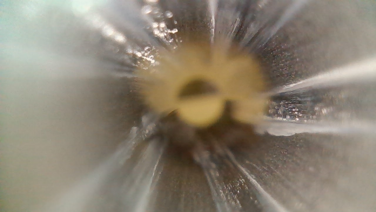

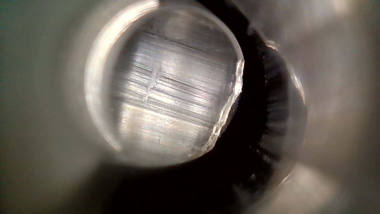

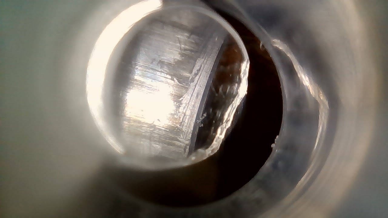

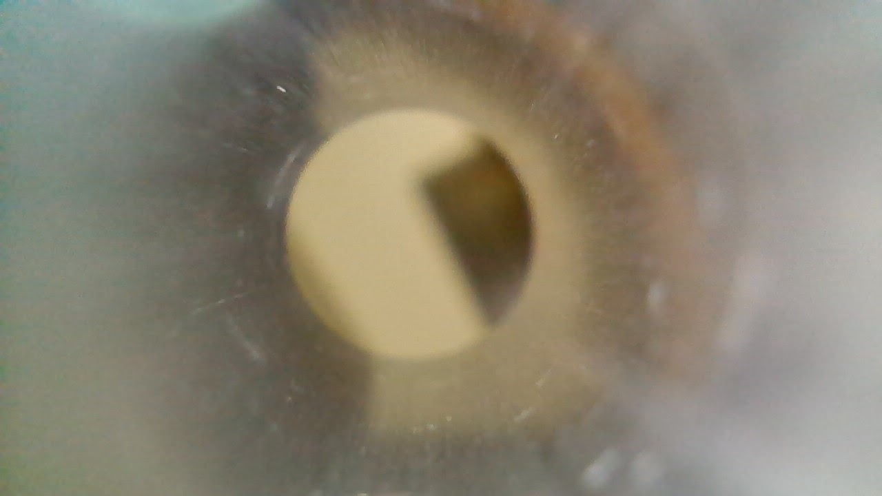

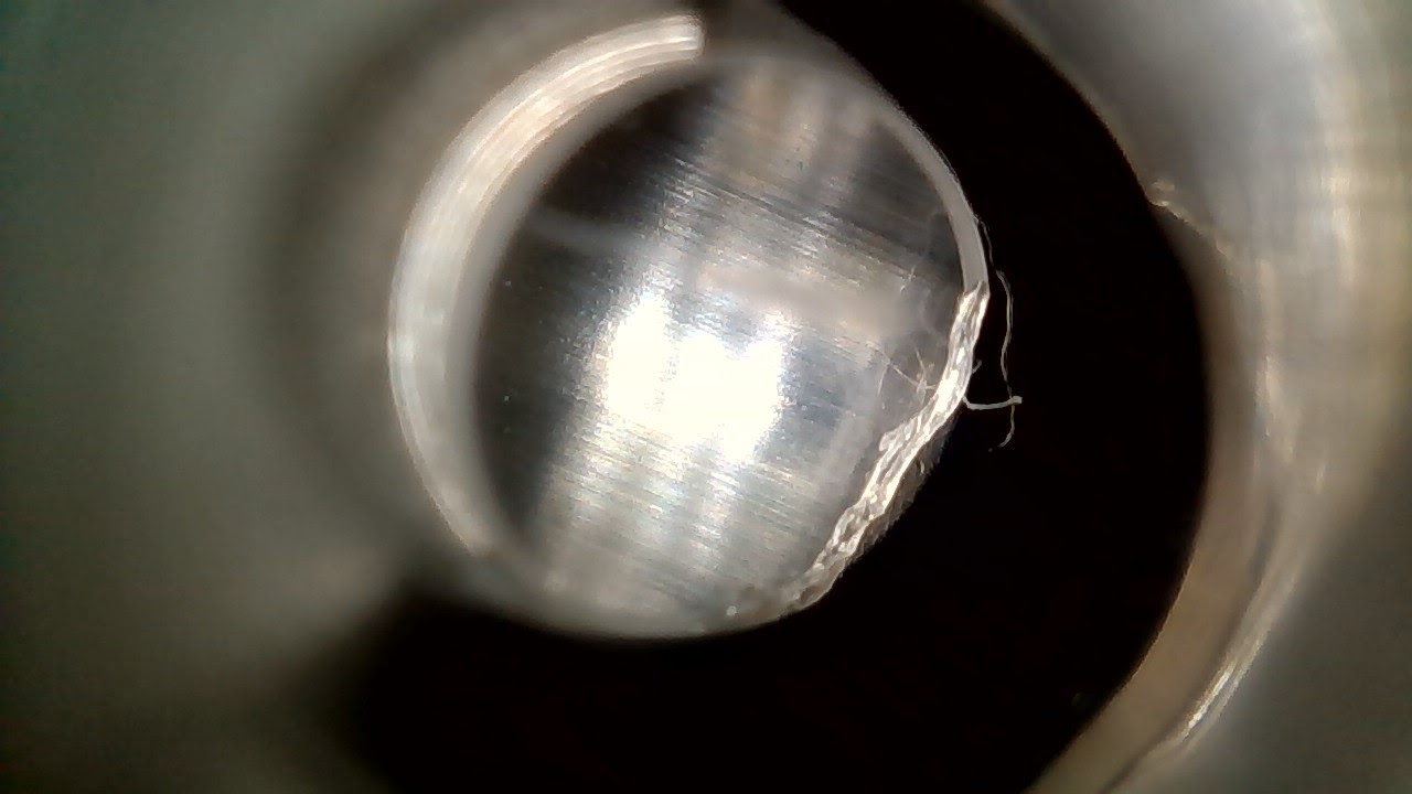

I had another opportunity to test Shooter's Choice Lead Remover today. This was a fairly leaded STX Superior Heavy .25.
A few shots before:
Then scrub with 1 wet patch, 1 wet brush, 1 dry patch, 1 wet patch, 2 dry patches, then 1 acetone patch followed by 2 dry patches. I do the acetone and dry patches prior to a liberal mopping with Trewax.
The bulk of the cleaning occured in the first 3 steps.
