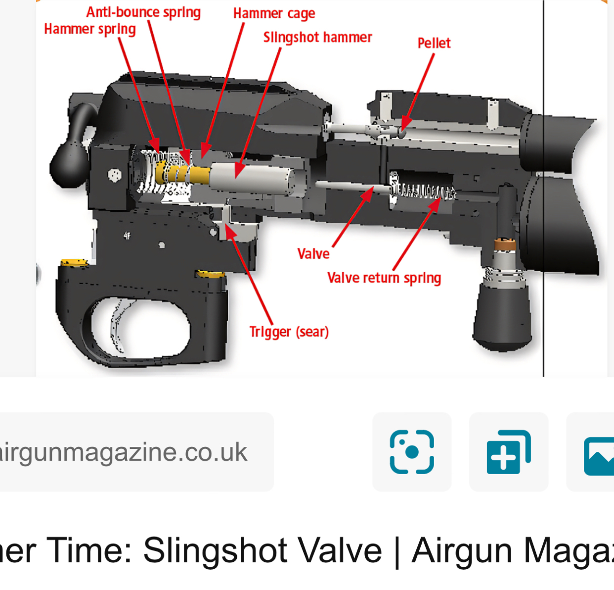

The striker adjuster just changes the distance that the hammer has to travel to hit the valve pin. There is no spring adjustment on the slingshot hammer. You can shim the hammer spring with washers to give it more tension. Mainly you just shoot a few shots over a chronograph to see where you are at then adjust the striker in till you max out in velocity. Less striker if you want a quick short burst of air. Works like a Benjamin Marauder hammer.
Reactions: Dogowsky and Dm800
I was discussing BRK/Brocock’s slingshot hammer system with another member over the weekend and captured this screenshot to get a better understanding of it.
