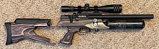

Purchased brand new, my .22 Sniper XR wasn't accurate for s***. Bore-scoping showed not only a couple sections of rifling with hideous cratering (like dental cavities), but laughably-bad machining of the chamber area of the barrel; all of which looked like the machining was done with a sharp rock :oops:... that needed sharpening! On return to AoA they replaced the barrel, and all has been fantastic ever since.
So much so that I decided to chop the barrel to Extreme Pistol Field Target maximum length of 15", cut the rifle section off the stock to leave the pistol grip for pistol use, but make connectors to join the chopped stock sections in order to make the gun into a pistol-carbine convertible. Black Bart is not only accurate enough for long-range air pistol and rifle Bench-Rest and Field Target competitions, but retains alll the other fantastic features of the Brockock Snipers.
