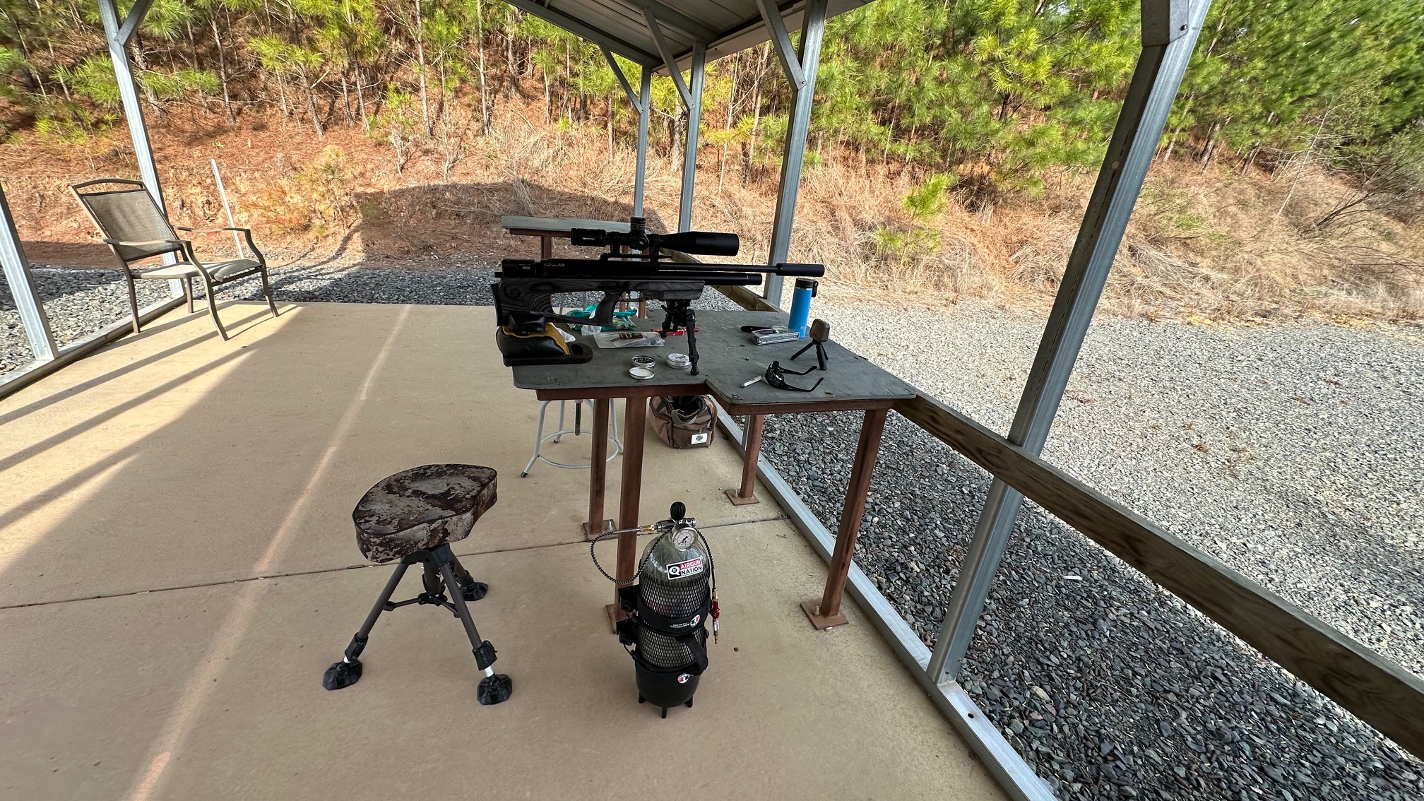

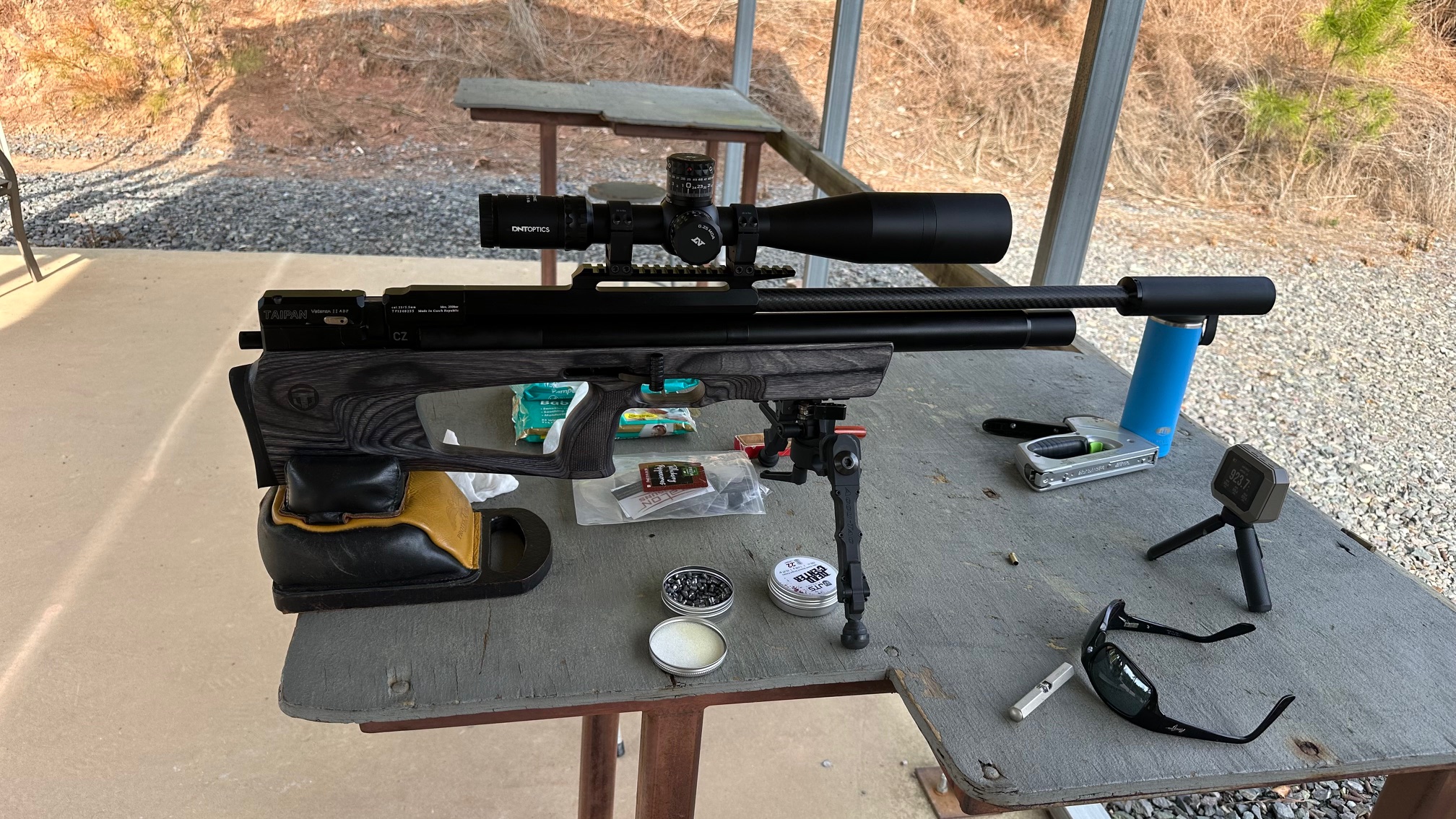

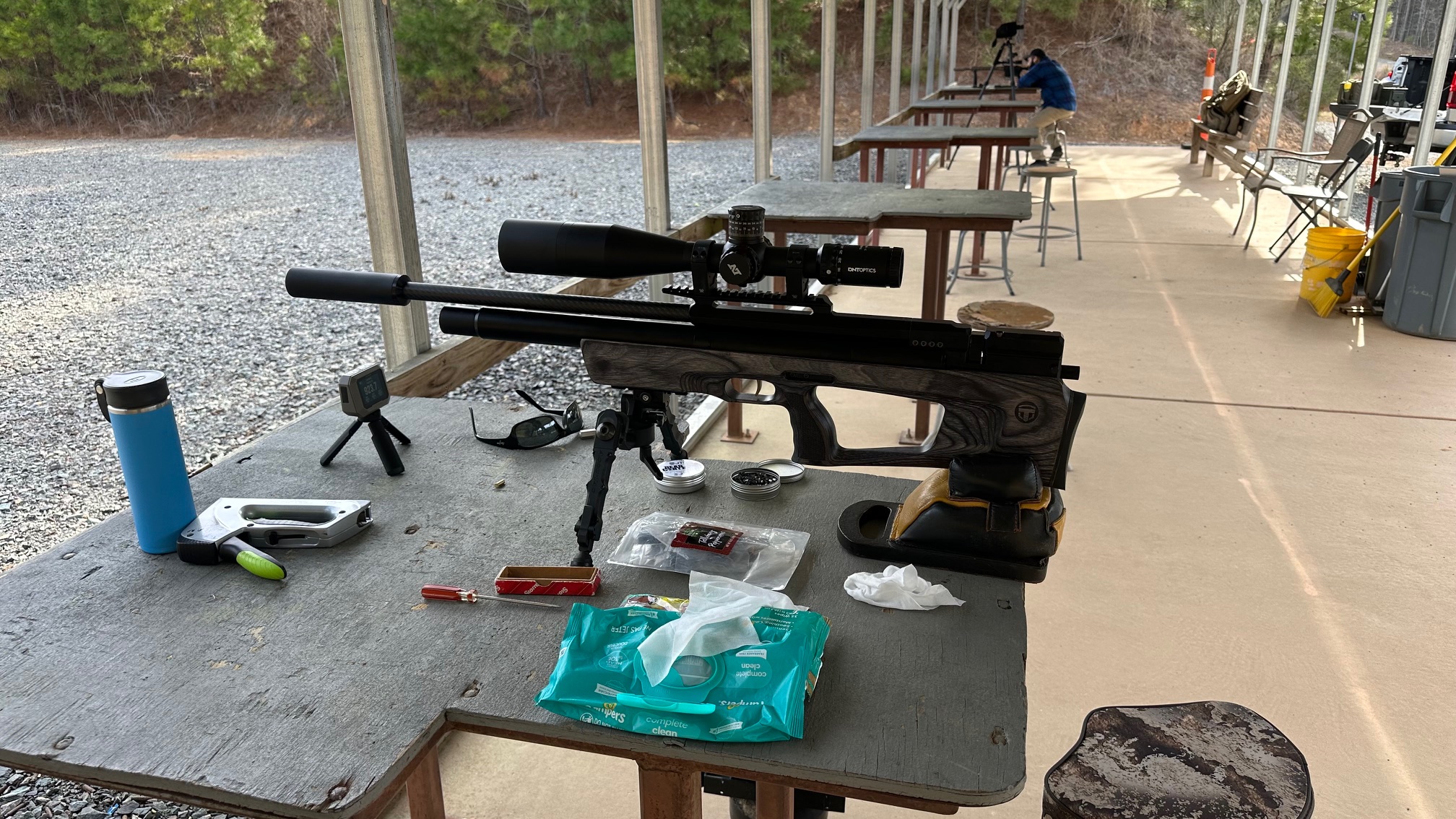

I received a new Taipan .22 Long ADF with 700mm barrel last week. Mounted a new DNT Optics FFP 7 X 35 X 56mm 34mm scope on this rifle. It is strictly for the bench and although I did not weigh it I think it is a little over 12lbs with the 42oz 34mm scope.
I plan to use it for 30 and 40Y Target Challenge and also N50 50Y targets.
Today, I shot it at 52 yards at my local outdoor range. Got there at 8:40am, and had the range to myself …..for all of 15 minutes. Saturdays are crowded typically, but I had about an hour with only me and one other shooter.

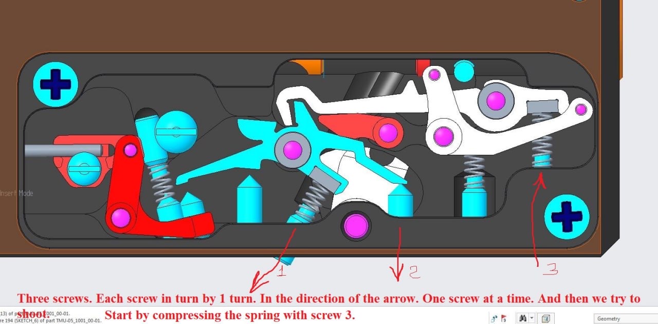

Front cocking lever is sublime and much better than my original rear cocking .25 Long Vet 1. A very crisp cocking cycle. One odd thing is that sometimes it did not cock. But, I figured out that if I pulled trigger thru release after firing each shot, it went back to cocking fully every time.
Trigger - about 6-8/10oz as I requested from Tony. Perfect for me. Crisp 1st stage stop with buttery smooth 2nd stage release
The Taipan moderator is very good, but when I took my muffs off, it did have a louder hammer strike. NP for me, as this is a BR gun.

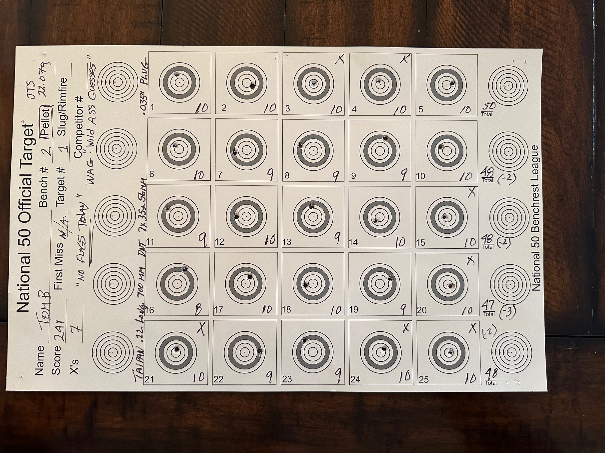

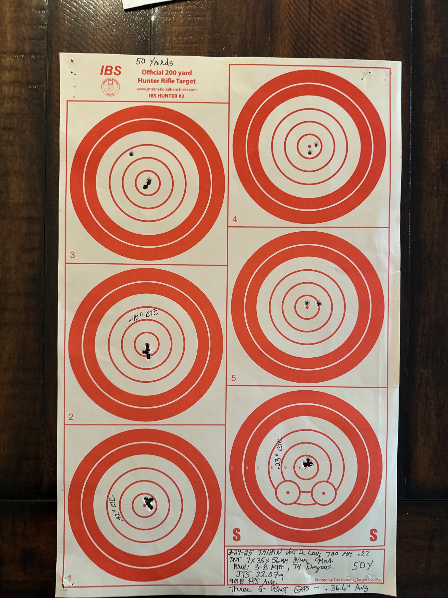

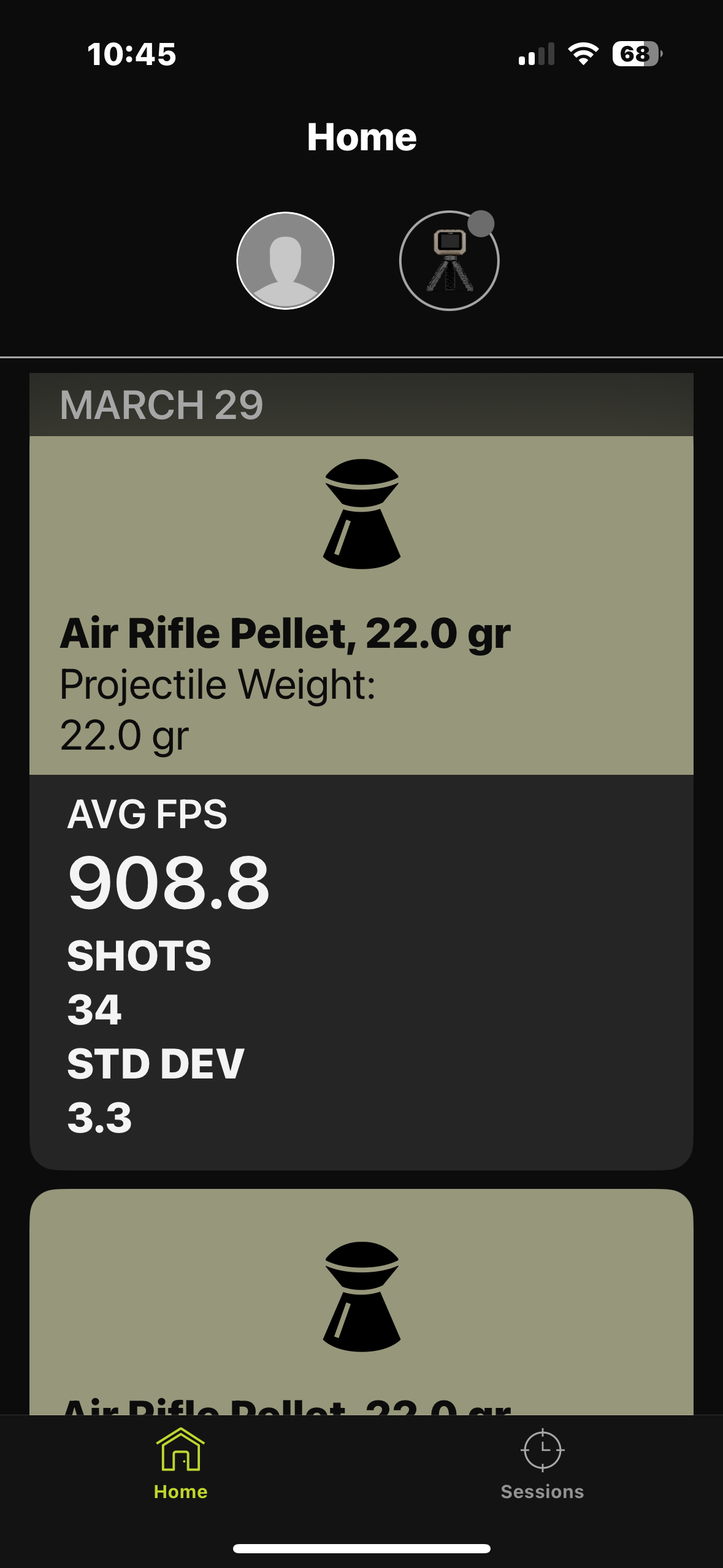

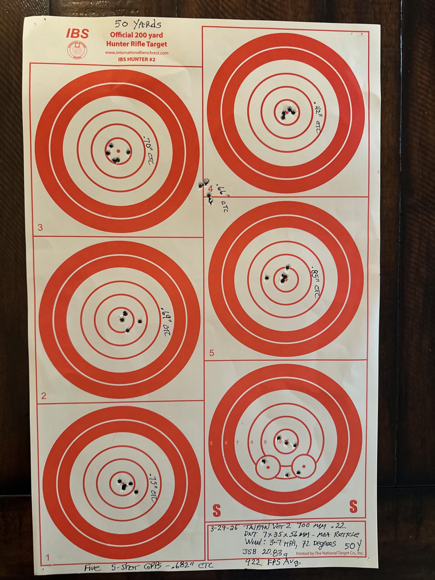

Accuracy - 1st outing but it is impressive at 52Y with a fair amount of wind. The 22.07g JTS did much better than the 20.83 lights. However, I know the lights shoot very well from Dillon’s recent review. Tony tested with AEA 21.9g at 30 y, ragged hole and a 10 shot string <10 ES at 910 FPS average.

My problem, which I verified with high speed video, was that the sear would actually bounce back up off of the 2nd stage assembly after releasing the hammer/firing and reset itself- because when I feel the shot break, my trigger finger stops moving. If I pulled through, or gave the trigger a second pull after each shot that also worked. That’s why for some more overtravel can help. Adjusting sear engagement with the sear adjustment screw did not help. Adjusting the sear tensioner did not do much either. The screw that fixed the problem for me was labeled 2nd stage tension in the above image. I simply backed it out until 1) it was still well engaged with the threads- don’t want it to fall out obviously, and 2) the 2nd stage lever could still reset. Worked for me, might for you. This trigger is somewhat sensitive to shooting technique, which isn’t ideal, but it can be adjusted to work and still feel great.
