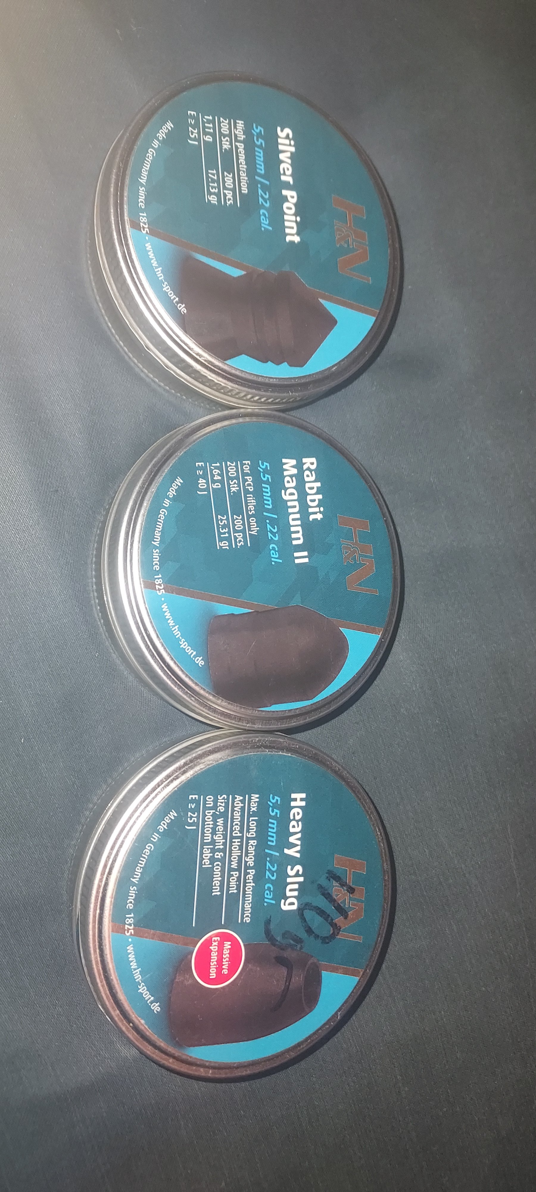

Every H&N pellets says for pcp only on the tin, I became skeptical if any of the H&N pellets will fit into my barrel, so I gonna just go with jsb diabolo instead.
Umm...🤷‍♂️
Of these 3; only 1 says that🤔
