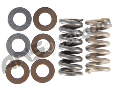

To piggy back off what nervoustrig is saying, they supposedly sell high pressure kits that bump the output to 1000 psi + you can add about 150 psi of shims, according to their manual. However, I was unable to find their high pressure kits in stock anywhere.
For anything higher pressure, it appears that McMaster part number 9712K112 is the closest fit for a Belleville washer option, though they're wayyy more expensive than the Ninja size Bellevilles.

Ah okay, this regulator having a smaller piston means it won't need as much spring force to achieve a given pressure. With any luck, that will allow the use of one of the cheaper Bellevilles.
If you have a chance, what is the diameter of the output side of the piston? On a Ninja reg, that would be the large diameter end.

Sorry for the delay but I just ran the numbers and it looks like the more affordable 0.020" thick Bellevilles (McMaster #9712K59 linked below) should be sufficient for a setpoint up to about 1400psi.
$0.50 each instead of $3.30 each sounds better.

Awesome! What thickness of shims do you think one ought to get? I'm looking forward to seeing what we can do with these regs!
These small diameter Bellevilles have comparatively little travel--about 2/3 that of the equivalent Bellevilles in the Ninja Pro regulator--so I doubt there would be much use for 0.020" shims. My guess is 0.010" and 0.005" would be useful, and maybe even something thinner.
Depending on how many Bellevilles the piston will accommodate, it might not do a good job repeatably returning to the same setpoint. We'll just have to see.

One more thing...extrapolating from your photo, it looks like the shaft is over 0.8" long which means it will take a stack of 27 of the above Bellevilles (0.030" high) to fill it up. As absurd as that sounds, it is actually favorable in terms of setpoint repeatability.
The taller the stack, the less sensitive to inconsistencies since the travel is spread out across more pieces, right?
