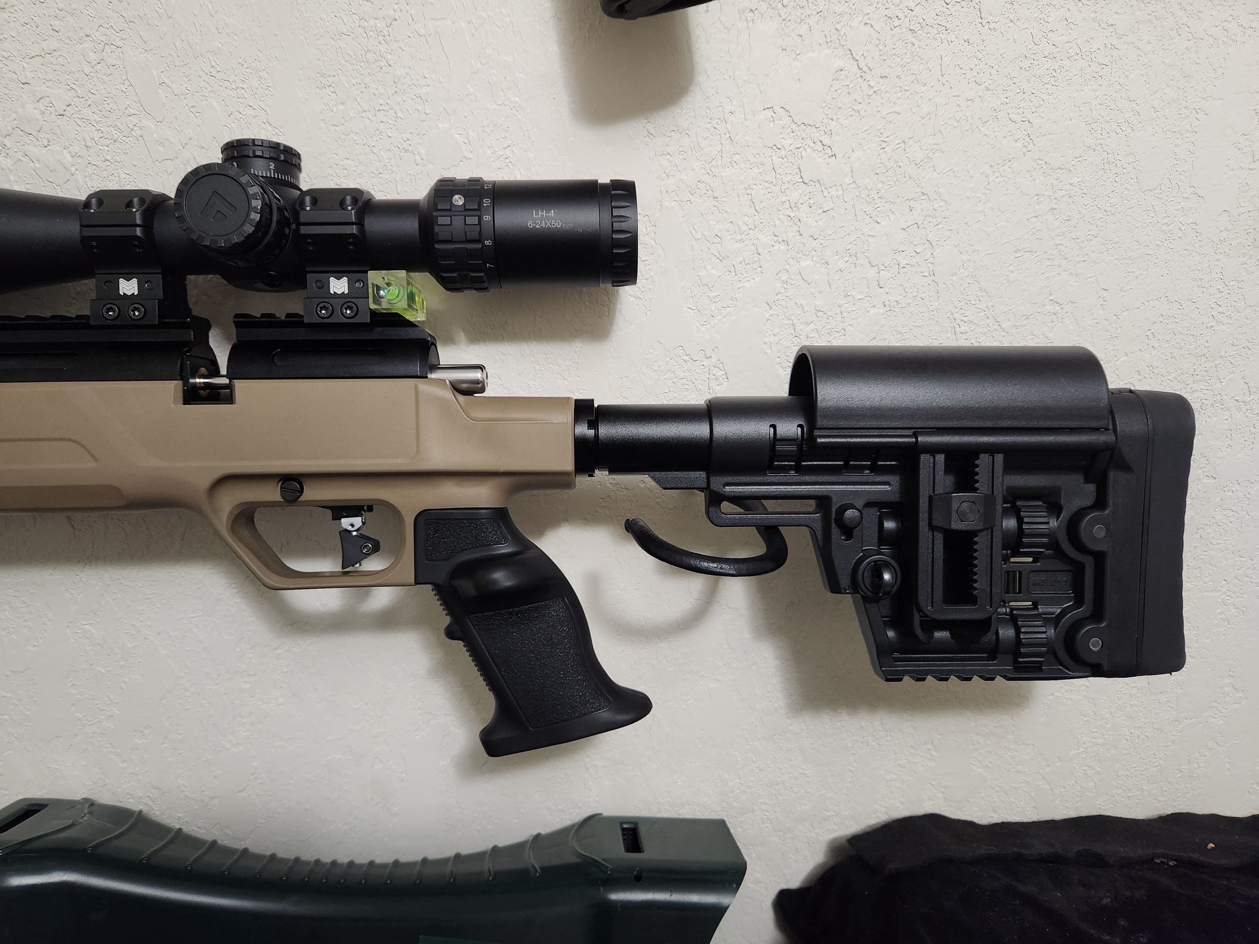

Has anyone changed the buttstock on their 250Z yet? I have a really good Luth-AR on my Armada that I want to change over, but for the life of me, I can't seem to get this original off the "buffer" tube. I tried just swapping out the whole assemblies but the Armada is MIL Spec and I can only assume the Barra is Commercial because the Armada tube is ever so slightly larger than the Barra's. Any help would be greatly appreciated.

The stock should come off if when you depress the adjustment slide lever all the way down, the pin should move out enough to allow it. If it doesn't, and mine didn't, you might be able to grab the pin with a pair of needle nosed pliers and pull it out more, to slide past the stop. If that doesn't work you have to knock out the pins. That's what I did.

Knocking out the pins is what I was thinking too but I was too chicken sh*t to do it, fearing I would f-up my new rifle. Nice to know someone else has done it with success. Gonna try it tomorrow whenever my lazy tail decides to get up. Thanks again 👍

It won't matter if you screw it up if you are putting a new one on anyway, you will be pitching the old one.

Ah yeah. I learmed that too. I have a folding stock adapter, but it will not fit on the rifle itself. Thats why I am just changing out the buttstock and keeping their tube in place.

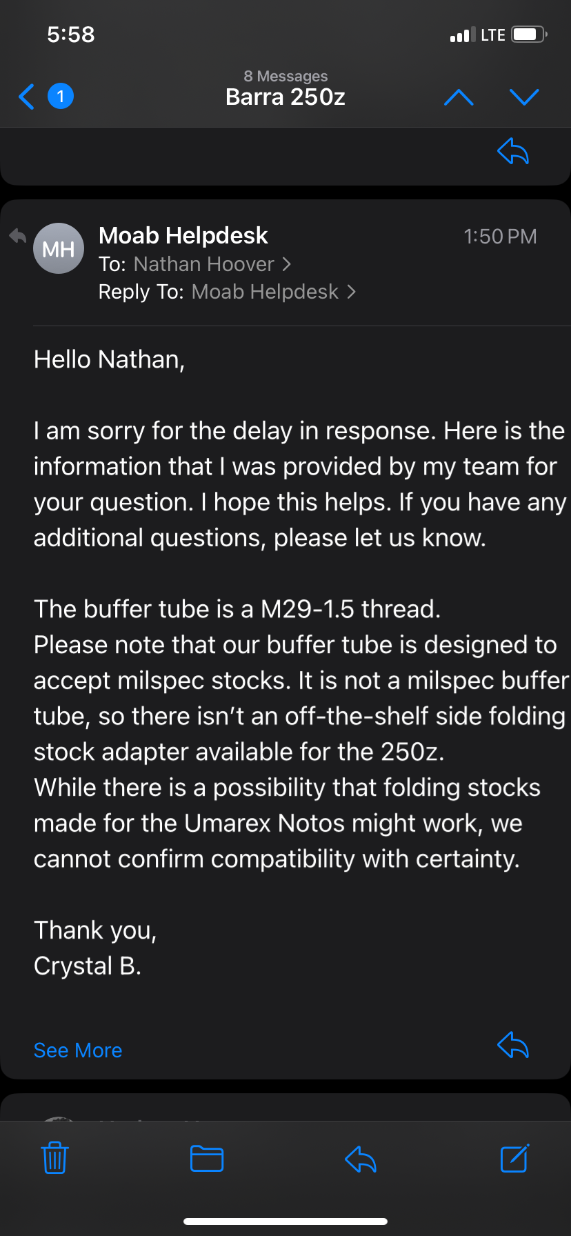

Here is a response I got from Barra’s customer service department concerning the stock/ buffer tube threads.
I also heard of a guy on here that ran a 1 3/16“-16 UN tap thru the OEM threads to accept a mil-spec buffer tube or folding adapter. I am thinking of going this route but I will wait until Barra lists replacement 250z stocks. They said they are planning on adding those to the website but do not currently have them.
That's an answer, thanks for showing that. I am not too happy with it, for a couple of reasons. I don't know if complaining, or armchair quarterbacking, or whatever you want to call it, helps, but I do know that saying nothing doesn't either. Hopefully pointed criticism can chisel its way to being used constructively, and obvious points not forgotten about or overlooked altogether.
Geo should have been the person giving that answer, and all answers, about design issues with the gun. He was the guy saying in interviews at SHOT Show 2024 that he was the designer that went to, and worked with, SPA on the specs, and has the designer should not have let that pass. This is not an unrealistic expectation either. If a buffer tube is involved, most enthusiasts want to know, commericial or mil-spec, and if it can take a folding stock adapter, ESPECIALLY on a really long gun. This should not have been a surprise to anybody.
They tell us the thread pitch, then say "yup, no adapter made for it, and you're on own to try other stuff," yeah -we already knew that, thanks a bunch.
Now, Barra, if you eventually read this, here is what I would have done, to alleviate some embarrassment for the oversight in the first place. Firstly, not throw my customers to the wolves, and say good luck. I would have called someone in the industry that makes adapters and given them the specs to make one that would convert the stock threads to standard mil-spec. so that I could give customers an option to solve the problem. But who does things like this, where can I find such an outfit, you ask? Try DonnyFL, that's what he does, and he does it well. Even if it would stick out a little and look clumsy, it would look good to me right now. You wouldn't even have to sell or inventory them yourself, just have a link to his website and the product for us to buy. Why not do this? It's a win for everyone involved.
