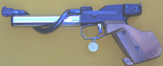

Believe it or not, this is an actual target pistol.
I have heard this was an advertising piece. I have also heard that it was done to have a longer barrel while keeping the over all length to a specific dimension. Both of the articles I had seen described the pistol as very accurate. I can't find either anymore.
