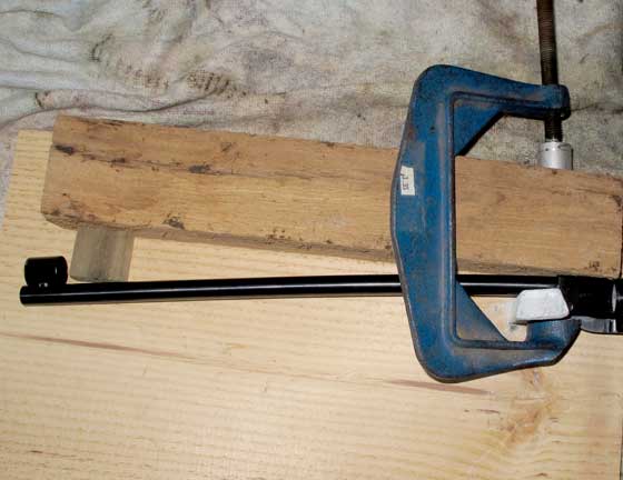

If you have a trailer hitch with a 2" receiver, which I assume is what you're using, a vise mounted on a spare receiver is a HANDY thing to have and will solve your problems! I have one stashed around here somewhere.
Last hairbrained idea if you don't have a vise, is to bolt a couple blocks of wood to the leg or anywhere on the table or something sturdy that would fit against the sides of the breech block. One on top and bottom, and just pull up. Easy and cheap and removable when you're done.

Both are with the barrel removed.
Lots of service trucks (phone company, lineman, etc.) have a table vise welded to a receiver that slides into a receiver hitch like a hitch ball would. If you buy a vise but don't have a sturdy table or the space, having the vise mounted on a receiver hitch is handy to have. Use it at home or anywhere you drive your truck. I used to have one I carried in my truck when going on off road rides.
The wood thing is just taking a couple blocks of 2X4 and bolting them to the something sturdy, spaced apart so the the breech block fits between them snugly. Then sticking the breech block between them and then pulling the barrel to bend it as needed. No vise needed with this method.
Maybe that helps?

Helped? It sure did. I really like the idea of the hitch.
Does the hitch version needs welding or is there a way to bolt it

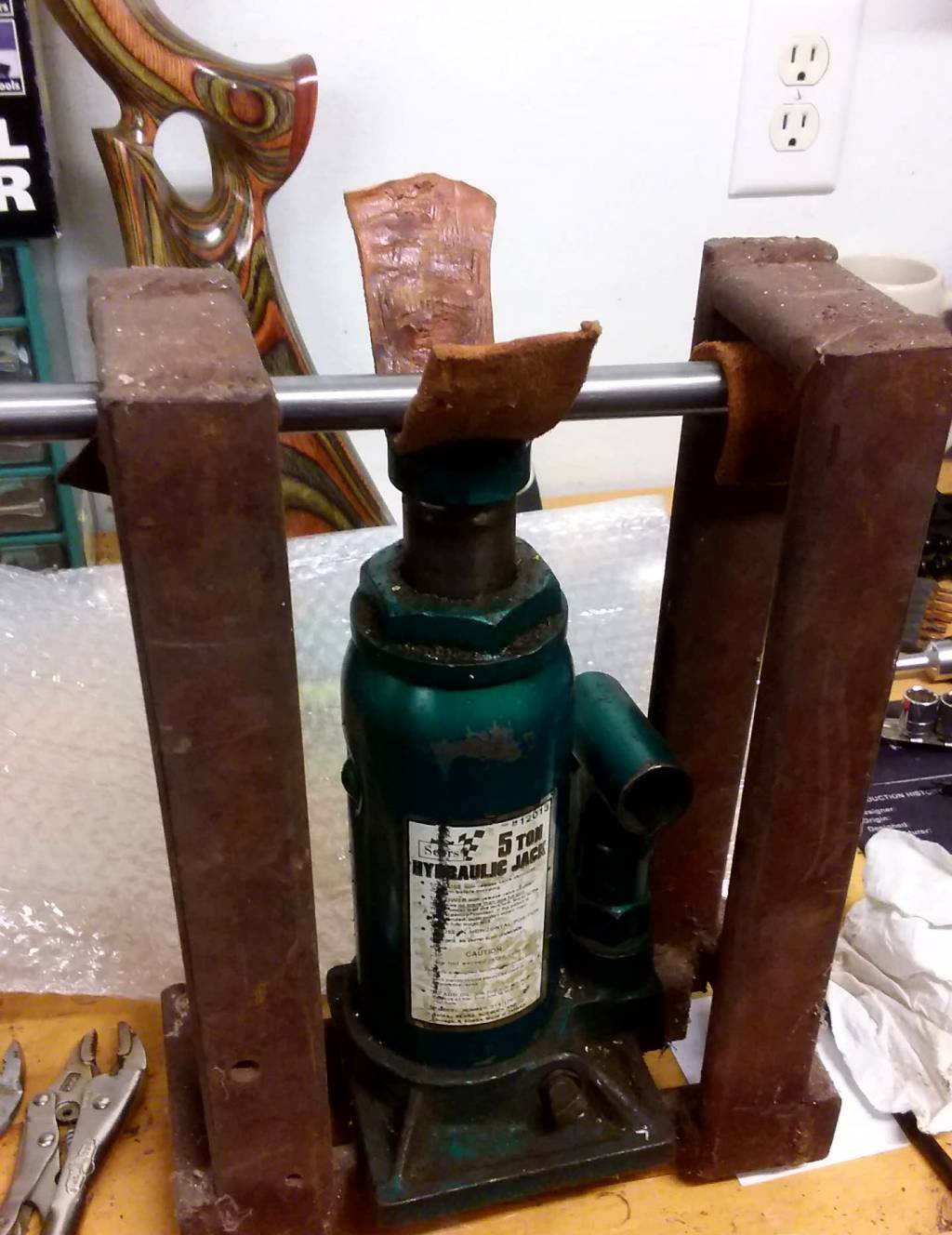

So... years ago I had an unfortunate accident with my R1 and the barrel was bent somewhat badly. I tried straightening it with no success so I built this. It was very controllable but took a lot of effort to straighten. I had it pushed into a bowl shaped curve before it finally straightened. I used a long straightedge to judge it's condition.
A year or 2 later I picked up an RWS 35 that had the trigger pulled while the barrel was open. Wasn't bent as bad as the R1 but when I went to straighten it , it bent like butter. Was SO much softer than the R1 barrel. I've straightened a couple more and bent some for less droop, also.
Just my experiences,
Bob

Dude, i think that is a nice invention. Good going
