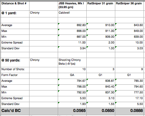

First, the easier stuff: I wholeheartedly agree that selecting a pellet type based on having a higher BC does not indicate it will shoot accurately in your gun. Easy example for me to reconcile: Rat Sniper slugs have signficantly higher BC's compared to the JSB heavy pellets, but the JSB pellets outshoot them handily when it comes to accurate groupings at even just 50 yards. No comparison-JSB's with the lower BC's (see the chart below). Totally on the same page as you on this point.
1540496731_16565684885bd21d5ba6a5f5.69812814_JSB vs. Rat Sniper slug comparison.jpg
My other two comments are maybe more 'subtleties' than they are disagreement: [first chart and paragraph] for me, a 0.9" drift difference (almost 1 MOA) is pretty signficant at 100 yards-that shows up as a more notable 'flier' that definitely ruins a group 'worse' with the lighter BC pellet vs. the heavier pellet. But that can be argued, so I'll just leave the comment with 'my opinion' is that 0.9" less drift is a pretty significant factor. Just as a reference (from other posts) here's how the BC's of different pellets show up through the same setup (same barrel, powerplant settings, etc)-but the velocities were not (and could not) be adjusted to match each other, so that's a limitation of the comparison. Here's the link to the thread if you want to see the groupings for each pellet as well. If not, here's the BC comparison chart for two different guns, under the same testing constraints (but on different days for the FX test vs. the RAW test):

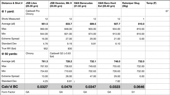

FX Wildcat Mk II Results:
1537664766_1152434025ba6e6fed3f3a2.93442149_FX WildCat 5 pellet BC Summary.jpg
RAW HM1000X, polygon barrel results: (shot on different days, and environmental conditions - so don't compare across the FX and RAW charts).
1524359410_8546590135adbe0f2a9dcd2.80301276_25 Cal BC of 6 pellets, compared.jpg
My point with these charts is the difference between the lite and heavy JSB pellets is very significant - but there is also the smaller velocity component I was unable to factor out to keep the same gun, same environmental comparisons fixed.
