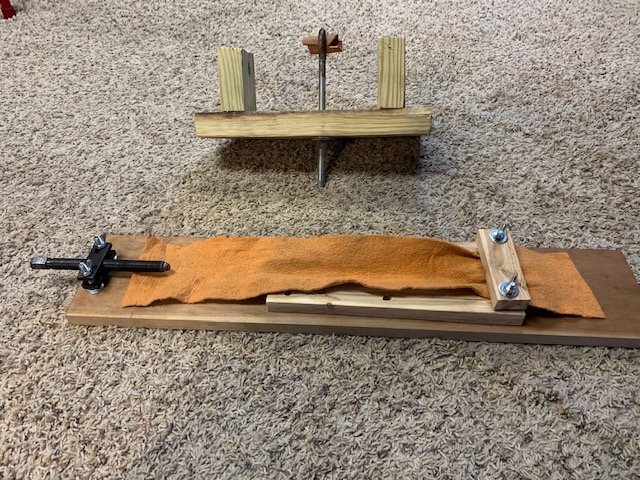

You can put a straight edge on it, top and bottom to confirm that it’s the barrel and maybe not a lockup issue.
Then bend the barrel to fit your need. I made a barrel bending tool out of som boards and a big eyebolt.
Bender top, spring compressor bottom.
I guess the board on the bottom was cherry or something. My carpenter son wasn’t very happy.
Not my fault he left what looked like scrap to me laying around.
Take it off his rent?
