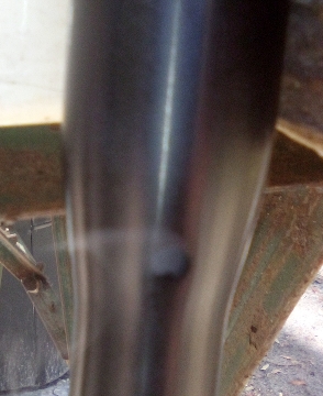

Barrel curved to right from factory

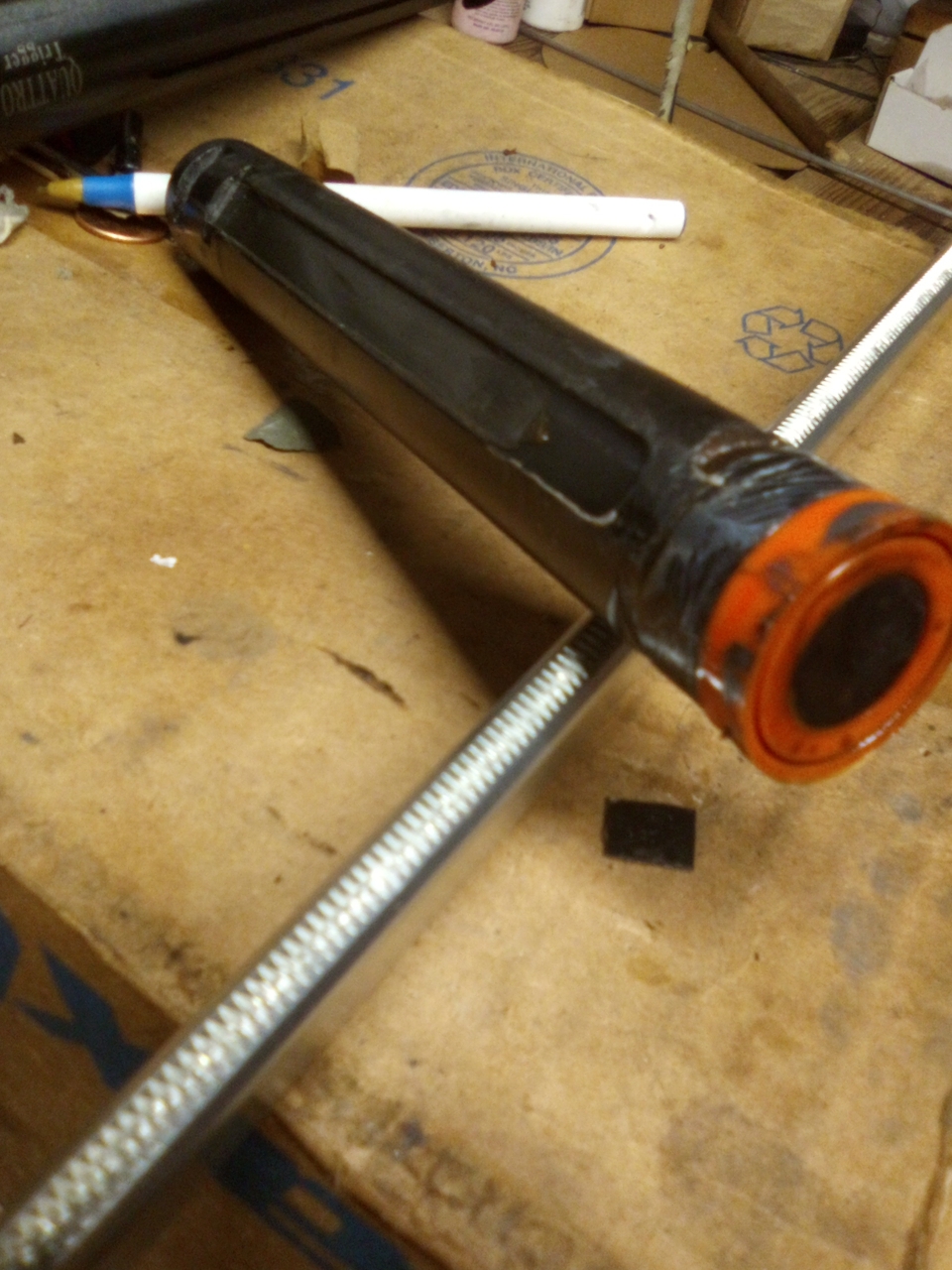

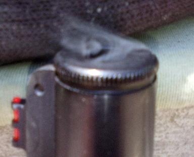

Thing was it shot kinda tight at first.. then degraded to shotgun like groups and started smoking bad..

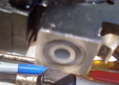

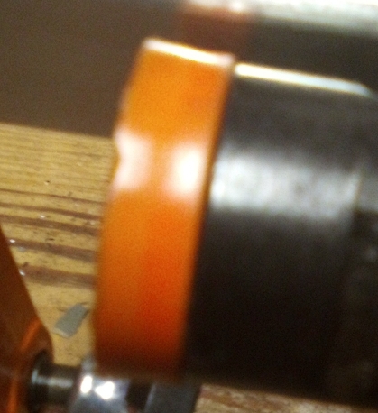

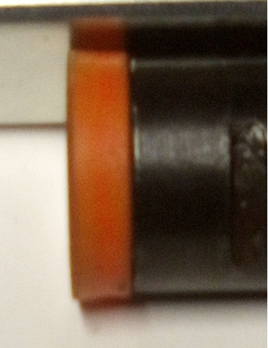

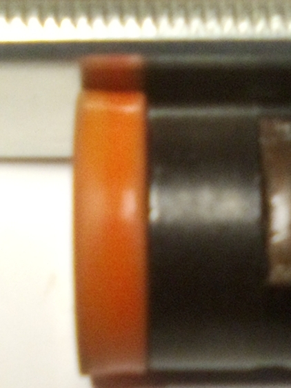

So i took her down and cleaned up hatsans mess . Big thing i guess was the nicked up seal . I just buffed it out the best i could and put it back in , cleaned up there lube job and did a more proper lube. So overall it shooting fine but i could of went with a new seal , who knows its working on the getto tune for now. .. i got some threads on it at gta ..lol
Heres some pictures for fun.. tye last seal pics are after i buffed the nicks out.
Oh man they really make you do the work huh? But from what I hear with even the most expensive options is that it's unavoidable. What did you use to buff it out just some fine sandpaper? And I haven't worked on an air rifle before so I'll have to get my chops in on this replacement at some point just to make sure I don't run into any wear issues, I'm assuming you can just get the piston out to work on that seal and don't have to worry about relieving the gases and replacing them? That's one thing I'm not positive on but seems like a good thing to ask obviously. Man this whole air gun game feels a lot like what's happening with the video gaming industry, you have to pay full price for a game beta that they expect you the play test for them! Whatever happened to selling quality products where all you had to do was buy it and pass it on to your kids haha I always thought people were just complaining when they said, "the good ole days" but now I have a whole new perspective.
Ya, i dont guess ive had anything that did not need some tlc on somthing.. sometimes super minor stuff then sometimes its a bit deeper. With and now after covid it seems there a lot more careless, cut a corner or blind eyeing some QC .. you know that its just good enugh to ship and get orders filled .. just hurry and we'll make it up in referbs and rma's. Lol. ..(opinion).
Yes like 400 grit i think ...
