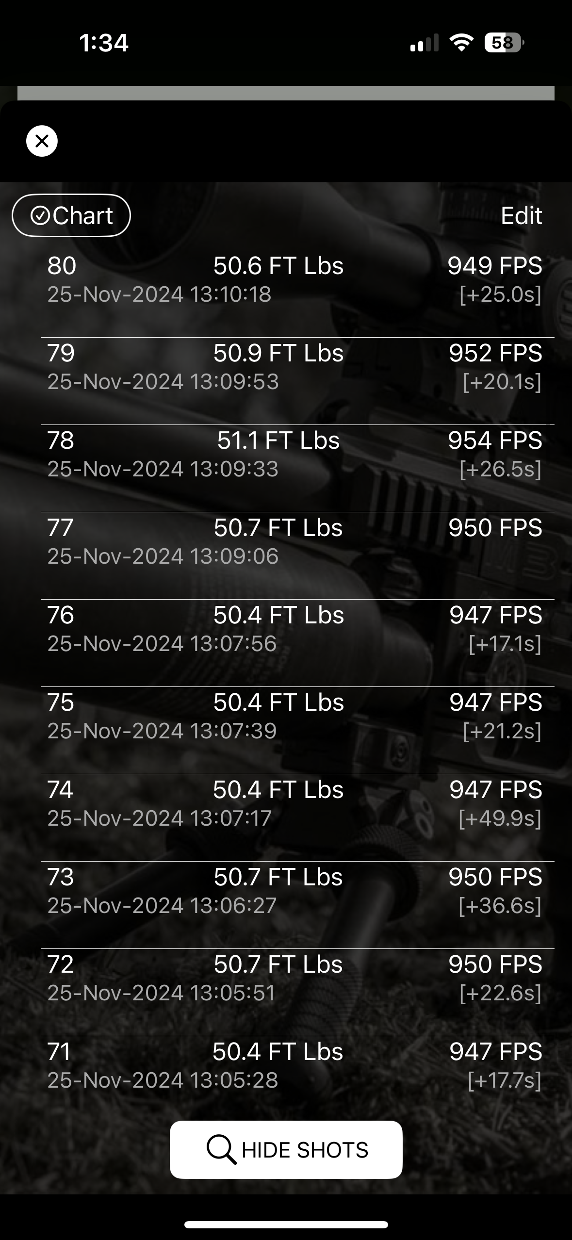

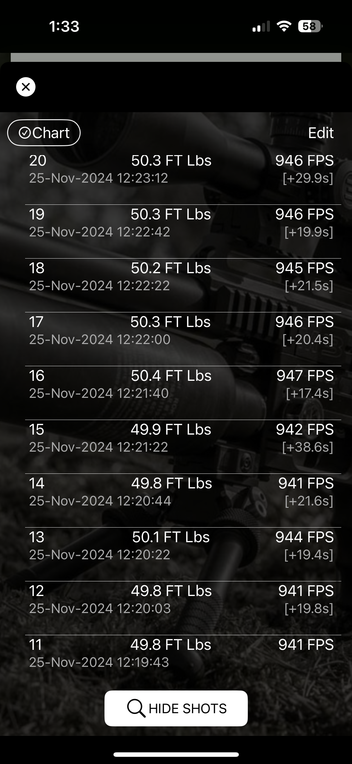

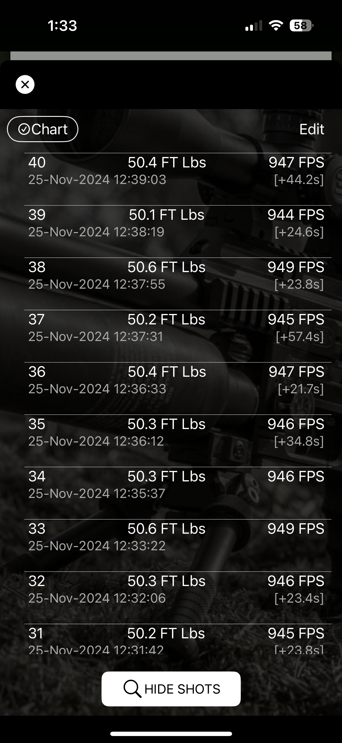

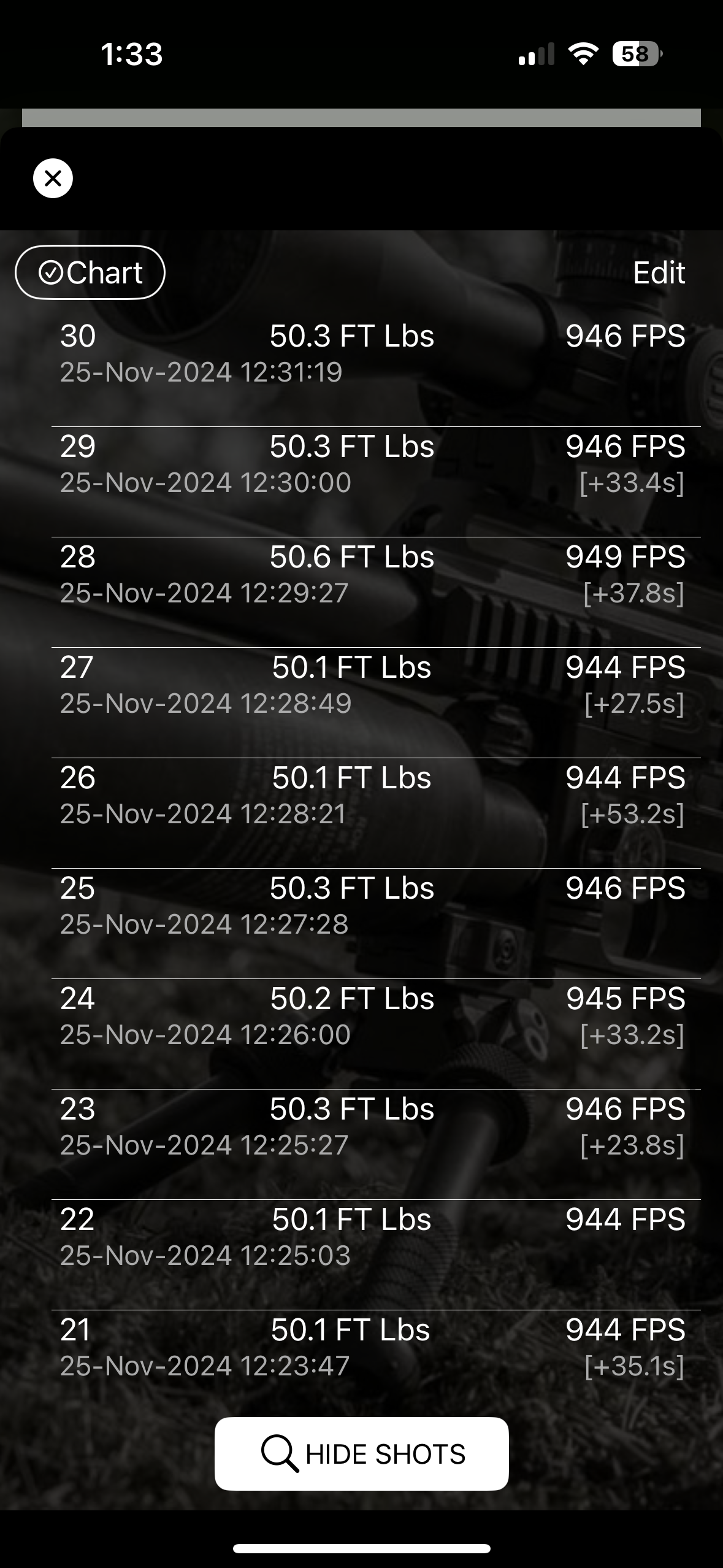

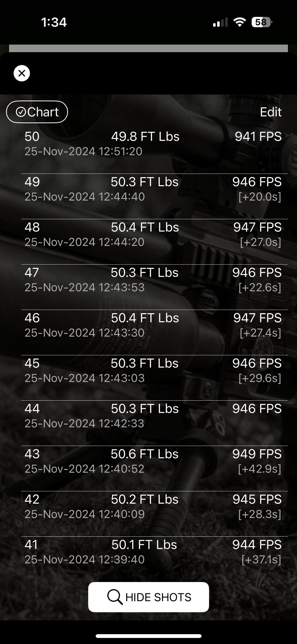

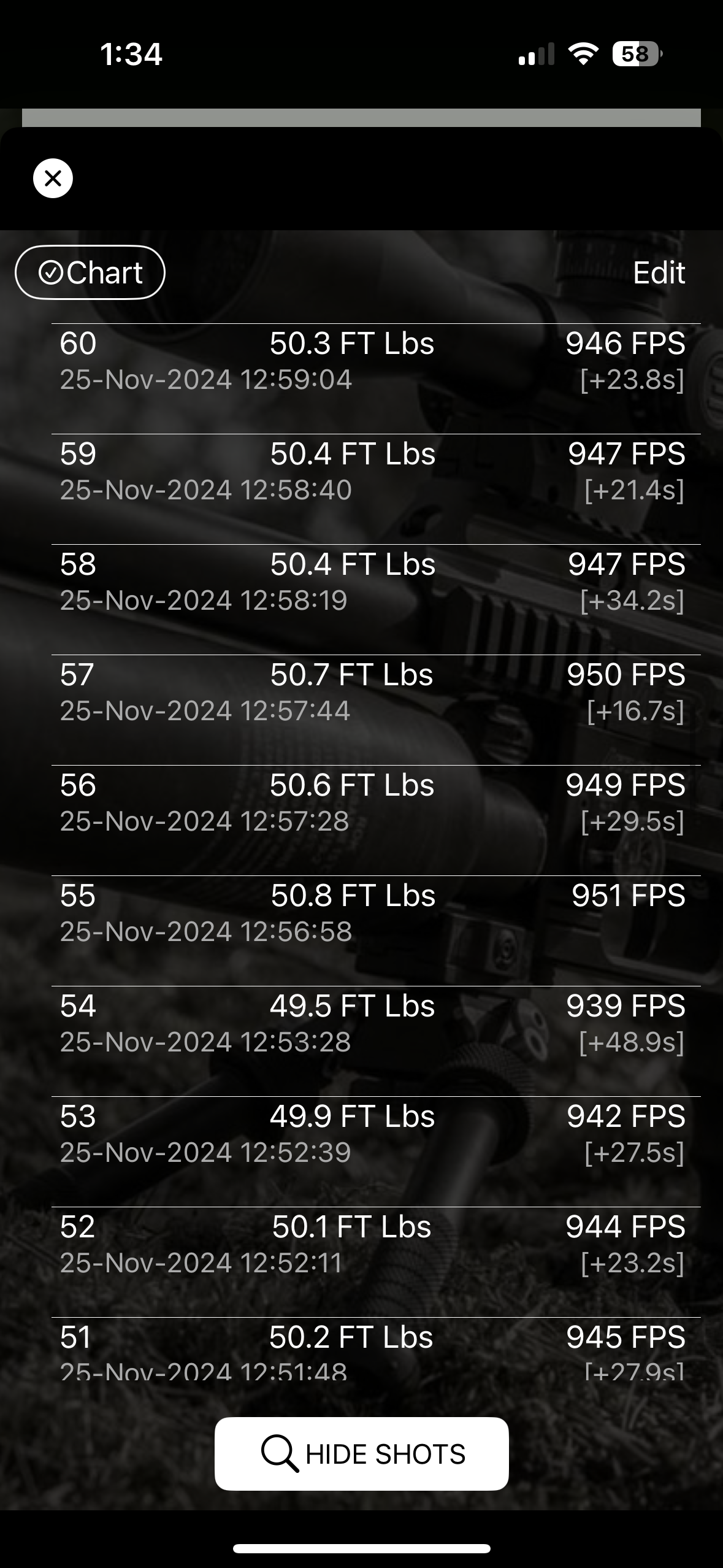

Just went and shot a 95 shot string at 50y. Pics attached. Barrel needs exactly 1-2 shots to find poi. After that it’s great until around 60 shots when the first fliers occur. Fliers that are not on me that is (the ones marked with an x are on me - I pulled those). Finding itself after but frequency of fliers increasing up to the point where every other shot is half inch off and it’s getting worse and worse after that. Chrono missed one shot, hence only 94 shots (topped air off after shot 54, hence the slight increase in speed).
