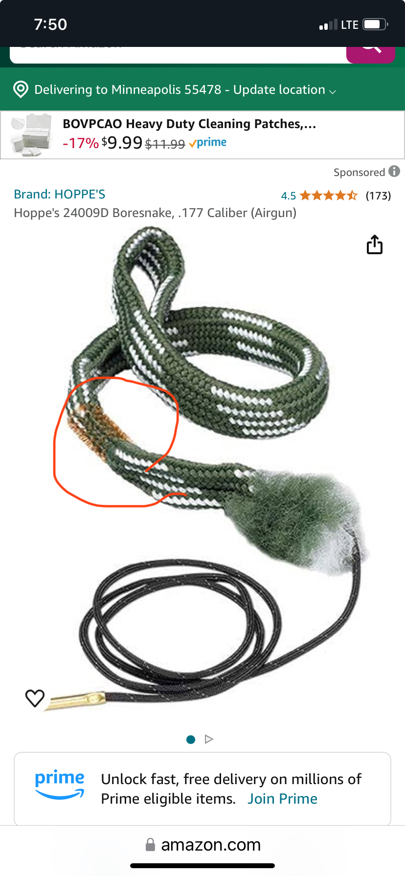

If wanting to pull the lead out ? .... you WANT the SNUG & SQUEAKY pull threw of a bore snake !!!!
Wiping the bore with a patchworm is near useless for the task your trying to do.
My favorite sound when I'm cleaning. The SQEAKY aounds let me know I am basically done other then a light film patch after. I run 3 patches 1/4 folded back to back in line, so 3 patches in bore at the same time. I push em with dowl rods. The Squeaks haven't lied to me yet. I can throw barrel up to light or scope & it's clean. I think alot of people also think there barrel is clean from patch indication but just dragging a loose patch isn't going do it.

Do you recommend a bronze brush or nylon? Thanks. Good post btw.
Nope, it has a brush

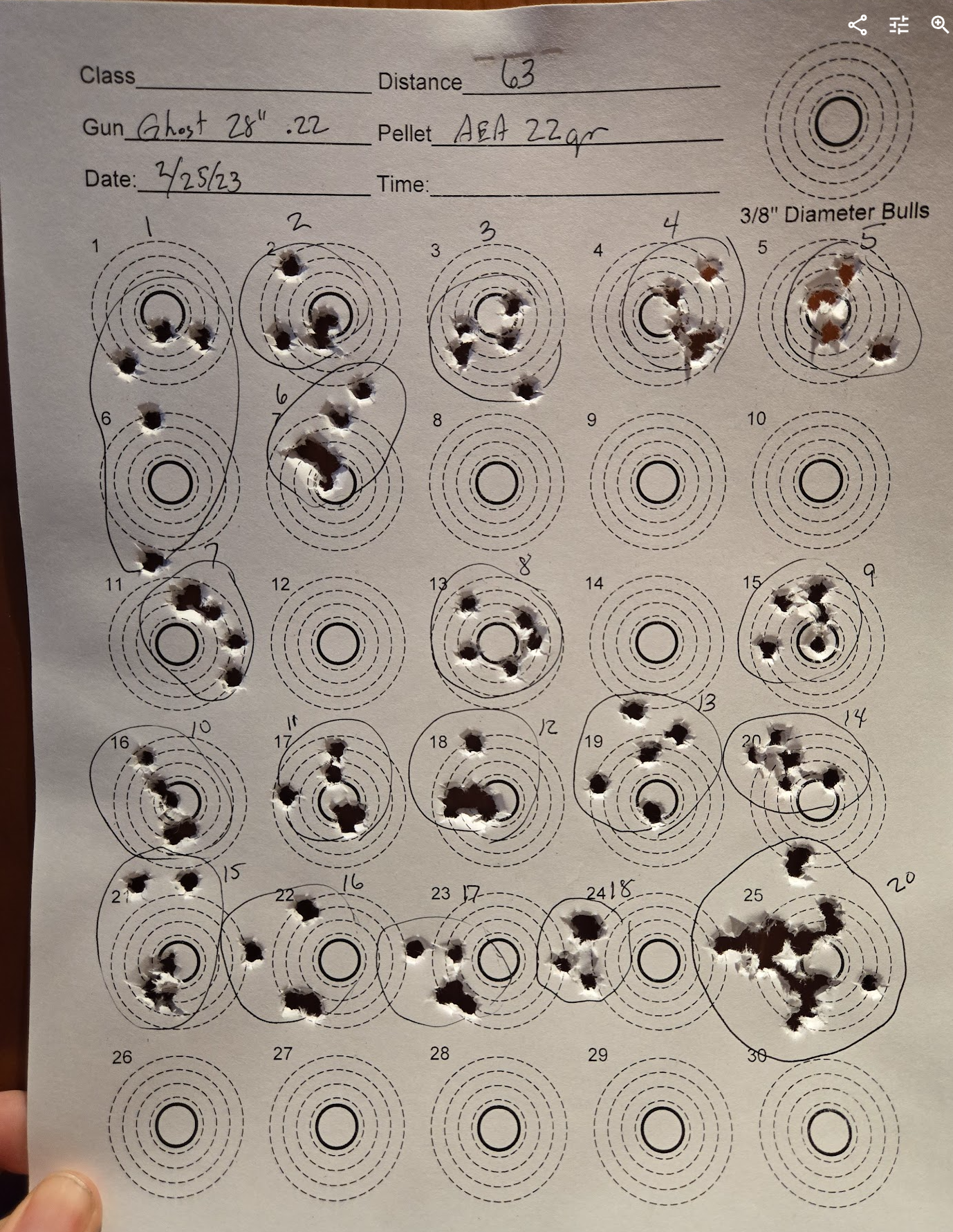

I read through this post on your Ghost barrel with the fouling/leading problem at around 50 to 70 shots with great interest. I just purchased a 28" .22 one from AoA that is behaving similarly. Notably, it has a very, very, very tight bore and super tight choke. I almost had to hammer pellets through until I sized them. I found that if I sized the pellets to 0.2175 and lightly lubed them with Slick 50 One Lube, I had much better performance. I am using AEA 22 gr pellets, shooting at about 920 fps. I shot 120 shots and after about 60, the groups started to open up, but then tightened up again. It kind of oscillated that way till the end. One 20-shot group was about 1.5" at the end at 63 yds with the various fliers.
I tried sizing at 0.2180 - no go (I have an old Beeman Pellet Sizer), tried lubing with Whiscombe Honey - no go, tried lubing with ceramic car wax - no go. It is very finicky and only 0.2175 with Slick 50 One Lube.
I noticed that the speeds start to creep up with more shots (and the BC to drop off from 0.055 to 0.046 or less, as well), which I attribute to the barrel leading/fouling up. I get pretty good groups - 0.75" to 0.50" at 63 yards, but then it will throw a flier. Usually the fliers are high, but I can often seem them sprial. Other times, my groups start walking around the bullseye - I assume this is because the pellet spiral is progressing.
I tried shooting a couple of felt wads, but that didn't have much effect other than the supersonic bang. It seems I have to clean with JB Blue Bore Past to get it to settle back. When I tried 0.2180 pellets, there were lead flakes on the cleaning patch.
Is it possible that the cold weather is affecting the barrel (e.g. stickier for lead at the colder temperatures)? I need to do some more testing as it warms up, as well as try sized JSB pellets.
Certainty an eye-opening experience on barrel fouling and helps explain problems with other barrels that I have. It gives me some hints for addressing my EVO SubMOA barrel as well.
Here are my shots at 63 yards today (110 shots averaging 914 fps). The circles are 1.25", with a 0.375" inner bold circle.

Just asking, is the 906 to 925 the optimal fps that the rifle shooting desired pellets correct. Seems a little "hot" to me, not faulting, but possibly could be? Just an idea. Also correct sizing on OD is very viable, and that is part of the pie or accuracy. Speed and pellet material can be artificially affecting barrel fouling just my two cents. I am only chiming in cause I love problems and the solutions that can be found from them. Best of luck and keep posted if you find anything else apparent.
