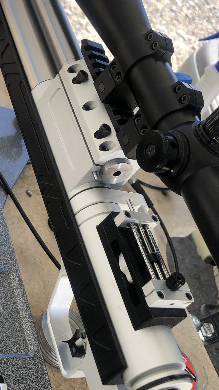

I could fall so deep in this it's stupid. Not just the vibration aspects but all facets of accuracy improvements. "For our pea shooters, it’s kinda hard to justify strapping on a 6lb bull barrel. At least not for any product the designers wish to be commercially viable." But, on the other hand, product development is all creeping right past thoughts like this. If interest is there and popular enough commercial offerings will show up.
There ARE guns out there that are doing this.
This is a .900” barrel with a solid action block and 4” of full contact.
Mike
