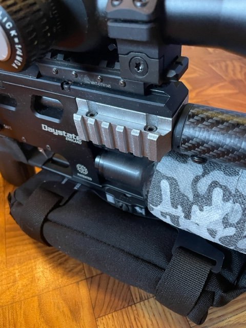

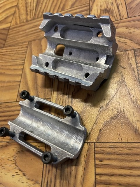

I need to be clear here about the method I use—to perform a fair assessment the laser MUST be mounted on the barrel and not the shroud. Owners of Ghosts and Wolves should know that the shrouds over the guns’ barrels are retained by two O-rings and that the purpose of the two set screws on the barrel collar (inside the shroud) is to keep the shroud in place only, NOT TIGHTEN it as there are no threads on the shroud’s screw holes. That said, to test for any movement you’d be applying lateral force to the exposed parts of the barrel from the openings of the chassis. Also, make sure that there is some clearance between the base of the collar and frame. If the laser is mounted on the shroud and you see movement—meaning, the dot does not return to its original position or zero—which is not apparent when the laser is mounted on the barrel itself, obviously the problem of POI shift would therefore be coming from the shroud or any of the components it encases. Keep in mind that any angular or lateral deviation from concentricity of the shroud with the barrel can cause pellets to clip, thus leading to POI shifts. This problem would be magnified if there is a moderator mounted.A method I employ when trying to determine if barrel position/movement might be the physical cause of a POI shift is mounting a laser on the barrel then adjusting the laser dot so that it superimposes the crosshairs of the scope, then I torque, twist, bump, carress (), or even stare hard at the barrel and see if the position of the dot changes.
The BRK Ghost and Daystate Alpha and Delta Wolves do not need the barrel clamp. If there is any POI shift from any of these rifles, if all else have been ruled out, change the front-end barrel-retaining O-ring for a tighter one.
If no change in the laser dot’s position is detected when administering the procedure above on the barrel (not shroud), the above, good folks, is why there is no need for a barrel clamp, even when there is a change in the dot when the laser is mounted on the shroud. And if it’s not directly the shroud, it could be the threading on the muzzle that causes the shroud or moderator to be misaligned (To test for this tape the exit hole of the shroud/moderator and fire a round. If the hole is off center, then it’s likely clipping.)
