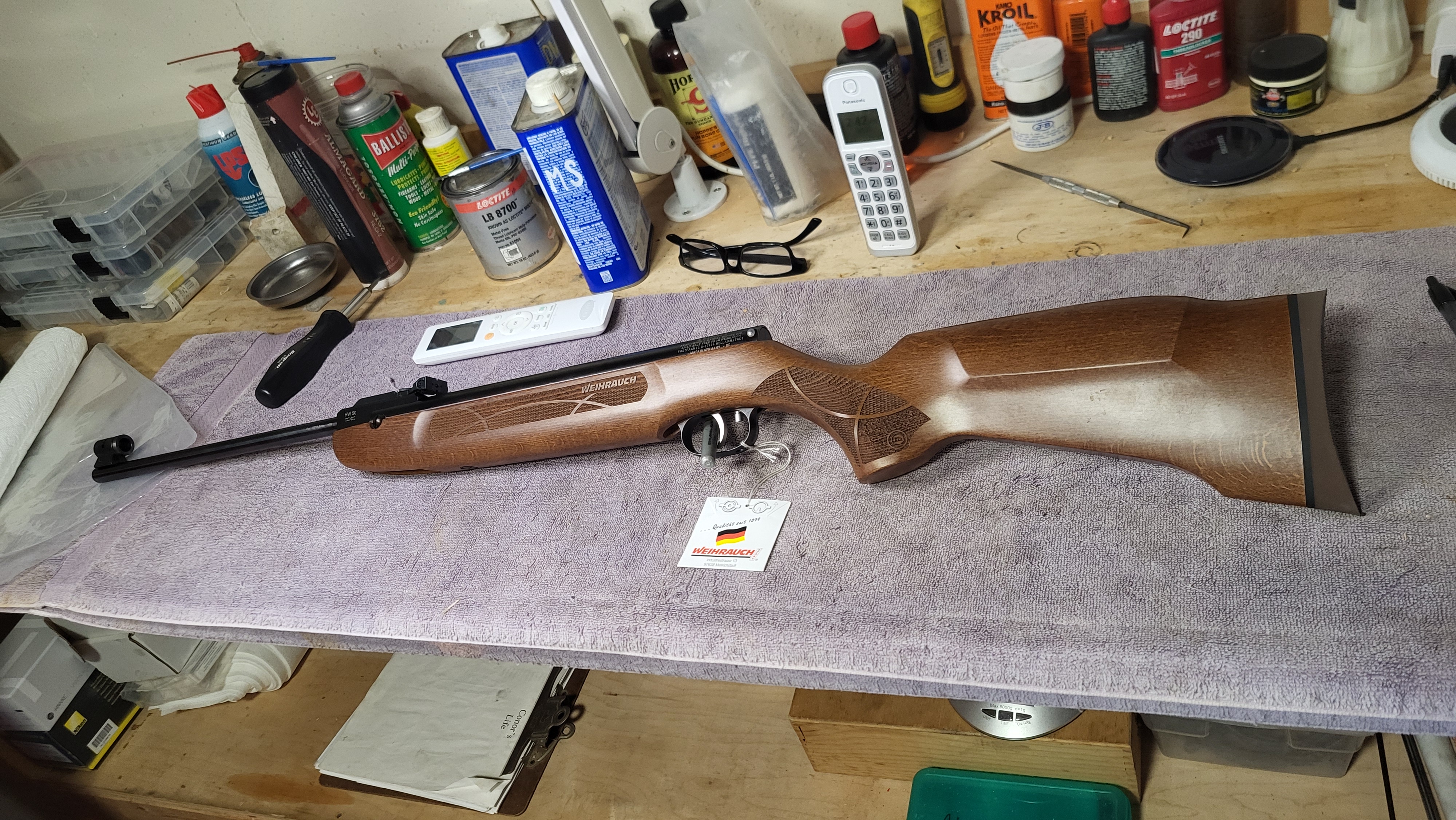

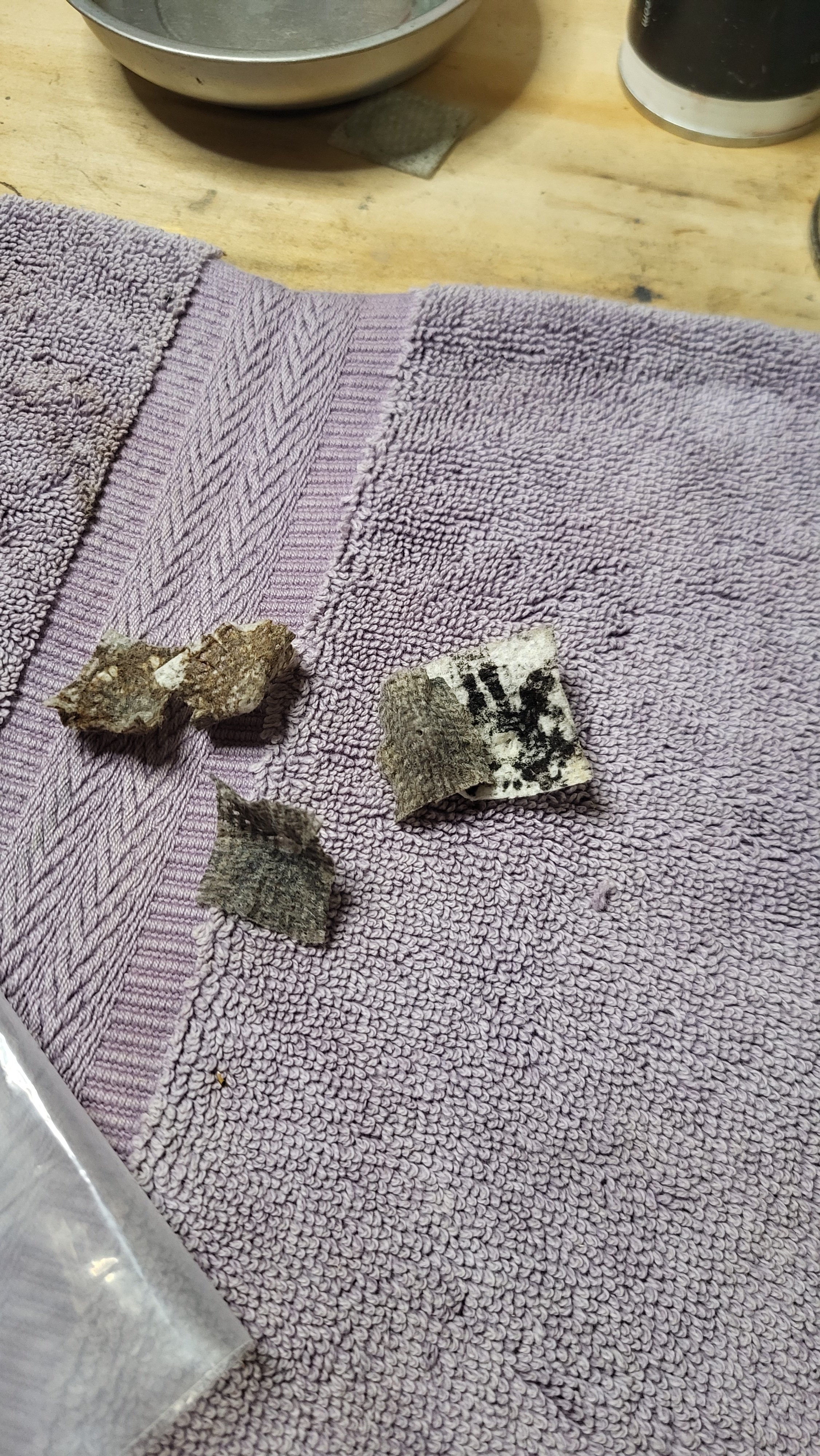

I just replaced my HW50 barrel. Ordered from Chambers on their web site, Received in about 5 days. It was in customs, in New York, for 2 days. You will get the barrel mounted in receiver, the wedge lock and seal, also installed. Remove bolt holding receiver, unlatch cocking arm, drive pin out. Put cocking arm in new barrel/receiver, drive pin in, reassemble gun, clean barrel, mine had a LOT of brown rust looking stuff in barrel. Shoot and enjoy. Don
Brown rust lookin stuff is anti corrosion. I just cleaned a brand new 22 cal 50 sent to me for a tune.
