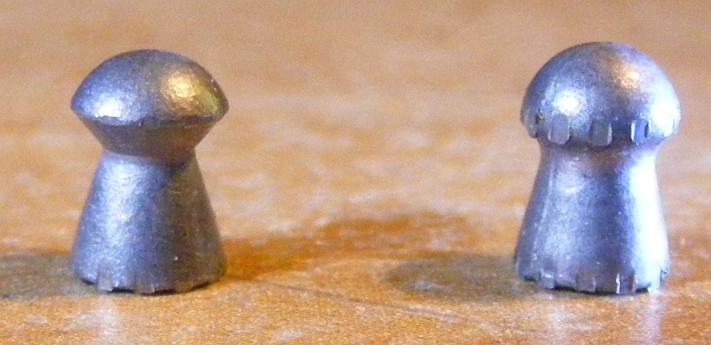

Can you share a close-up photo of a couple different pellets after being pushed through the barrel? Preferably with pellets whose heads measure 0.177 - 0.178. I'm curious how much engraving will be shown at the perimeter of the heads.
For example, even the slight amount of engraving shown on the left is more than adequate:

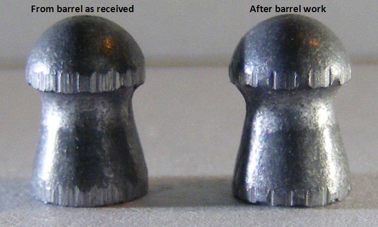

It would also be helpful to see if the rifling is producing nasty striations:

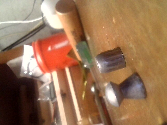

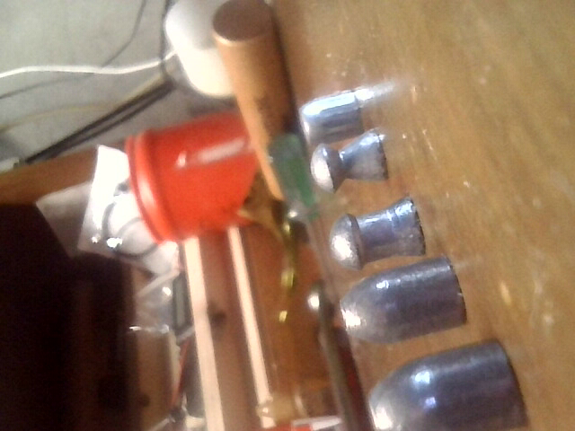

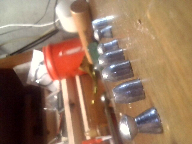

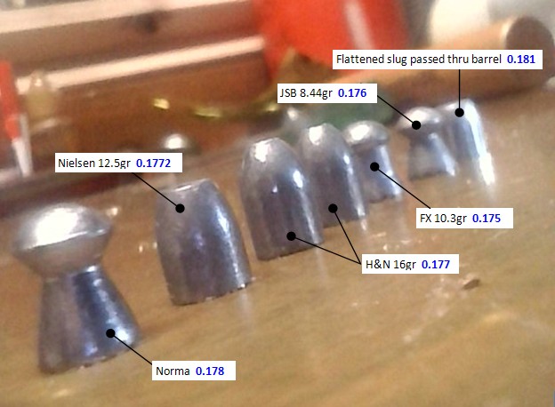

Hope these pics work its best i can do, they were all pushed thru barrel
Okay yeah the pictures of the two slugs (0.177 and .1772) show no engraving whatsoever. Not even burnishing marks from light contact, at least not that I can make out in the photos. So that suggests the lands are somewhere over 0.177.
Turning to the larger Norma pellet (0.178), I can't make out sufficient detail at the rim of the head to see burnishing but I think engraving would be showing up in the photo if there were any and I'm not seeing it. So yes I think that confirms the bore is oversized.

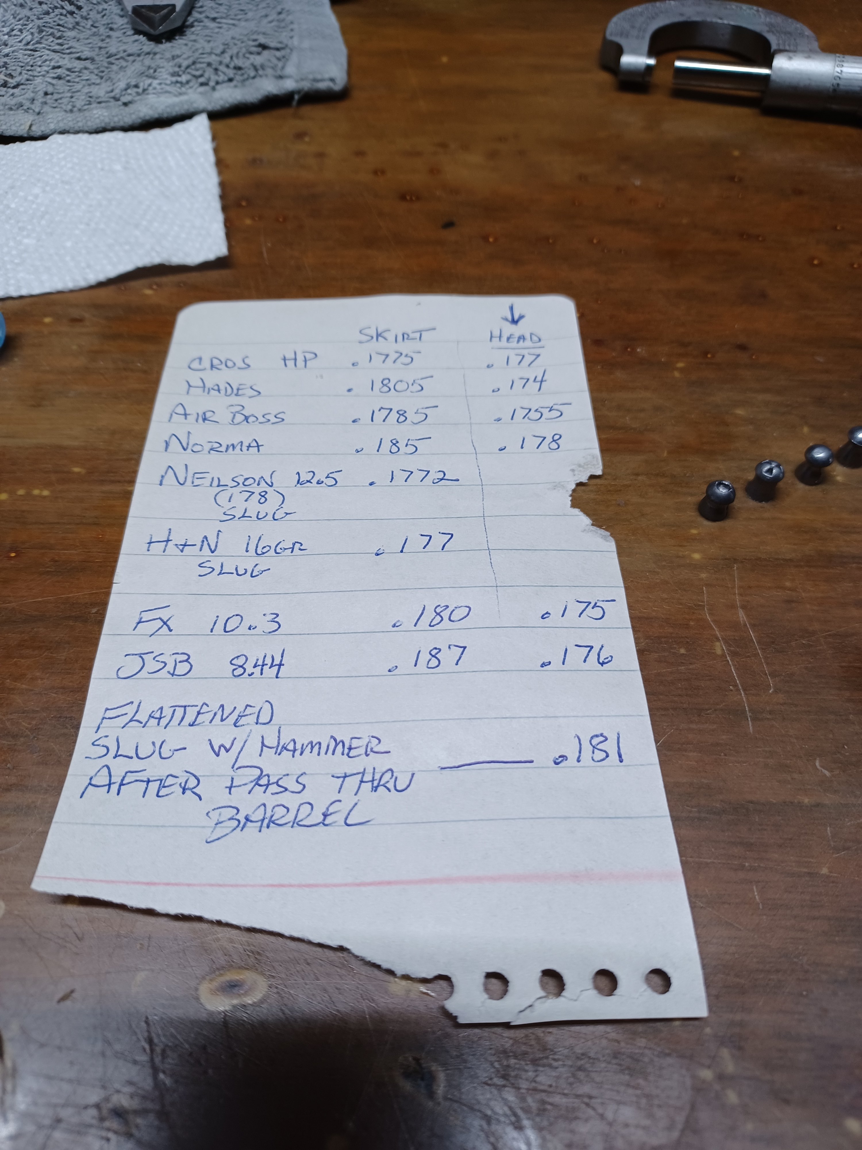

For now I will assume the lands are at something very close to 0.178. Meanwhile the oversized slug emerges at 0.181:
The numbers mean the engraving can be no deeper than 1.5 thousandths. It looks deeper than that but it could just be my perception. At the very least, I think it means the lands can't be 0.179 or larger. 0.178 is probably the number.
For the few shots it groups well after a cleaning, which of the pellets listed will group? Other than the Norma, everything else would be unsupported by the rifling and would therefore likely scattershot all over the place. A possible exception may be a pellet whose skirt is thin enough to obturate and sufficiently center it in the bore.
You are 100% right figuring my mess here, the norma are the ones flying well after clean, I'm thinking that beeman sent me a replacement barrel from a returned rifle because the barrel sealing o-rings looked like they were gouged from transfer hole. Appreciate your time spent here, thank you
