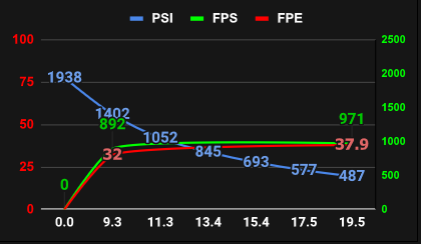

Below is an example of the pressure and fps/energy gradient of a very standard airgun. 22 cal, 19.5" barrel, 25 cc plenum volume, 2000 psi set point, .187" ported, shooting 18.1 gr. (also to be noted, the effective barrel length used @ 19.5"/495mm opposed to 20" @ 500mm is because we're measuring the pellets traversal distance, which is from where it sits in front of the transfer port to muzzle.)
The valves closure distance here is at 9.3" or 47.5%~ of the barrel length, why 47.5% and not 45% or 50%, well, because I said so! LOL (for demonstration and based on my tests of 19.5" barrels with nominal pellet weights)

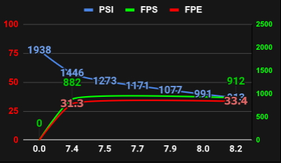

But what happens when we compare this to a GK1 that has all identical features (and a theoretical regulated 25 cc plenum), where we only reduce its barrel length to 8.2"
Say whaaaaaat? The difference in power between the two power plants here is minimal, and its simply the calculus of air molecules chasing the pellet down the bore, where the gk1 is able to use upwards of 90-100% of its barrel length effectively, the 20" barrel uses 45%-50% to transfer energy, where the remainder is primarily reducing pressure for muzzle noise/flip. The above graphs are not 100% actual representations, rather theoretical, for demonstration only.
So what about really long barrels and heavy ammo? Well, I am not claiming to have it all figured out, and the mad men that do have it all figured out, well feel free to chime in! The below is a 36" barrel that would in theory use 35% of its barrel length, however, I have done zero tests to even begin to grasp very long barrel lengths, as I am simply fudging numbers based on theoretical peak projectile velocity and estimated pellet dwell extrapolated from that, so take the actual figures below with a grain of salt, where the above figures are fairly reasonable.
In any case, with all pcps, the moment the valve shuts, the bore experiences a sharp drop in pressure, and the gradient of this pressure is one reason that makes our pcps so delightful to shoot, from minimal muzzle noise, to minimal muzzle flip. I hope this helps paint a picture how projectile velocity greatly effects the 'effective barrel length' in pcps, where the majority of energy transfer occurs sharply in the first 10", and as the projectile outpaces air, energy transfer greatly stagnates.
