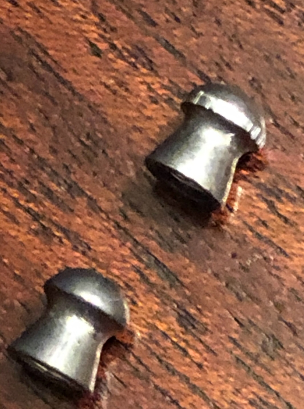

Mine isn't accurate and I beleive it's because the pelket is damaged by the rifling gouges.
That looks like a standard pellet to me. The head is fully engaged, good engraving on the head, the skirt is of course unscathed but its not been fired so no flare yet.
That is not what a pellet that has only been chambered normaly looks like. I get pieces of lead out of the chamber when do this test.
I have to hit the bolt with the palm of my hand, sometimes twice to close it.

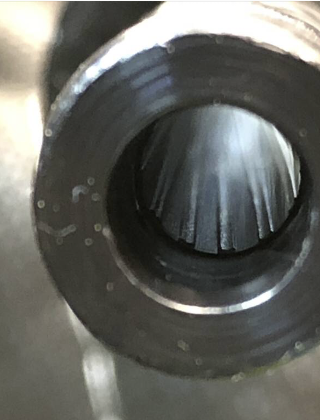

I have a .22 Avenger barrel that is very rough where the rifling begins at the breach. I did polish and recrown and pushed several pellets by hand, the first 2.5 inches of the rifling are rather tight as well. I polished with a bore mop and JB and put a lot of extra effort in the tight spot including using a drill (with mop).
I'm thinking of using the back end of a drill bit, grinding a taper and polishing like a recrown. I'm not to concerned about being tight at the breach but this sharp edge must go.

Your using J-B bore cleaning compound, which is more of a cleaning agent. May I suggest after using J-Bcc you clean your barrel with Ballistol, then use either J-B Bore Bright or Flitz. Both are polishing agents.
Don't stop half way through the process.

That tight spot is you choke.

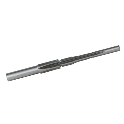

If you're feeling adventurous, you could "re-chamber" it. I've chambered a few blanks in .22 using a tapered #3 pin reamer. Important that you find the diameter on the reamer that you want your, let's say "free bore," to be, maybe .225". grind down anything larger than that on diamond wheel, and insert and ream so that the .225" portion clears the rifling, and the taper will create a nice leade-in sloped into the rifling. I've found that you need to clear at least until the end of the transfer port, because if the pellet is being re-sized/bitten by the rifling, the edge of the TP, will gouge the pellet/ slug. Concentricity is key, best done in a lathe, but again, little adventure by hand or drill press haha. And of course you finish with your polishing to remove any burs or rough cut edges.
Reactions: Painterman
Good advice all around. My motto, (having worked on powder and pellet guns for years), is never rotate anythng in the bore. That's barrels 101. Second, if a rifle has a bad barrel, you need to determine if is slight ie burrs, light roughness, or if it needs replaced. Most barrelss, especially soft airgun barrels, if too rough, just need to be replaced. Not saying you can't improve them some, but bad is bad. IF you determine the fix is polishing, then I advise only using something like flitz or JB, and on a lead slug, but it can be done with tight patches if you get the hang of it.. I once had a 7mm0-08 Tikka, that just wouldn't group for sour apples. It would do 2-3" at 100 yards all day long. I decided to either fix or ruin it, so I started with a very tight felt slug and JB. After every 100 or so pulls thru, I would clean it and shoot it. After a while, probably something like 1000 passes, it would shoot 1" groups, and I stopped. I have also tried it on other guns and had the reverse effect, they shot worse, that's when it's time for a new barrel.
